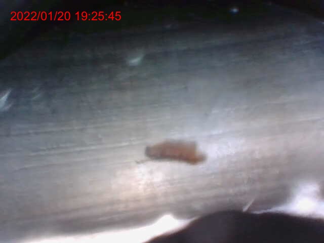

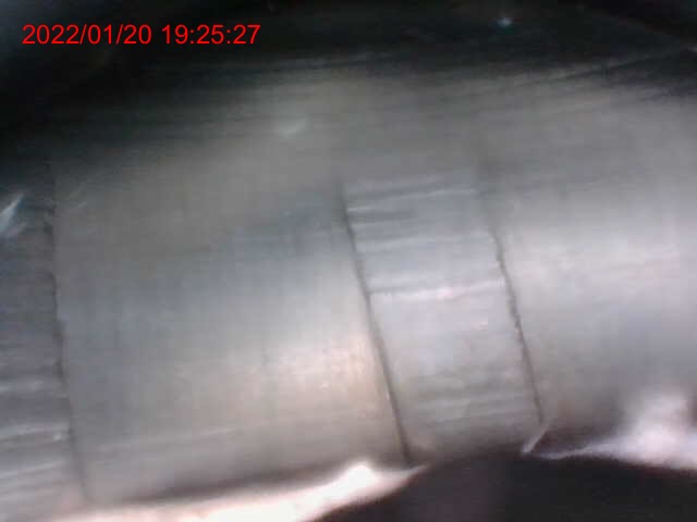

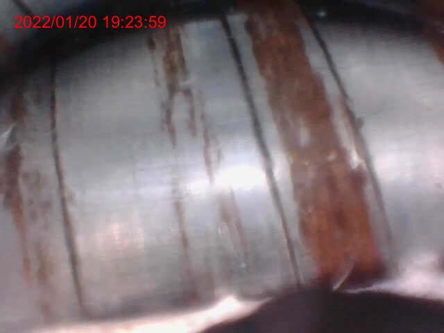

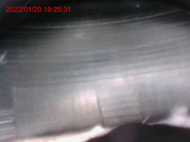

Has anyone ever seen this in a new AR chrome lined barrel?
David4570
Feb 15, 2017
87
16
I may be over reacting to these bore scope images but has anyone ever seen anything like this in a new AR chrome lined barrel? The streaks can be seen in many places mid-bore. The picture of the “chip” was taken in the chamber.
I‘ve heard bore scopes can give us undue concern about the inside of our barrels but this barrel was fairly expensive and brought brand new through a respectable company. The images were taken the night of delivery. After my initial look-see I pushed an oiled patch down the tube to see if it was some kind of dirt/grime/grease. A little dark carbon like residue came out on the patch but that didn’t seem to remove any of the streaks. I’ll try copper remover after I get some feedback and discuss this with the selle.
Anyone ever seen this? Anyone know what these streaks are?
(Please don’t just respond - No problem, just shoot the shit out of it unless you’ve seen this in a new barrel and can tell me what these marks are)
....I would recommend you take pics & vids of the barrel BEFORE doing anything to clean or brush out the barrel. Run a bore & chamber brush thru it a few times then re-inspect, again taking pics & vids. It's a typical procedure to clean a new barrel before using, especially if it was test-fired by the manufacturer, so if it doesn't clear up after that expected "pre-use cleaning" contact the vender and discuss warranty options....return, replace or refund. Don't assemble it and fire rounds down it unless the vendor advises (in writing!) to do so.
...the reddish color makes me think "rust" and if it's a CL barrel, then the chroming process may have been deficient.....
While I certainly wouldn’t be happy if that was my barrel…you just never know. It could fucking hammer just as well. Won’t know until you try. Barrel manufacturer?
To be clear, I took the barrel out of its sealed plastic bag and scoped it. It looked like the pictures above. I pushed a clean patch with Hoppes oil down the tube and the first patch came out with minimal carbon fouling type residue. The next patch came out clean. The pictures were then taken to documen the appearance of the innards. I have not put the gas block on. Needless to say, no rounds fired by me.

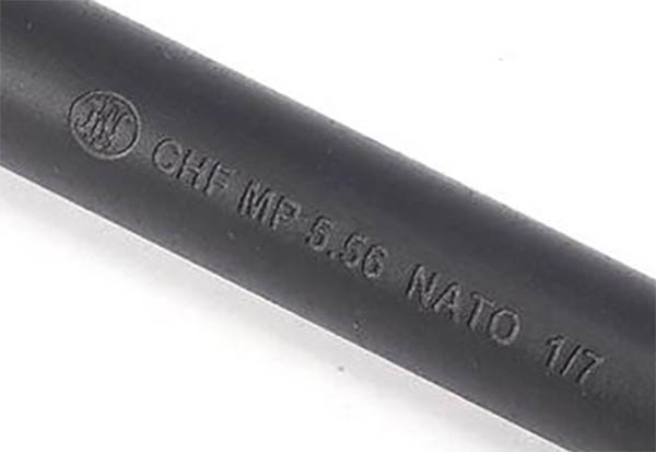

I believe this is a lightweight 14.5” CHF FN barrel because of the “machine gun steel” number used as roll marked on the barrel but I can’t be sure. A well known rifle builder/seller had it on their website. I’ll name them if I reach the conclusion they should be contacted and don’t honor their warranty.
I wanted to see if anyone had solid information on this “condition“ before I contacted them. Thanks for your advice folks.
Two more pictures to show the nicer areas of the chrome lining. The streaks appear on maybe 25% of the lands and grooves more toward the middle of the barrel.

That looks like copper fouling, clean it with a copper remover.

That barrel looks like ass. I believe the reddish stuff is rust. Even the "nicer" areas have significant tooling marks. This probably isn't a high-dollar precision barrel, but still...

Copper oxidizes and can turn dark. If the patches with copper solvent turn blue/green it's copper. If the patches come out reddish it's rust.

not a BA barrel and agree that looks like fouling but you said you got it from a sealed bag?
what brand barrel as you said CHF?

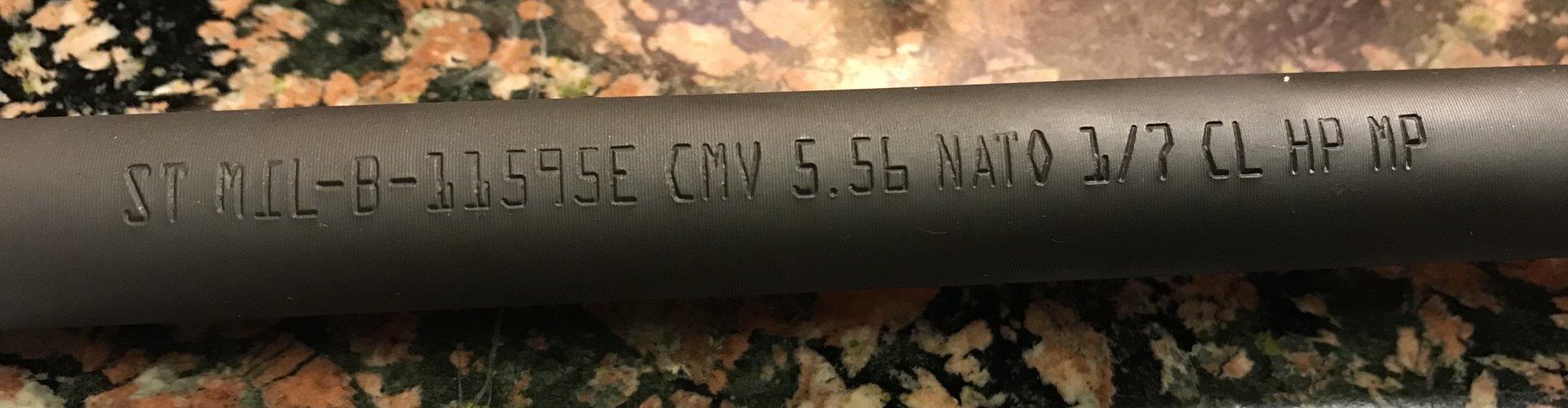

These are the roll marks on the barrel. I haven’t heard back from the seller yet. I think it’s a good idea to have them suggest a solution which I anticipate will include a good cleaning with some Patch Out and a little Accelerator. I have to say I’m impressed by the level of experience and barrel knowledge in the Hide. Thanks for all of your suggestions.

Yes, it’s directly from Spikes. I didn’t realize the ST was Spike Tactical. I think you’re right about Spikes getting them from FN.
I’d sure appreciate Spikes telling me to clean it out with a good copper remover and see if that resolves any doubt about the chrome finish.

That is rust in the barrel. Sometime during the chrome plating process, there are places that the chrome is thin in spots or sometimes does not adhere well. Chrome barrels can still rust, as you have seen.

That’s not an FN, and I do not see a CHF or HF stamp. There are a lot of people stating “machine gun” steel to give people a false impression of the barrel manufacturer without lying. I hope that you didn’t pay much for it.
I stand corrected. $320, which may be too much. I guess I got it confused with the Spikes 14.5” optimum profile barrel which is advertised as CHF
