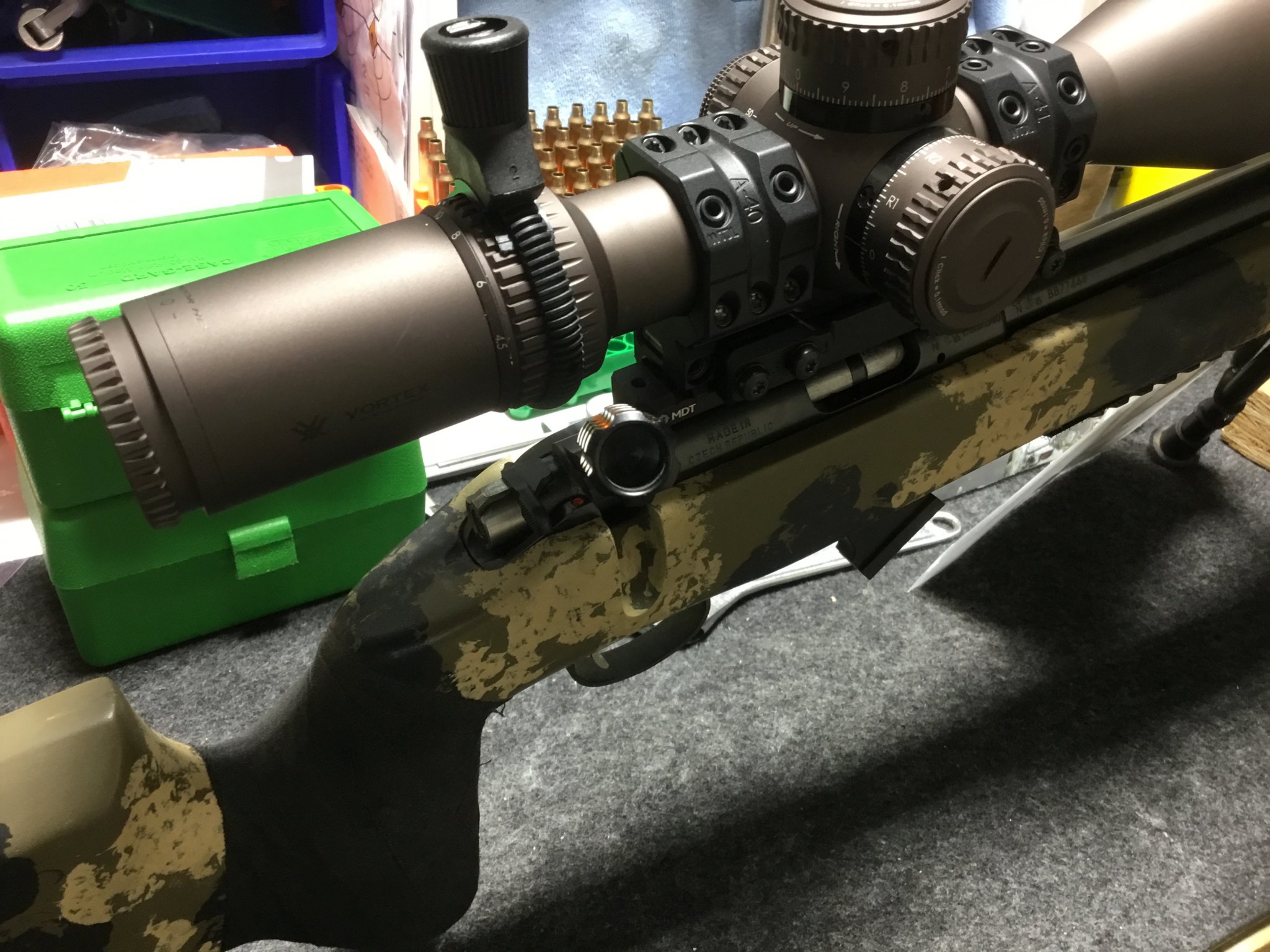

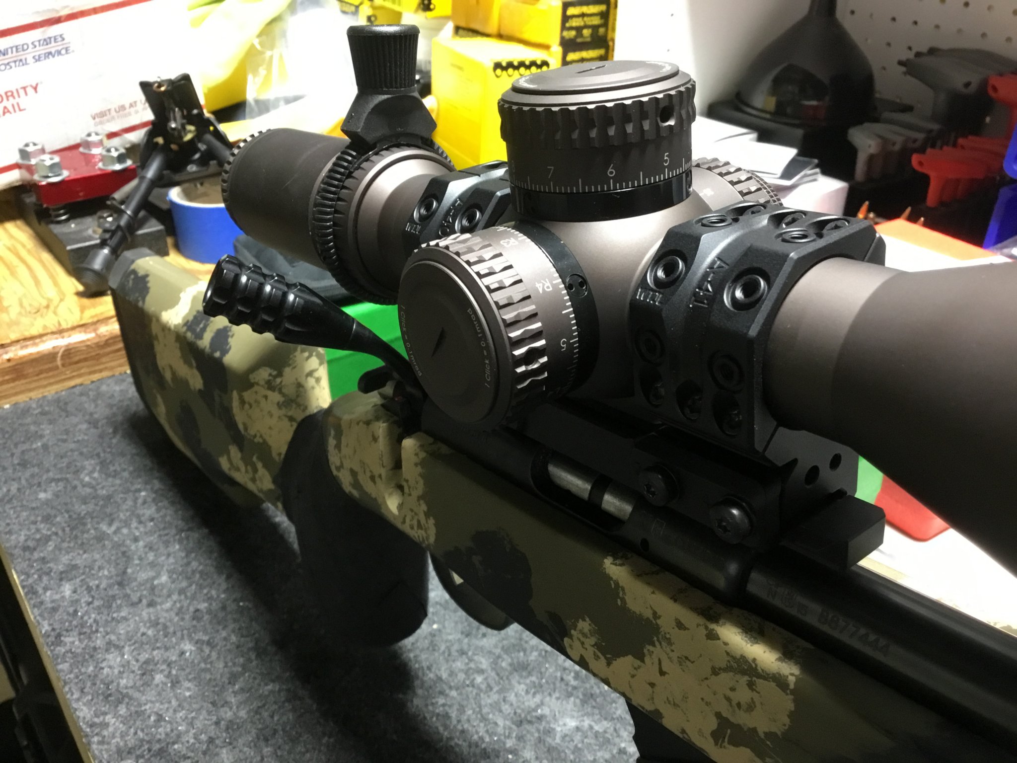

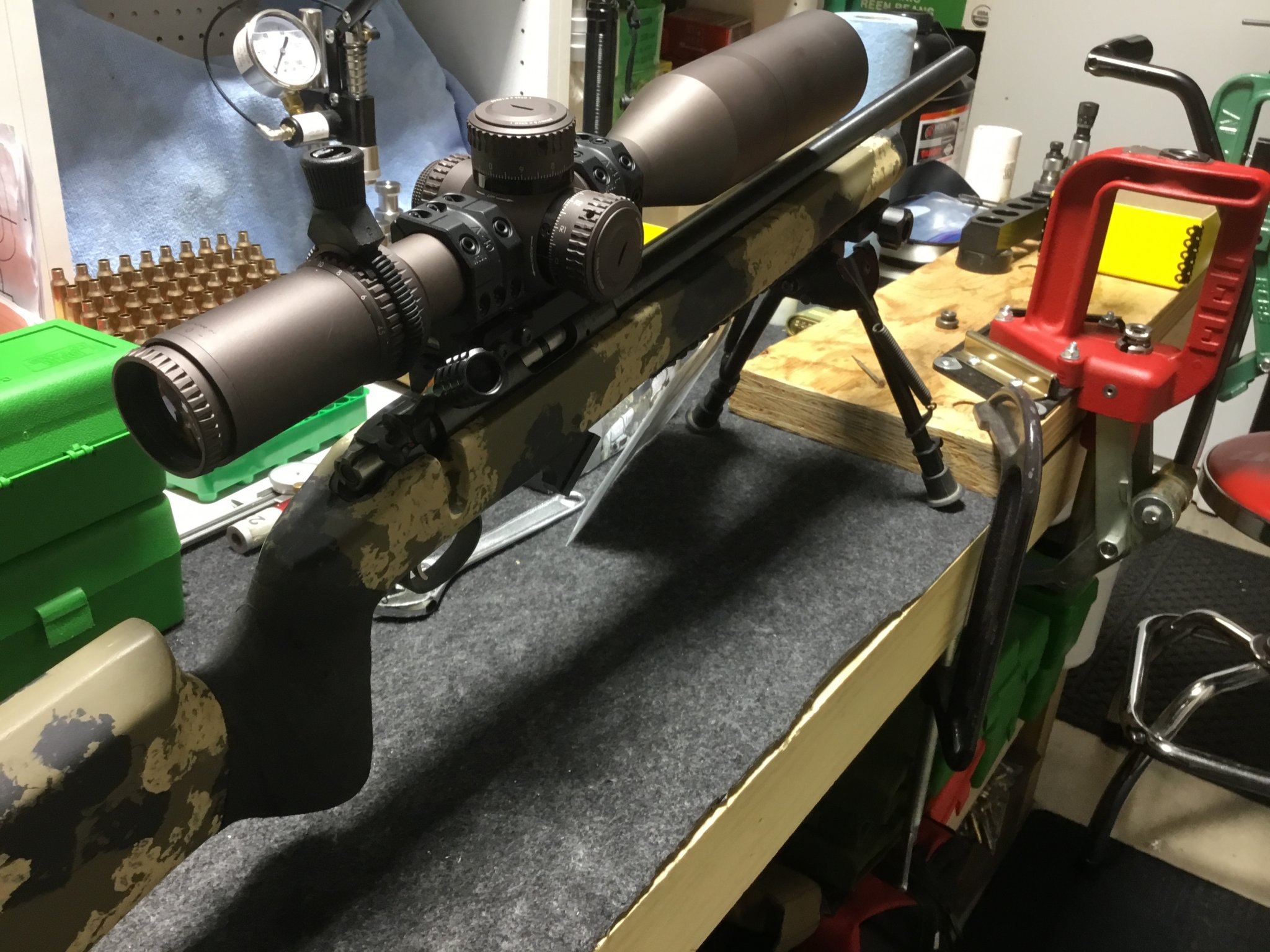

I just changed my rail to mdt, here pics of my current setup.
