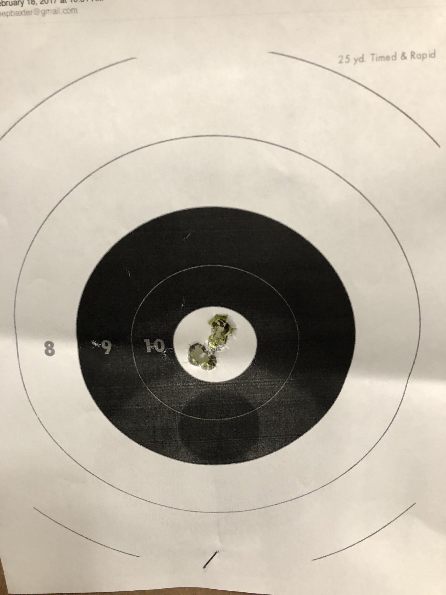

I’m not a guy to weigh bullets, yet... I tried six rounds of 42.5 of Varget and 43.0 of Varget at 2.88 COAL. This group I posted was the 43.0 set, the 42.5 didn’t group as well. Once Redding sends me my new seating die part, I’ll load up more 43.0 and some 43.5 and run the chrono.

Not taking a shot at ya, but does 2/10 of a grain really make any difference on a 195 grain projectile when it comes to shooting it. Serious question? That's a .001% deviation in weight.
