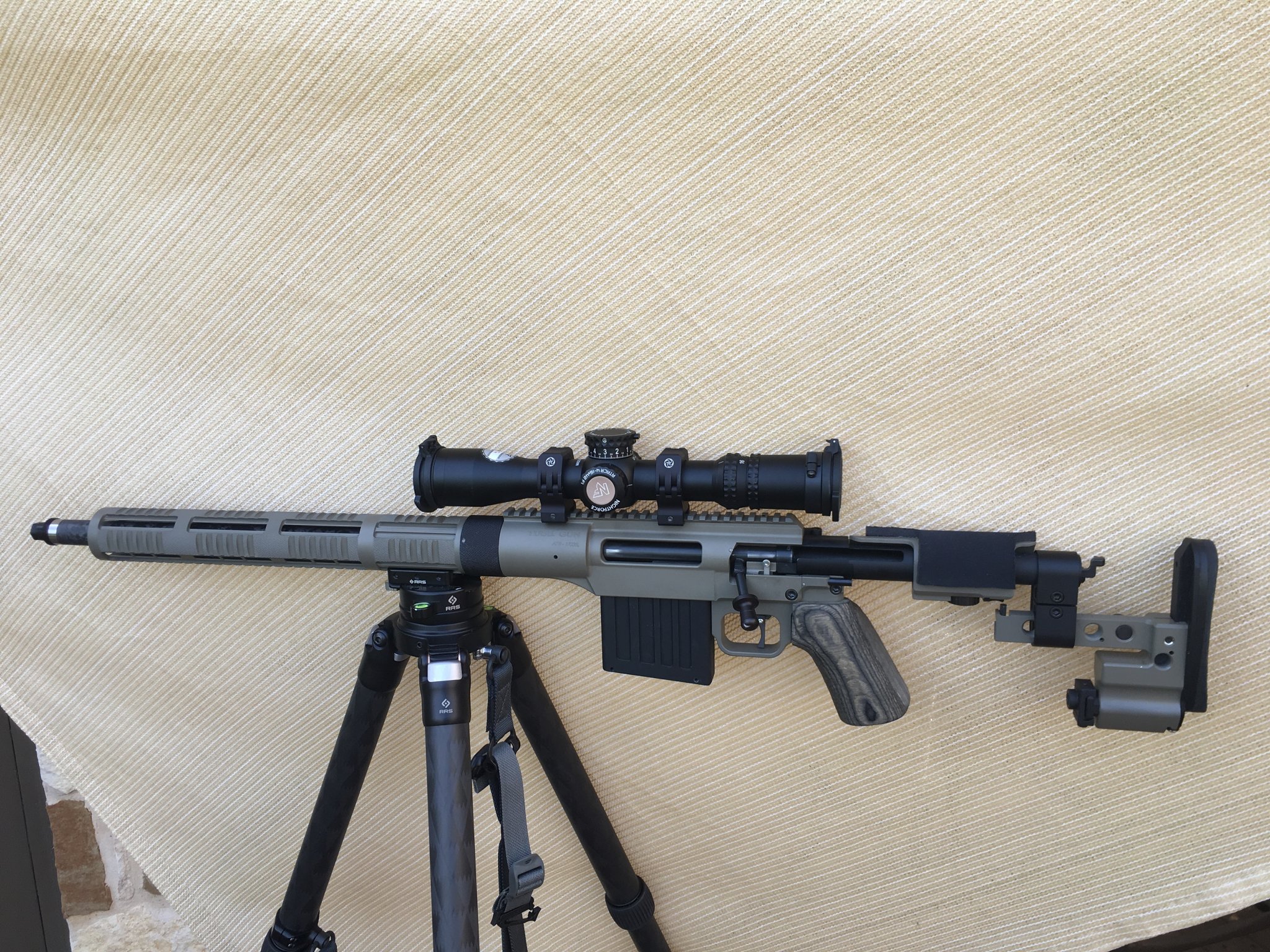

I finally installed the 6.5x47L barrel last week and loaded up a few test rds. and used some from a previous rifle that worked well. Using H4350 (40.1gr to 41.8gr.)with my 142gr. I also tried a few using Varget 37.0 to 37.7gr. The 37.5gr was literally just one small impact mark on the steel plate at 678yds.
The rifle just seems to get better and better the more I shoot it. And the fact that you can change the barrel to another caliber is just awesome. I am going to load up some 285gr ELD-X's and some Warner Flatlines and shoot at 1500,1760 and try the 2450yd that we have set up. 2450 will be the Flatlines exclusively.

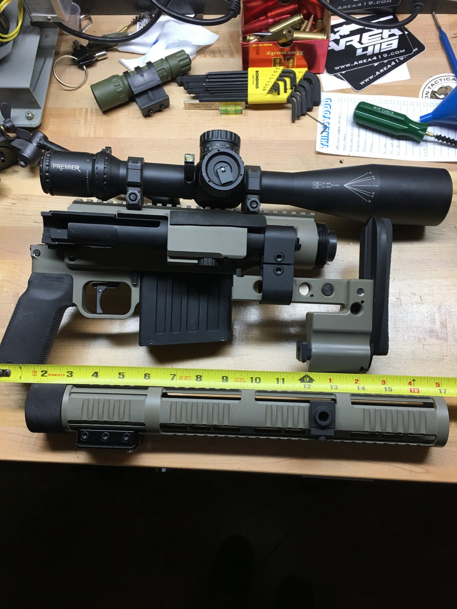

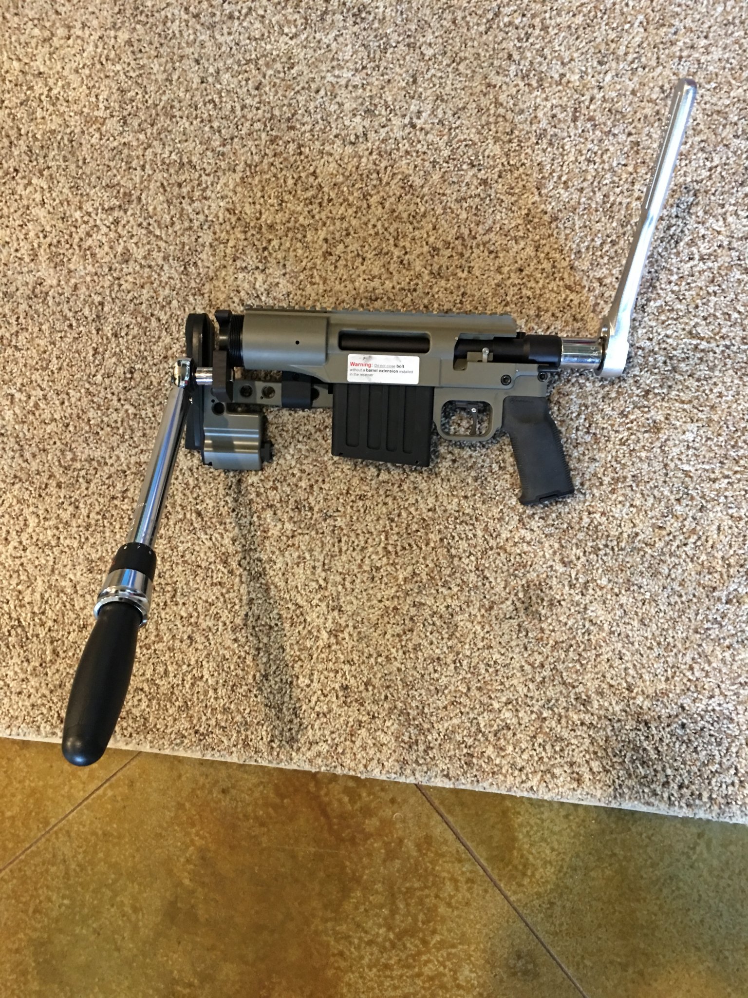

Regarding barrel change, I actually timed my barrel change today starting with removing hunting scope off to ending with putting match scope on. Took about 12 minutes and I had to
grab a couple tools I hadn't laid out. I did it with a vise today, but I have done it without. Torquing to 50 ft-lbs specifically to test being able to change barrels without a vise.

Swapped barrels tonight in 6 minutes without vise, so I'm pretty happy with that. Torquing nut to 50 ft/lbs.
6xc barrel is shooting in the 0.2's
