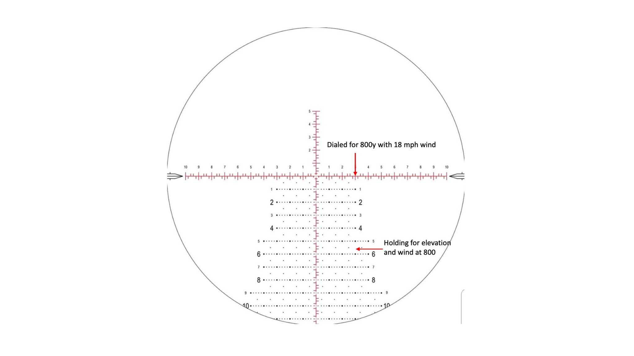

    Even holding for wind, you would still have the horizontal stadia as a precise hold. Here is a graphical representation of what I am saying...
    (I chose 18 mph to be consistent with an earlier post. The magnitude of the wind is immaterial- this is just an example.) Note that dialing for elevation but holding for wind still gives you a precise waterline, even if you are between graduations for wind. But, holding for wind and elevation takes away your reference points for both wind and elevation- reducing your precision. (My 6.5 creedmoor is 5.6 mil to 800 from a 100 yard zero.)
