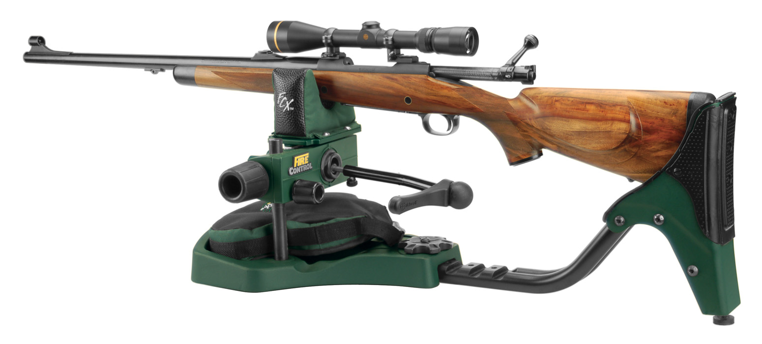

The Lead Sled FCX is a good one to have.
Eliminate your deficiencies when sighting the rifle in, then unscrew the rear section and use it as a sandbag of sorts in front.
