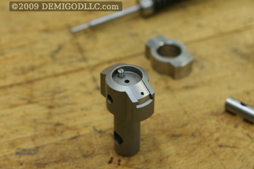

    I got to breifly play with one of these thing the other day when I was at a store in Northern Colorado. I don't think I have heard anything about this action on the hide. Take a look at the bolt, very interesting design...
    Thoughts? Opinions?

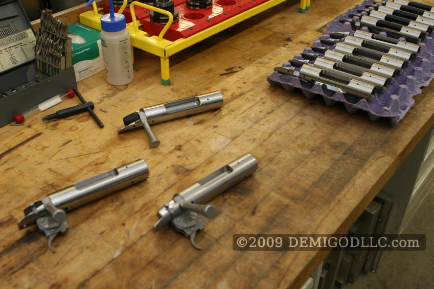

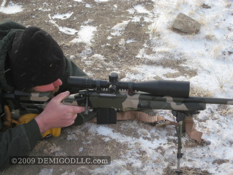

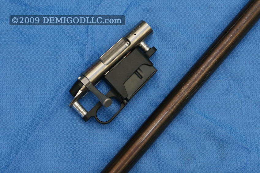

    RayDog and Shane have been shooting a couple .260's based on this action since early this year (2009):
    ............... Larger version of above photo.

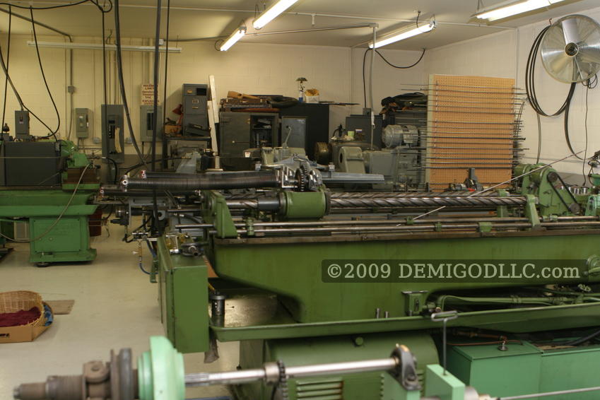

    Their barrels came from here:

    First let me introduce myself. I am AJ Goddard the maker of this action. I see some think an action needs an integral rail and doesn't need a floating bolt head. I happen to disagree on both issues. I could go into my reasoning but it would be rather lengthy. The real issue is how does it perform, and that's where I have to say they are shooting amazingly well.

    Not much to dislike about the design of this action. I think the lug face will stay truer to the bolt raceway by virtue of how minimal the cuts are for the ejection port and magazine opening.
    The floating bolt head is a good way to keep from stacking tolerances and the fact that they are interchangeable is a very big plus.
