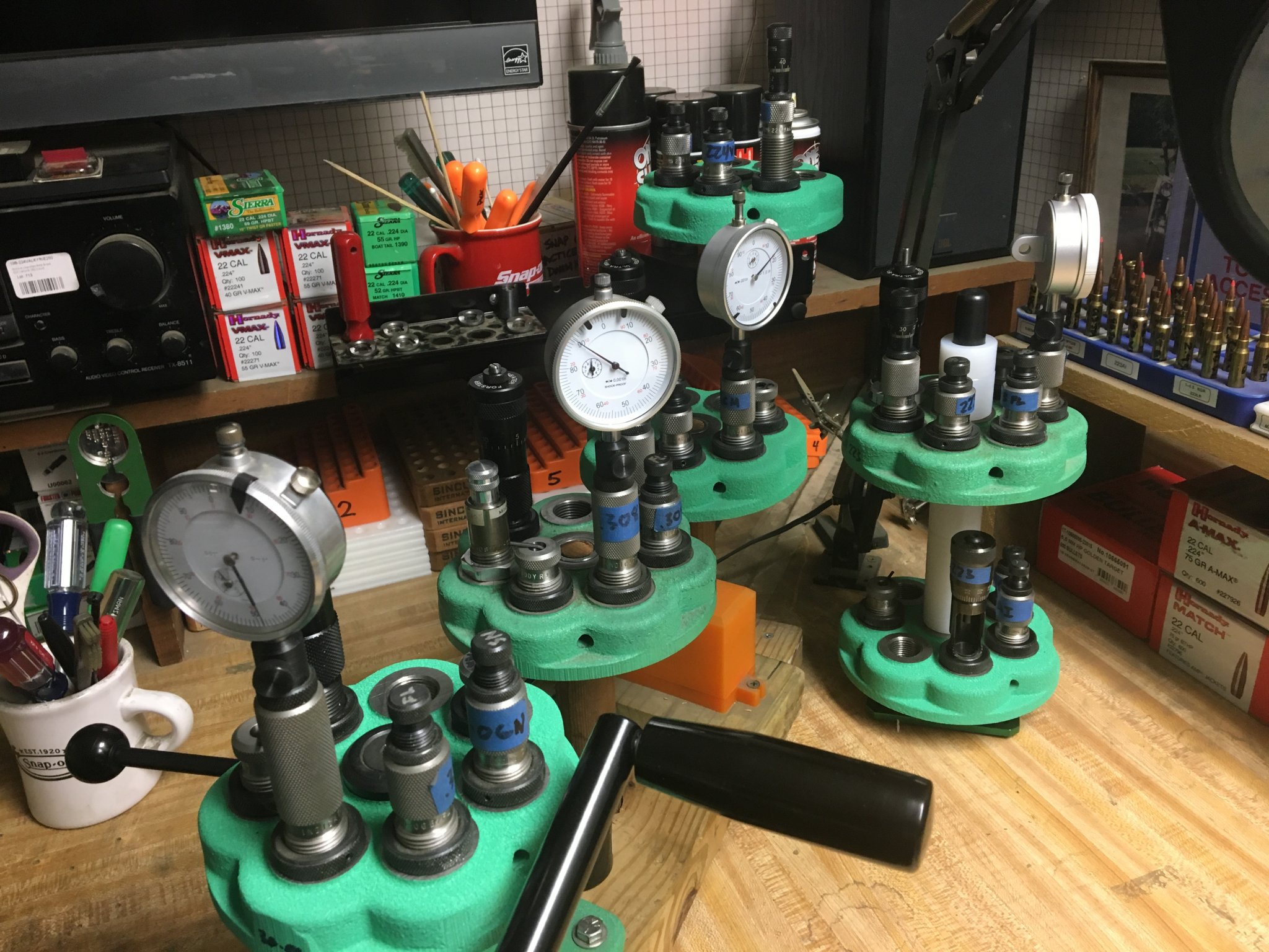

Before I got souvenired a Bonanza CoAx press, I had my instant indicators set up on dedicated turrets for my T7 press. I could resize on one station and swing the turret to check the shoulder bump with the instant indicator.

And you don’t need more than one dial indicator unless you plan to use more than one at a time. I’m a retired mechanic and already had a bunch of dial indicators.
