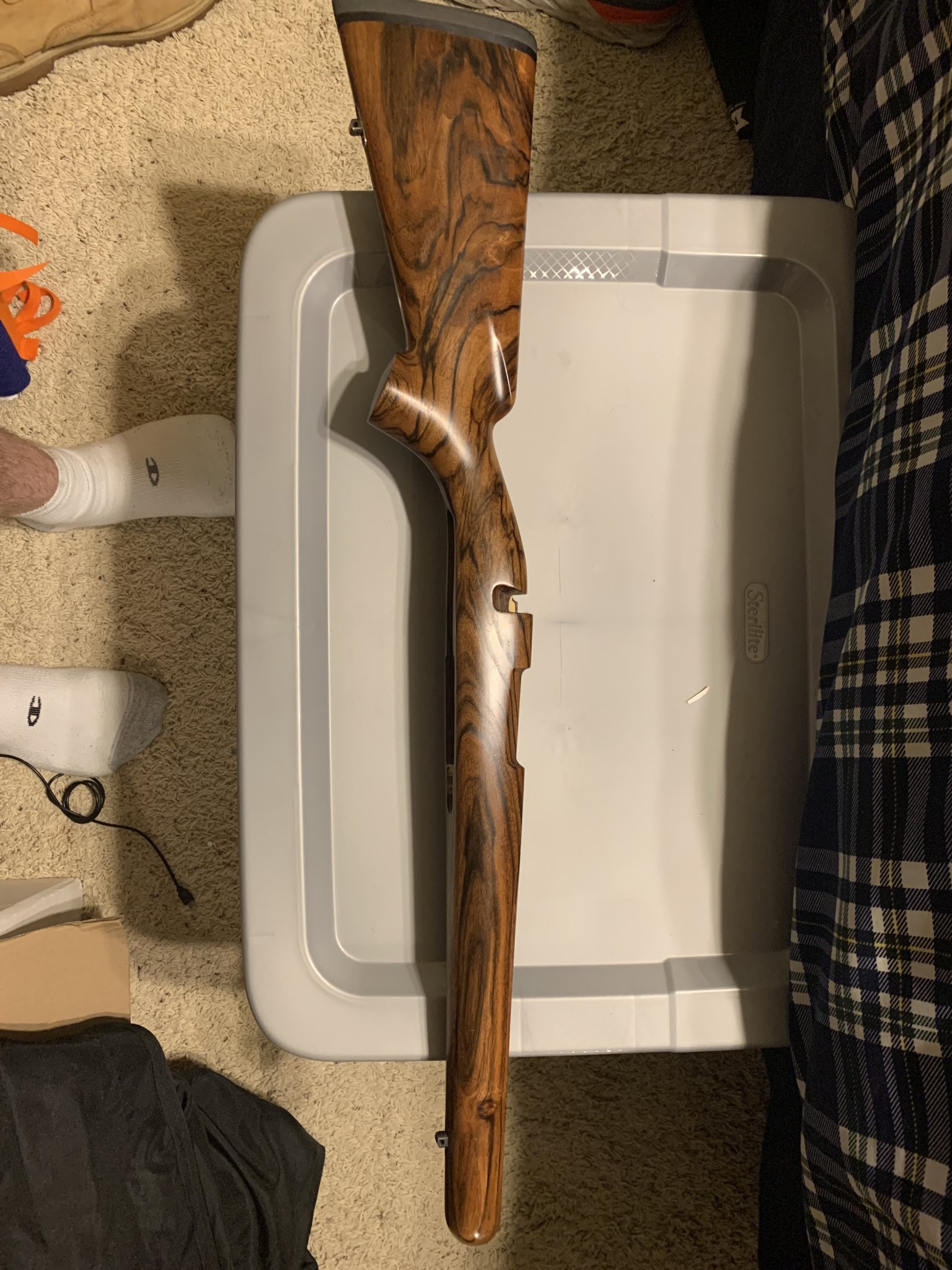

Have a rifle stock, but what can I do with it? I want to build a rifle with it but I'm not sure what would go with it.

you could add a 22lr action and barrel with a custom trigger it sure would look pretty , maybe a 223 make it bolt action go 308win or 30-06 , 6.5 cm or 6mm creed , you got a lot of choices what ever you like could even cut the stock and make the cheek rest adjustable with a adjustable butt plate add piping to it and make it a self contained water fountain fixture , or better yet a pez dispenser that would be cool to see that pics . good luck what ever you decide to do with it . maybe a fire armed themes lamp set ?

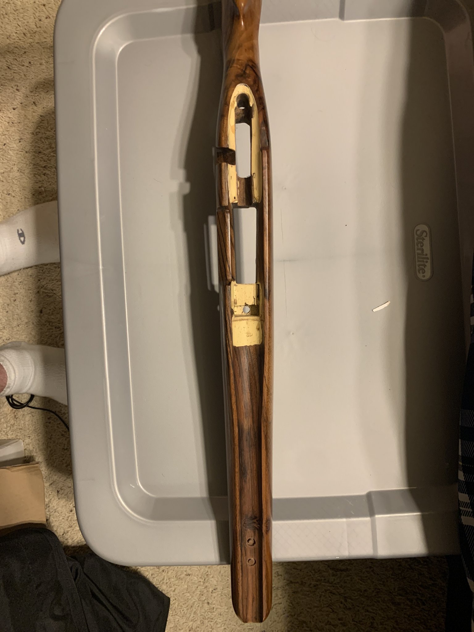

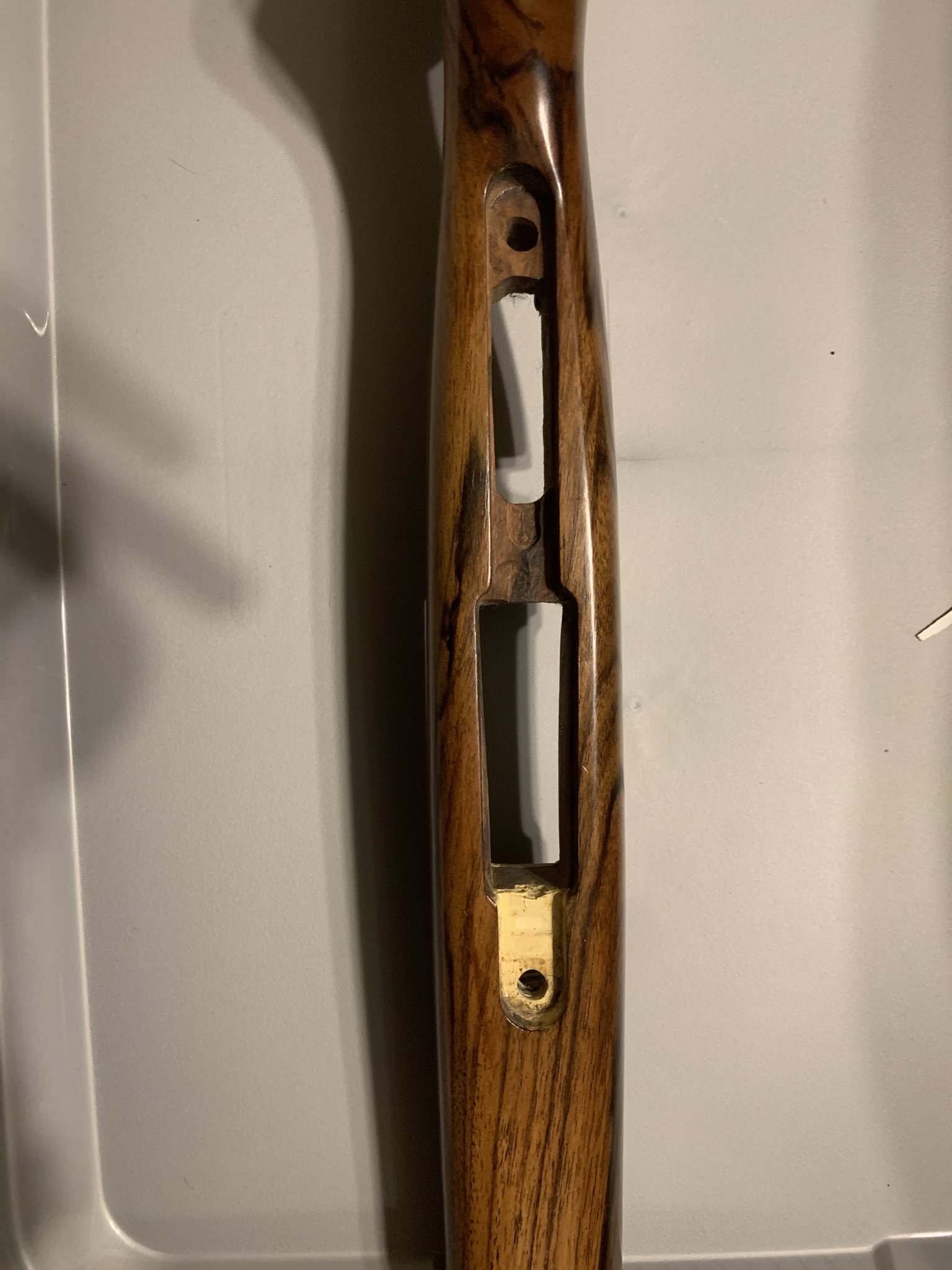

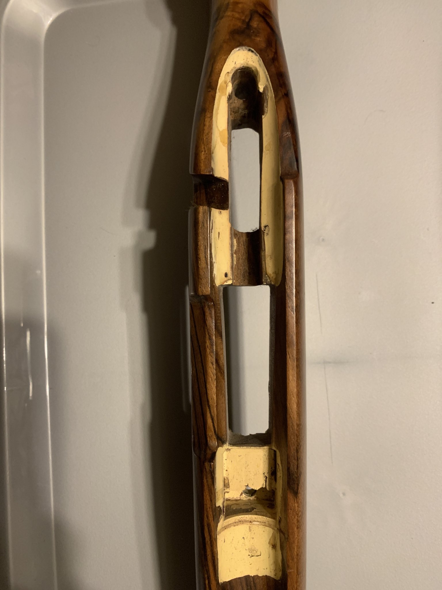

Front action bolt into the lug at 90 degrees, anyone think it’s a howa?
No, it’s a round receiver it looks like, not a howa.
I think it may be a Model 70 or Montana 1999. Short or long 🤔? I can't tell from the picture.
Win 70 action screw is behind the recoil lug, not into it.
Only action screws I know of through the lug are howa and ruger m77 but the ruger goes in at a 30 degree angle instead of straight 90 like the howa.
But the howa has a flat bottom the whole way and the bedding in the stock looks to be radiused to round in the rear.
After looking as close as I can, it looks like a howa inlet.
It's something not worth messing with.
You would have to remove the bedding, then rebed the new action.
