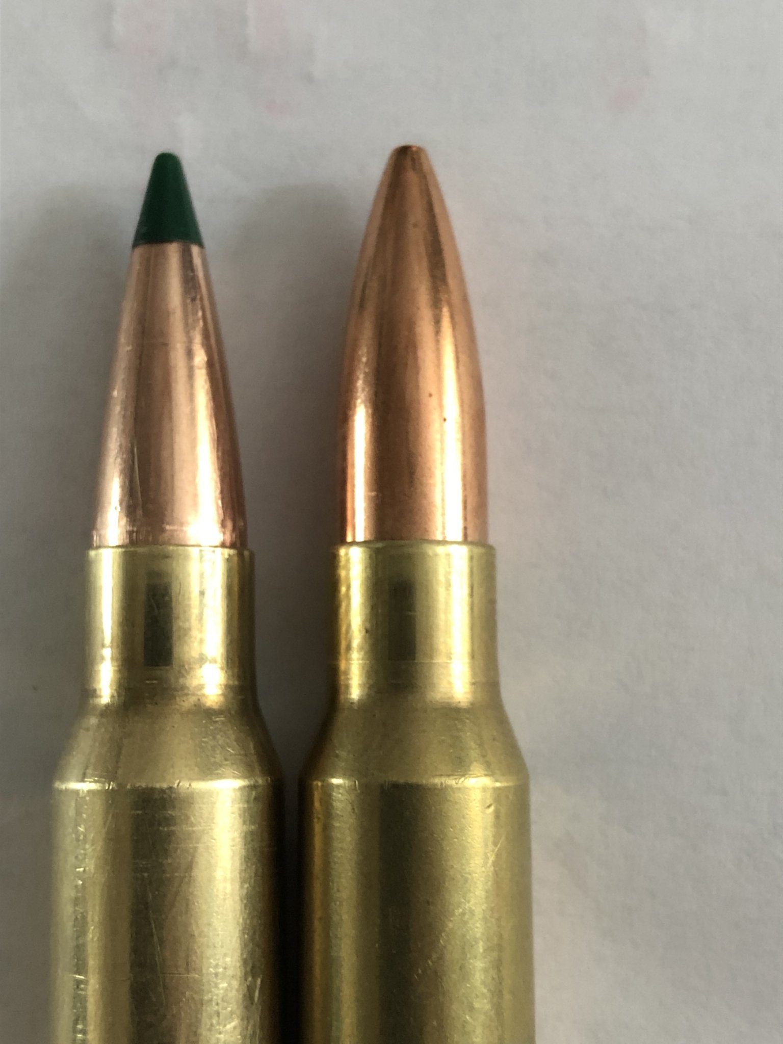

Would like to try Sierra 168 TMK, but the ogive is to steep in comparasion with Scenar. My magazine accept 71,12 but with TMK I have very very long jump.

TMK vs Scenar. 168
