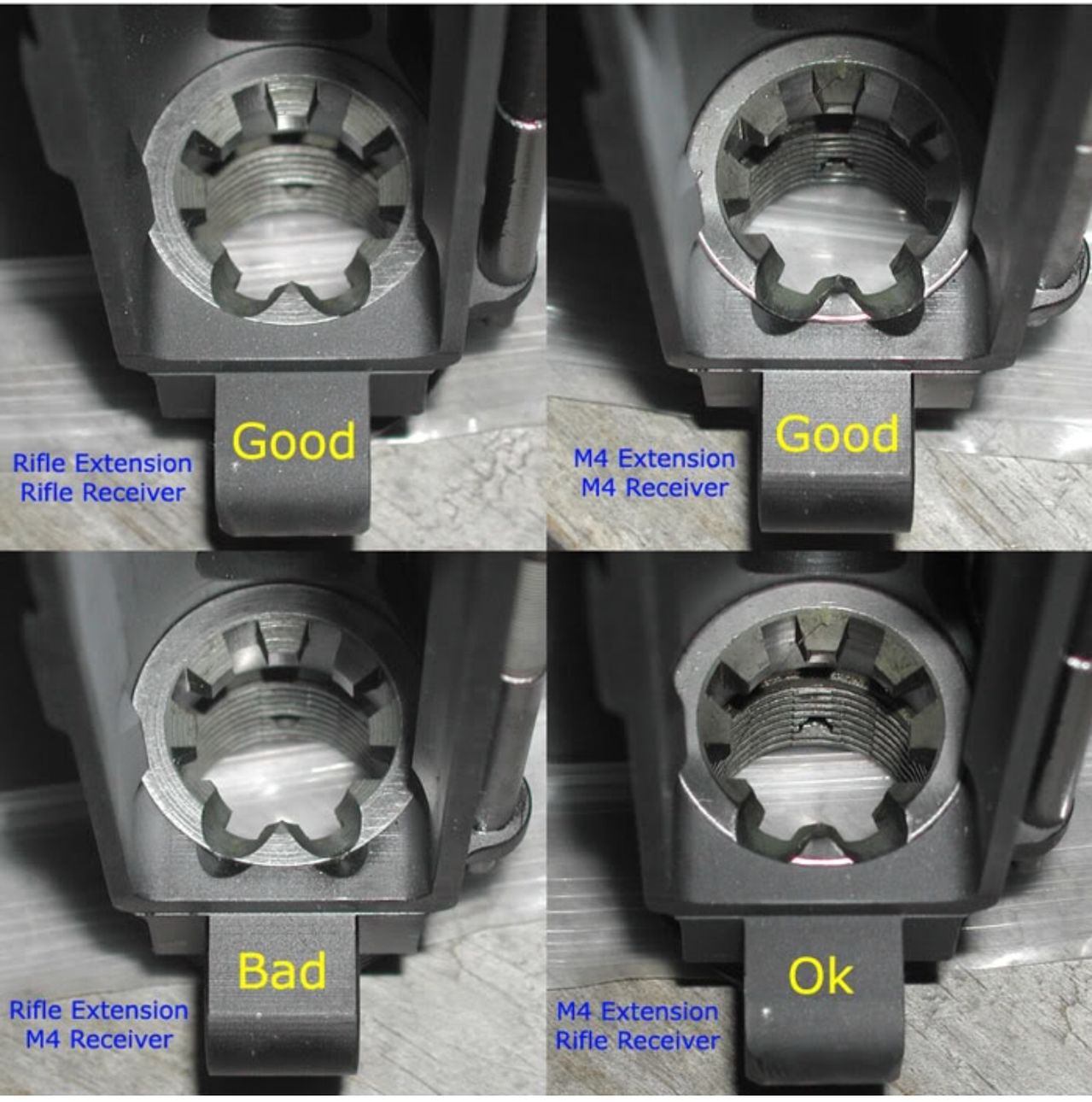

Jamming can be the result of a few things. Magazines can be the culprit but other issues are also possible. Maybe check your feed ramps to see how they align. I've included the chart below for you to compare.
