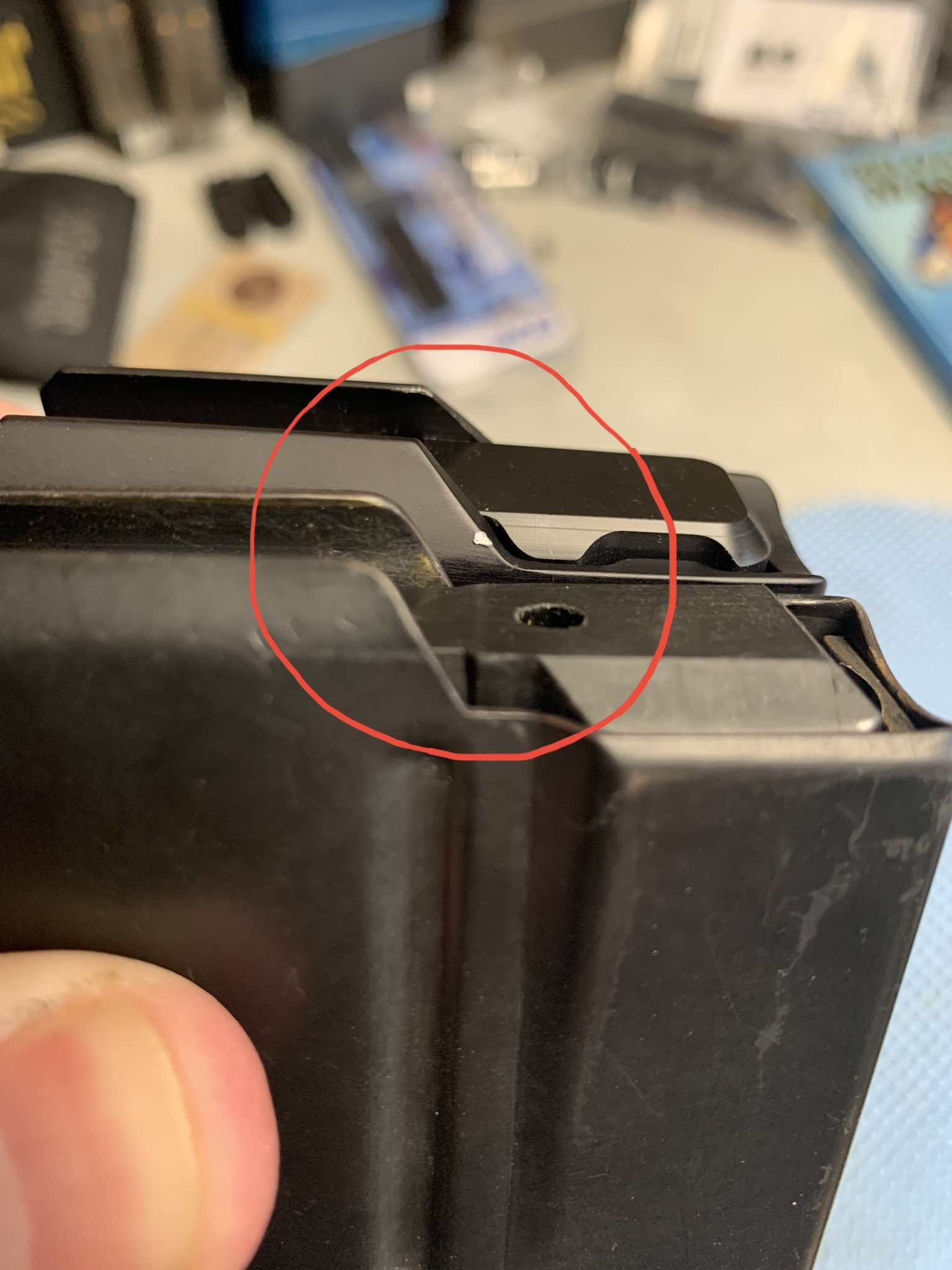

Anyone have an issue with their Hawkins Hunter magazine fit? I’m running a Bighorn TL3 in 6.5CM, AG Alpine stock inletted and pillared for TL3 and Hawkins DBM. I’m running a brand new Hawkins Hunter DBM and have been waiting for some time on my mags to come. Unfortunately, they arrived and will not fit. They will not latch unless given an extra “nudge” and once latched, they will not feed. Upon inspection (see small shiny spots in pic) the breech side of the magazine “lips” are contacting to bottom of my action. The 5-rd AI mag in the pic inserts and feeds flawlessly, but as can be seen in the pic, the lips are shorter and don’t touch the action. Hate to take a file to my new $115 mags, but.......

I don’t believe the inlet is the issue. The AG is very nice. The DBM is quality as all Hawkins products and fits very nice and flush against the pillars as it should. It just seems the magazine is not quite right to work with all custom actions.
