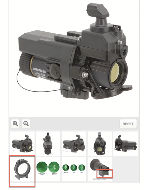

These guys are pretty cool...and a great discount. You can attach it to a PVS14/7 to get NV and thermal utility or get the eyepiece and that makes it into a tiny little thermal monocular the size of your palm! very cool piece of kit. Check them out!
COTI DEAL LINK
1 year warranty and there is a US company, Optics One, in New Hampshire that you can send it to for any future repair after the warranty.
Reactions: deersniper

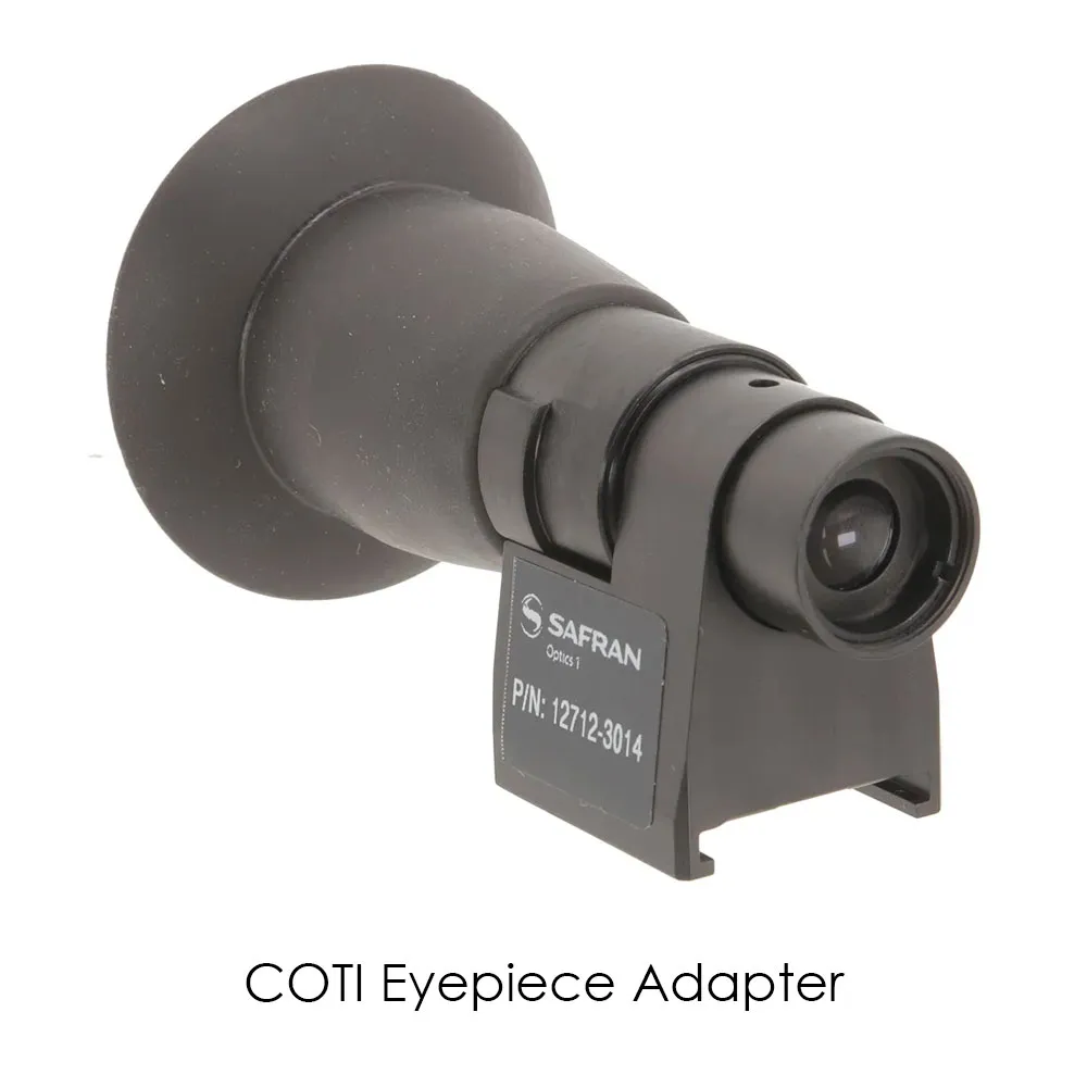

The COTI eyepiece adapter is not included. It is 549$ extra. It is used when you want to use the COTI as a stand alone scanner.

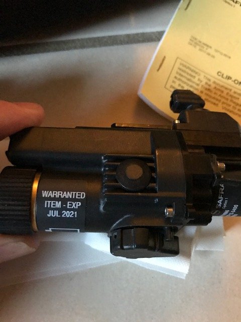

Let me guess, even with the bullshit 1 year warranty, its from the date of manufactur and after the 1 year you'll get a response of 'itll be $500 to tell you whats wrong with it'?

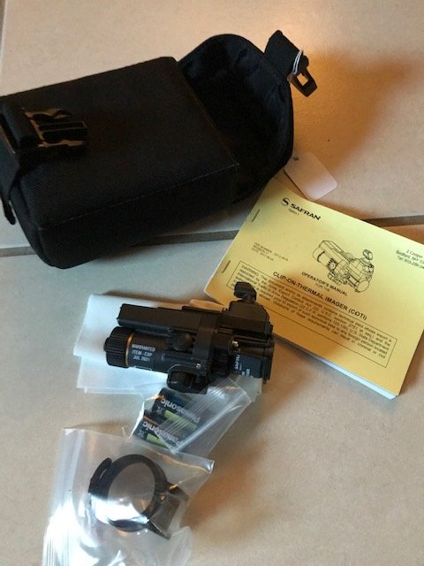

Some pics of what will arrive. They have only ever offered a 1 year warranty but it's reflected on the unit in the pics. Finally a pic of the front showing it's a current production unit for those that thought these were old models.

I know less than nothing about these devices in terms of how they are used, but the europtics ad does show a picatinny like rail mounting ring.
What would that ring be for? Also the monocular eye piece also has a pic mount?
The ring is what you use to mount to the objective of the NODs; the rail-like interface is how the COTI mounts on. Same deal with the eyepiece. Note the rails up top behind the injector, that is where the rail-like interface, uh, interfaces.
Given the monocular eyepiece option, *could* one mount this on a rifle pic rail, or just no, this is a helmet NV based clip on thing.
The monocular eyepiece works very well to turn the COTI into a stand alone thermal, but basically has 0 eye relief.
It's for when you are standing still with the thing jammed up to your eyeball scanning for something.
It would NOT be suitable for walking around with, let alone trying to mount to any weapon by itself.
