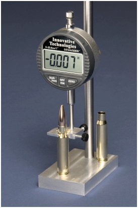

Innovative Technologies (Larry Willis). I use this comparator to check every case after sizing... It works well..... Can't speak for other comparators, however... Set it up high near eye level and very quick to check desired case size dimension....
