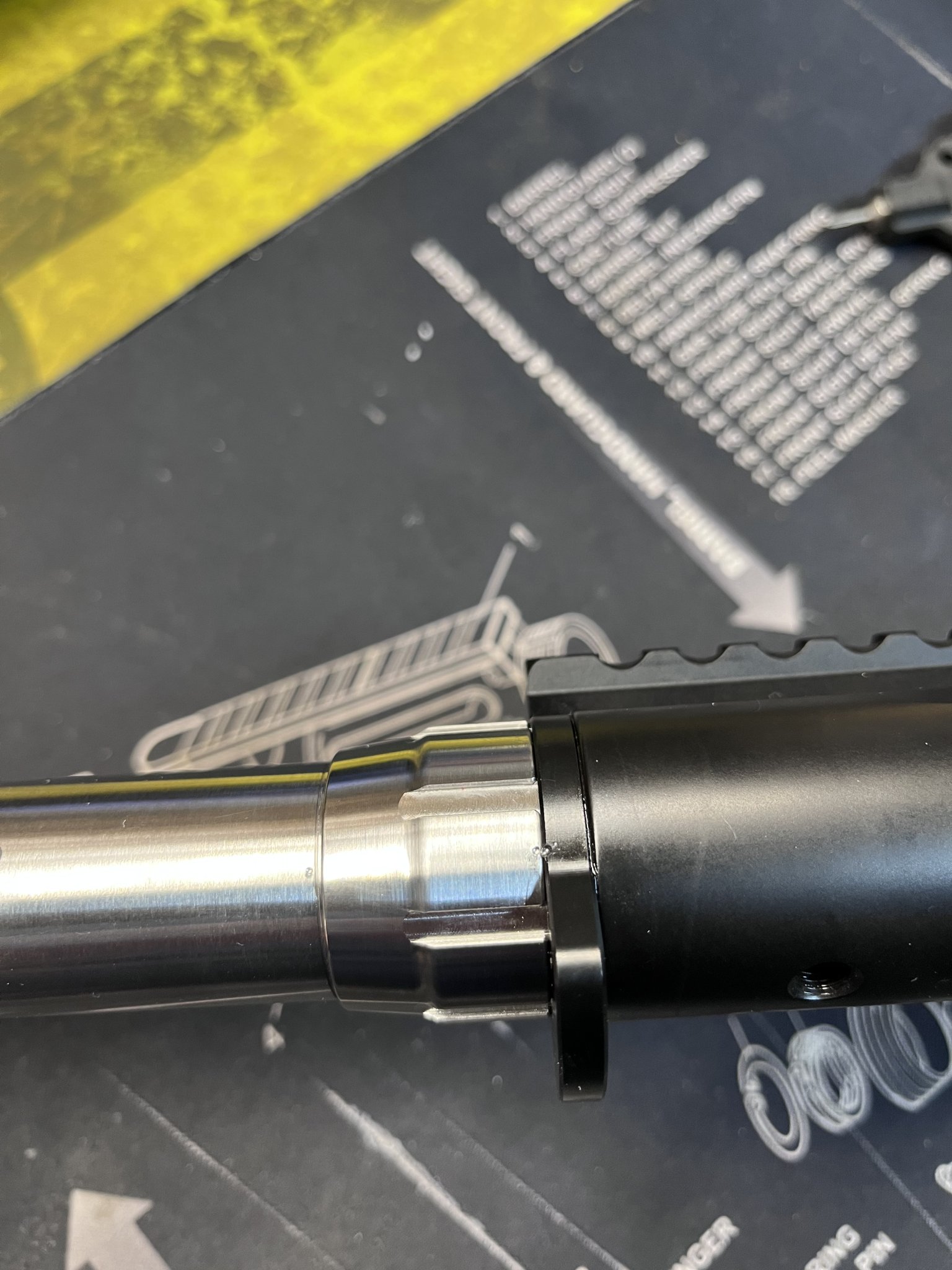

I have a R700 LA in 7 rem mag. I removed the factory barrel and installed a .300 prc remage. If I use the stock recoil lug, I should be able to reinstall the 7 rem mag barrel and have it headspace properly. Right? And if I red loctite the barrel nut to the remage barrel the headspace should be correct if I use the same recoil lug and swap barrels. Right?
Yes- on the shouldered barrel, and as long as the nut doesn't move and you torque them to the same specs then you would be good. It's still never a bad idea to double check after you do it though.
Yes, but always assume you are an idiot and CHECK IT. (nothing personal--better the KNOW than to ASSUME)
I've recently put red loctite on a couple barrel nuts. I put a witness mark on the barrel, the nut and the recoil lug so I know if anything moves. I don't even use a torque wrench to re-install, just tighten back up to my mark.

For the record I only make the witness marks after I have installed the barrel with headspace guages lol.

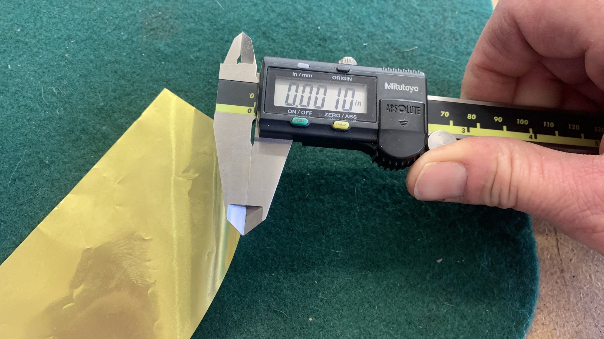

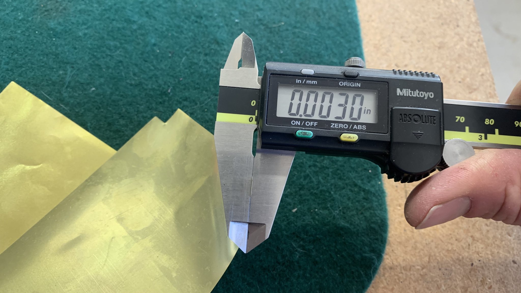

Scotch rape is just an easy adhesive shim to stick to the back of the gauge (or brass case). You can use anything. I use brass shim stock in various thicknesses for this, as its less squishy, and easily cut with scissors.
