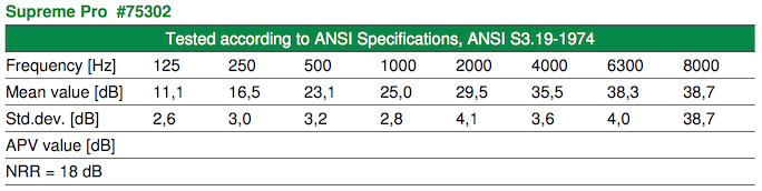

Here (hear) is a thumbnail of the MSA document on NRR for the supreme pro models. Triad Tactical is an Authorized MSA dealer for Sordins in North America. The number of Sordin products that MSA imports into the USA is quite small. There are a lot of models and variations that Sordin makes, but MSA does not import to the USA. If you are seeing products on Amazon, or elsewhere, that you cant find on this page:
http://us.msasafety.com/Hearing-Protection/c/113?isLanding=true
Its most likly what MSA calls a "gray market", unauthorized import. Still a Sordin product, but not covered under warranty in the USA. They tell me this is because they may contain componets (electronic), that are different than used in the US models.
If you have questions about the MSA/Sordin products, give us a call. https://www.triadtactical.com/MISC-Shooting-Gear/

I was on another forum and they were discussing hearing protection.
A chap from California put up a interesting post regarding foam plugs, electronic plugs and earmuffs. Also about doubling up on plugs and muffs.
This is a copy and paste from the forum.
Thanks for the post aam. The information in this post confuses me. The guy seemingly knows what he is talking about, but I believe he says that it's not worth it to double up - that goes against pretty much what everybody else is saying to do. Am I missing something here?
My thoughts are that he says the best thing is a "yellow foamy". So if you take a yellow foamy and slap a pair of muffs on over top of that, it has to add at least some decibel reduction.
I still haven't purchased any muffs. I'm debating whether I should go with the Sordins, $125 Peltor Sporttacs, or the GSP-15s that Norm talks about. I wish that there was clearly a product that is the best, there were no opinions, and this was an easy decision! haha
