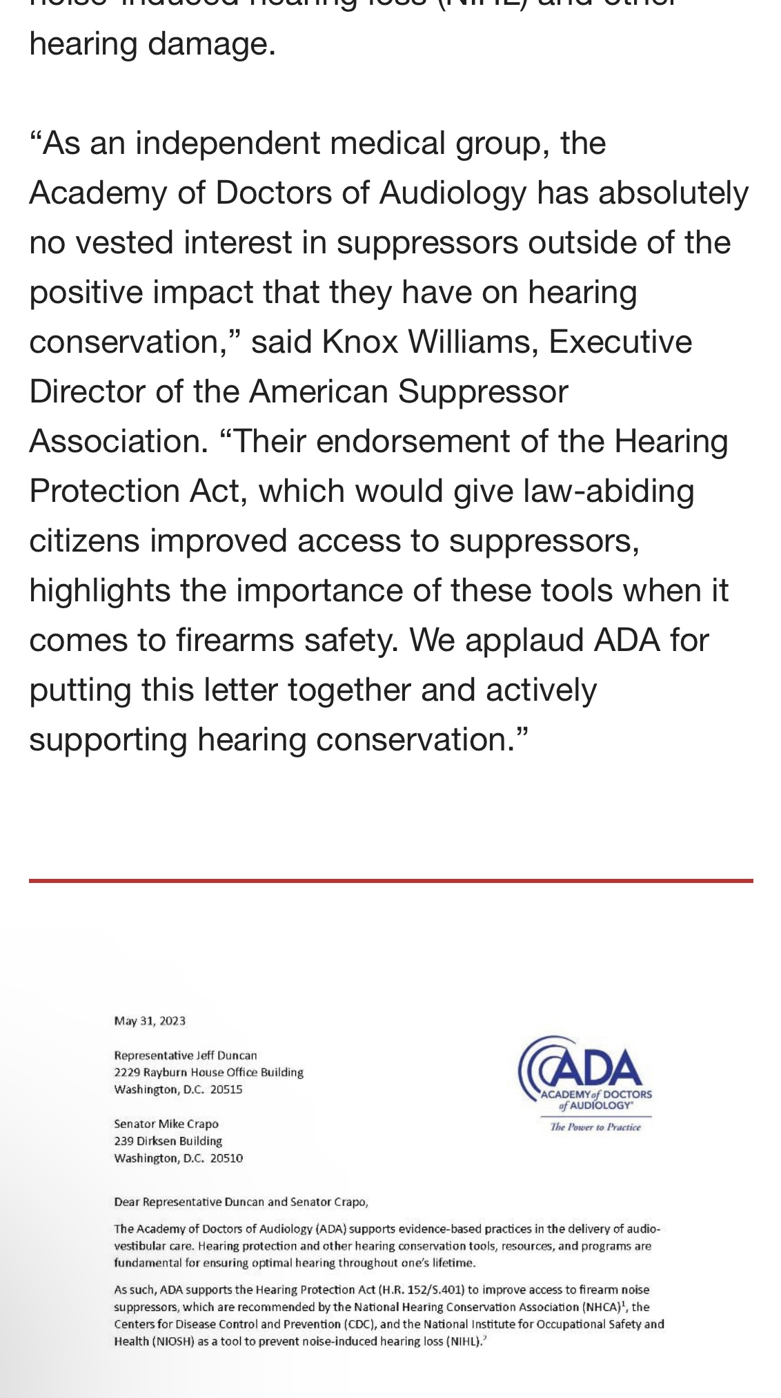

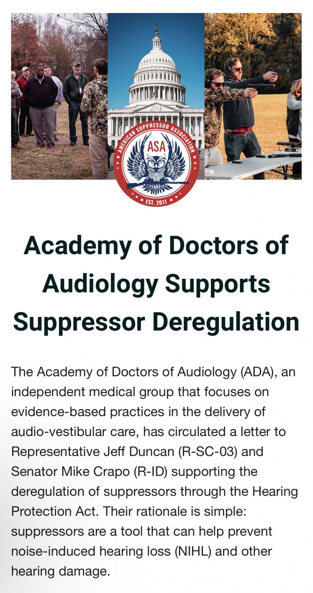

View attachment 8172454View attachment 8172455
This has been the thoughts circulating for 10 years, every time it gets close to vote, false flag mass shooting unfortunately.
