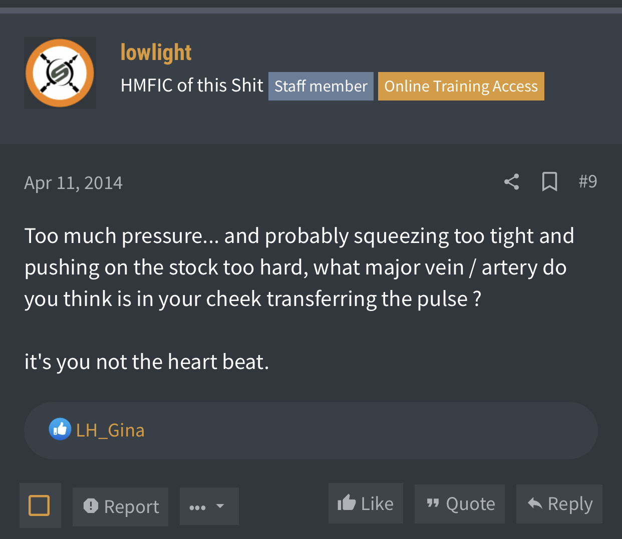

    Too much pressure... and probably squeezing too tight and pushing on the stock too hard, what major vein / artery do you think is in your cheek transferring the pulse ?
    it's you not the heart beat.

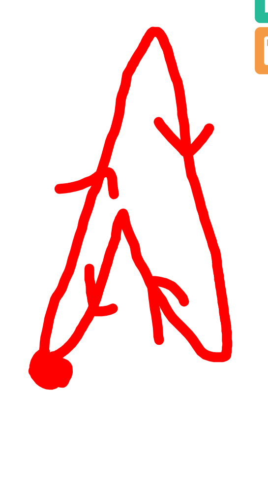

    My reticle makes a motion that looks like an A
    The peak of the A being the peak of my pulse.......that's typically where I like to break my shot, as I find it's more consistent than waiting for the lul and burble of my pulse.

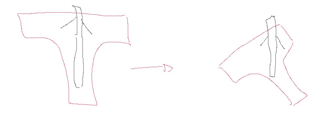

    My bench at the range is cut out on both sides as well. I take the bench and rotate it 180 degrees and then put a chair right behind it and that way I have space for both my elbows and I'm square up right behind the rifle. If I'm lazy to move the bench, then I will rotate the bench counter clockwise like 30 degrees.
    Very bad drawing -
    Very bad drawing -
    Haha... stick to your day job (not drawing). ;) Just kidding... I got the idea.
