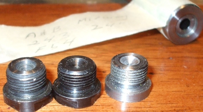

I adjust the BARs by making my own gas regulator. BARgasRegulatorsA&BbarrelForSonia.jpg
But with AR15s without adjustment, I am just screwed.
No amount, from 35kpsi to 80 kpsi will cycle the action with Blue Dot and 35 gr. Not enough gas pressure times time product.
And yet 80 kpsi with a heavy bullet and slow powder will cause the bolt and carrier to hammer the rifle. Too much pressure times time product.
