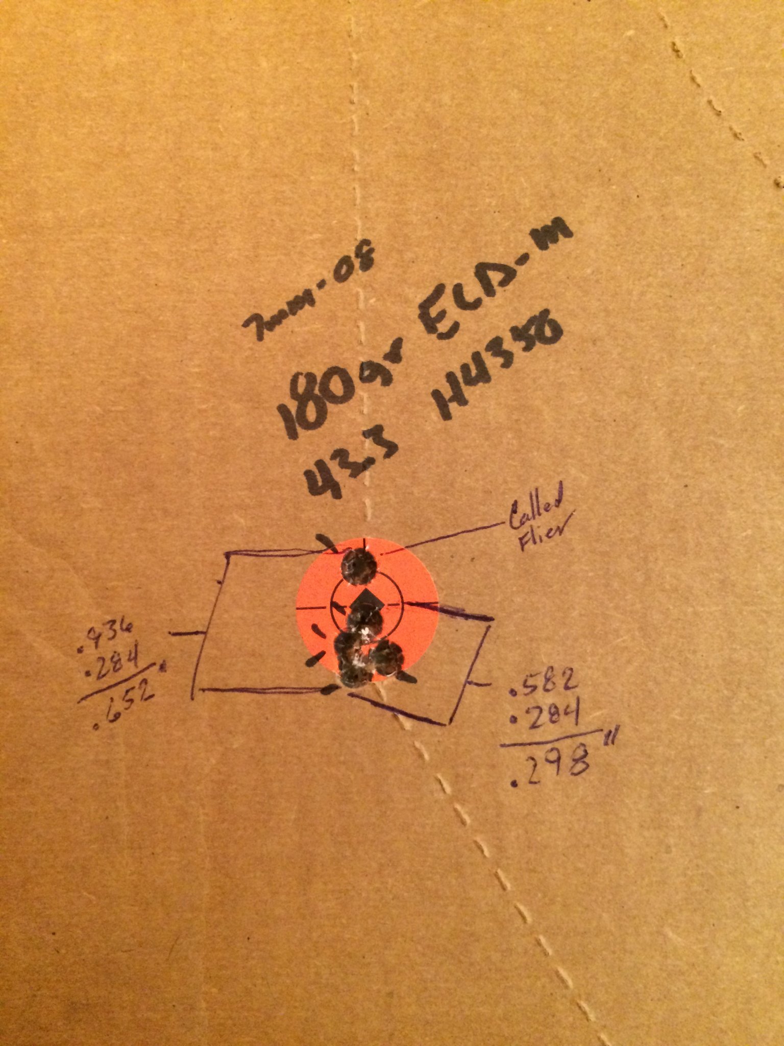

Got out and did some shooting today with a few loads I worked up. I was shooting 180 gr ELD-M bullets over 43.3 gr of H4350 (Hornady book max) in Starline brass with CCI BR2 primers. I averaged 2570 fps with an extreme spread of 17 fps. I had zero pressure signs and it grouped nicely even with the called flier. I am going to bump this load up and try 43.5 and 43.7 gr as well. I would like to get a load in the 2650 range that groups like this.
