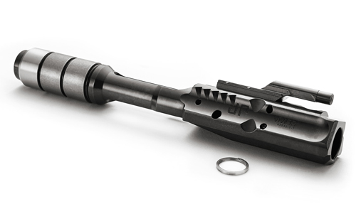

How about a JP-VMOS Heavy BCG? They are about 1.5 oz heavier than a standard BCG correct?

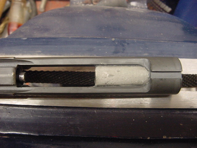

Use the heaviest XH buffer Clint makes, then add a Tubb Carrier Weight System or Tony's carrier weight to the carrier.
There's a fella named Hoot who will make you a 4-ounce lead carrier slug for $10:
If you have money to burn, JP makes a full one-pound bolt carrier group:

I wish Tubbs still made the CWS... super easy way to add up to 4oz to a BCG.
( Just be mindful of the slight additional OAL to the BCG , the CWS adds , for those of you with tight bolt face to bolt catch tolerance's )

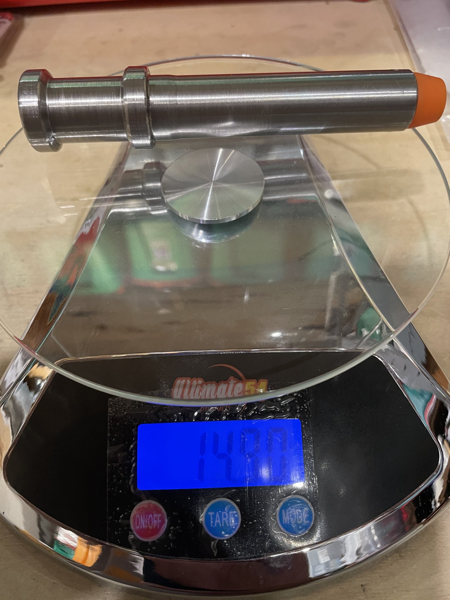

i think the one filled from my AR 15 hit 14.2 oz.. Running 24.0 of N-140 with 75 & 77's functions OK, Need a break in the 100 + * temps. before I feel like going to play
At 14.9 OZ, the brass was only getting thrown about 1' from the upper
It was funny how slow the BCG was moving....just what I wanted
So, I changed the weights around and added some rubber weight spacers between the buffer weights. It's now 12.10 oz
The brass is now thrown about 3' from the upper, with the entire BCG moving at a nice speed
