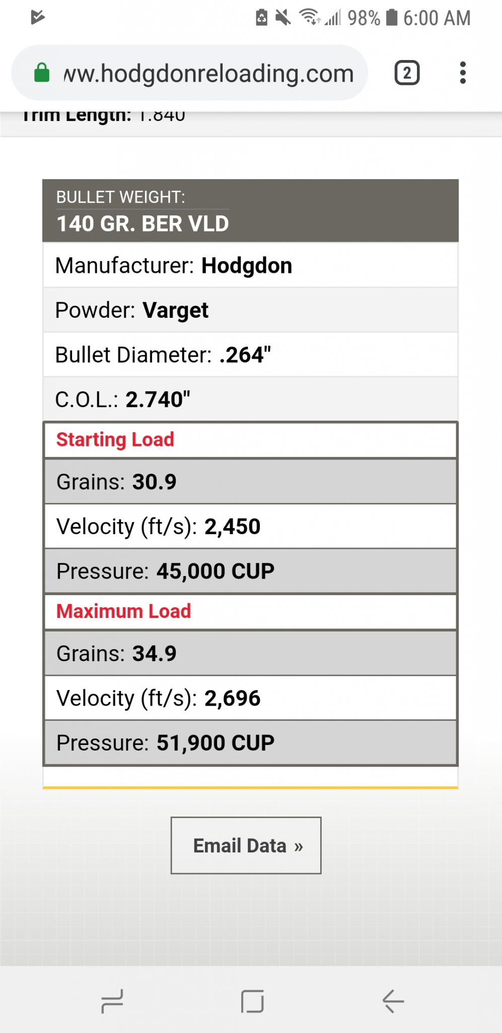

    Varget is kinda fast for 6.5s most folks I know are using 4350
