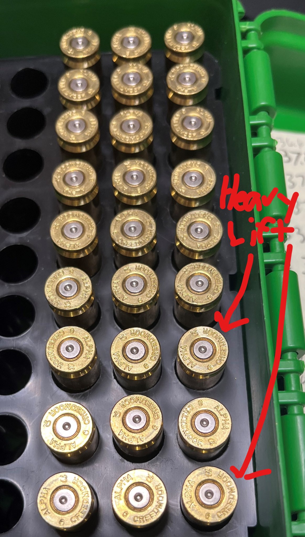

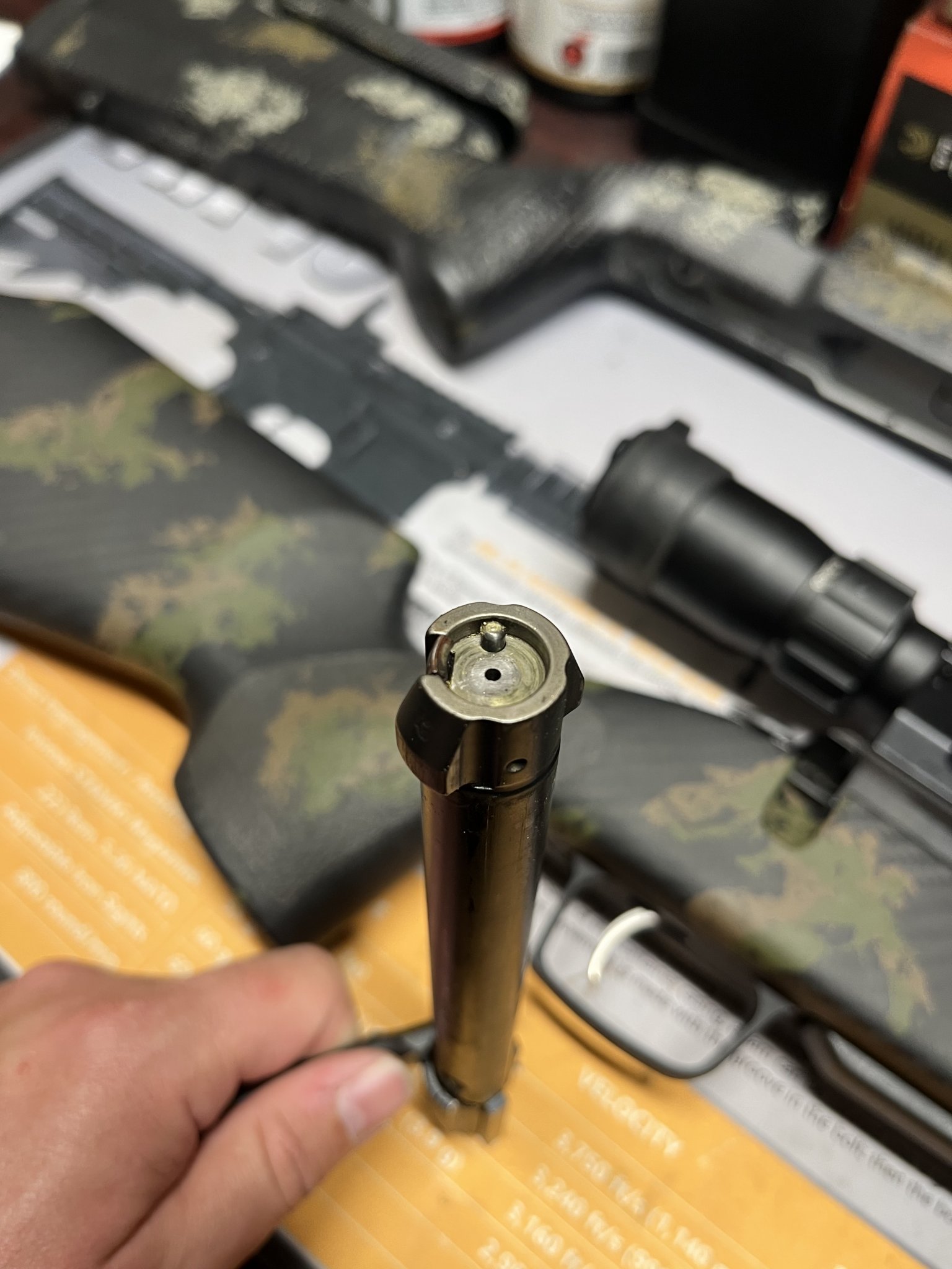

Just incase there is something I am missing I am including pictures of the fired brass and the bolt head. There are slight swipe marks on case that had heavy lift.

I want to talk about the cases. Call the bottom row A, next row up B, third from the bottom C, and so forth. First case on the left is 1, center is 2, right case is 3. I see ejector swipe on A1 and A2, B1, C3, maybe on C2. Ejector swipe is caused by case brass being forced into the ejector hold and this excess brass being sheared off when opening the bolt. Pressure causes the brass to flow - either high pressure or soft brass. If those swipes match the heavy lift, you are getting somewhere. So probably pressure. Is there a (lighter) load where none of the cases swipe? Is it just a few cases that are not strong enough? Do all of the cases swipe at moderate pressure? Lots of ways to go from here:
  • Try the same load with different brass.
  • Pick two cases, one that swiped before and one that didn't, load both to the point where you saw swipe before and see if the pattern repeats.
  • Pick a case that swiped before, load it lighter and see if it swipes.
Thinking about the comment above about Alpha brass. Could be that this whole lot is not as hard as it should be or perhaps it is just some of the cases. Maybe use it for lighter loads? Toss it all?
