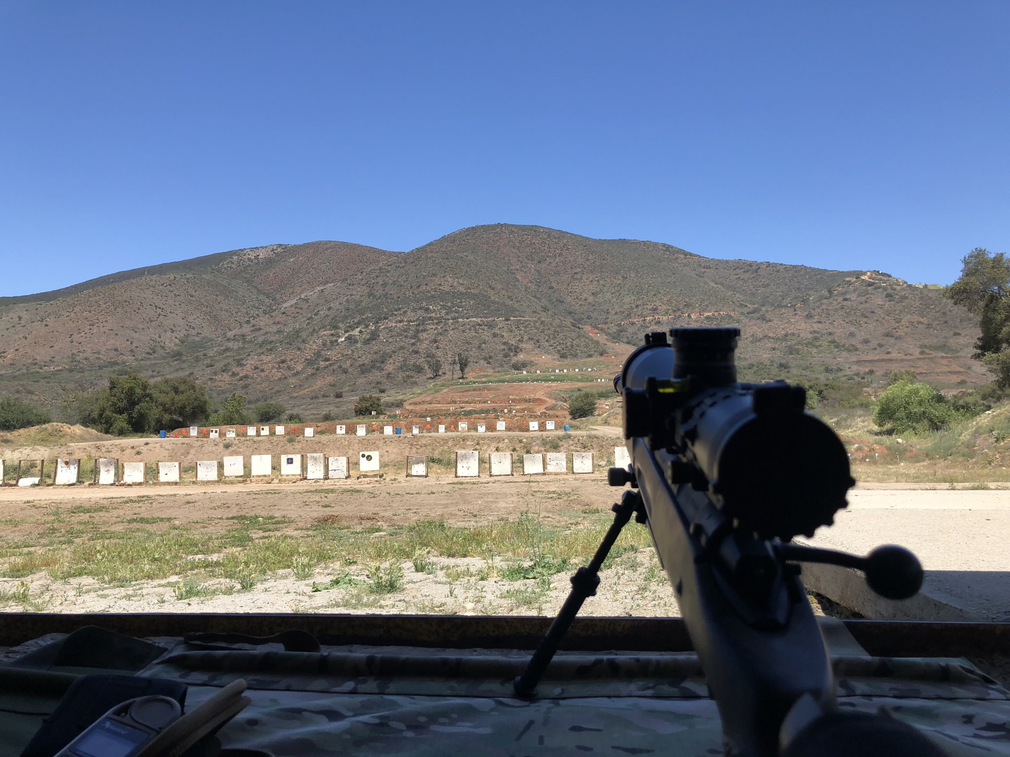

For everyone else, this is the range the OP is talking about for reference
The location of the targets that everyone almost always shoots over are just at the tip of my barrel, going up the right side of the range up to the miners road (cut in the hillside)
On the right side of the road up the hill, there is a small valley and creates a Venturi effect with the much more turbulent air than the center of the range. That along with a south facing hill the temps heat up pretty quickly and now you have rising heat. If you watch the socks on the left side of the range and the right side at the same distance you’ll see 2 different indicated speeds (this is where I theorize the Venturi comes into play)
It’s hard to tell from photos or even from the firing line but taking a trip to the 700 yard line it becomes very apparent that the hill is rolling away from the firing line as you move to the far right targets.
I recommend to everyone who shoots our matches to take an aviation weather class to understand in more detail how air flows over and around hills.
