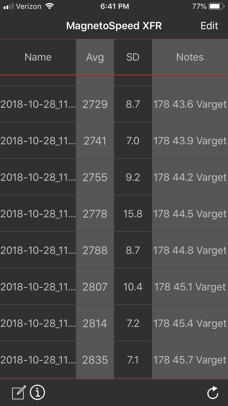

How much crunch are you hearing and feeling? Some crunch is not a bad thing. As people have mentioned use a drop tube. Here is the one I use and it makes a big difference. https://www.midwayusa.com/product/293879/forster-blue-ribbon-powder-funnel-with-long-drop-tube
I use it when loading the 178ELDx, Varget and Lapua Brass. Below is the higher end of my data.
