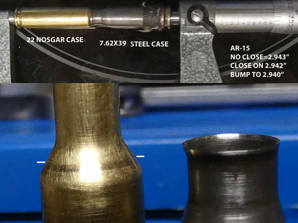

I size to dummies made to fit my chamber length (headspace).
Just this week I've seen several threads about sized cases sticking. Everything from peened necks, bullets sticking, cases blown out oversize, and bumping more and more until stickage is eliminated. How much is too much? How would you know if you didn't know how much is just right?
Bumping more and more just to size down the body just doesn't sound right to me. And, this 'Cam over' thing.

The extraction of an AR/gas round relies on gas force to unlock the bolt, often a little early, allowing the body to expand a little outside the chamber. A No-Gas AR, almost like a bolt gun, leaves the case inside the chamber but does not have the decocking advantage of rotating the bolt with a big ass handle.
0.002" headspace results (in my case) in a case stretched by the 0.002" (datum to base) and a tight extraction. 0.004" and stickage is pretty much eliminated. I have a bore swab on a 90 degree handle I use after every 20 rounds or so to clear some carbon from the neck area that also helps
( I shoot 60+ rounds per match).
Yes, that would tend to equate to a little heavy bolt lift in a bolt gun.
Factory rounds start out with about 0.004"- 0.005" headspace and don't stick.
Regardless of stretch, I size to my chamber plus what I think I need for headspace.
The commonly accepted 0.004" for a gas gun (with gas) stretches cases more than a bolt gun and requires watching for body thining.
I tend to to get loose pockets long before I have to worry about head separation. Some cases might make 5 or 6 reloads where I lose 10% of the pockets that feel loose.
Getting cases that won't chamber is annoying but not knowing the headspace of loaded ammo could be unsafe.
Or, at the very least, wear out cases sooner than expected.

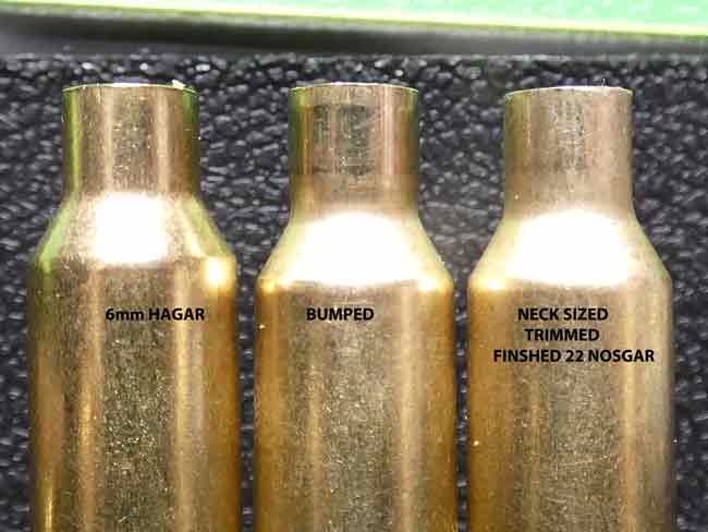

A full length sizing die should be set for bump. If the base isn't sized enough then use a small base die.
Long story short,
KNOW how short your sized cases are.
The No-gas AR I am referring to is a 22 Nosler using Nosler and Dogtown brass.

I bump 0.002" for the wife's gasser. I can live with that due to the low gas setting (set for the load).
I separate the upper and hold the case under the extractor and ease the BCG forward.
Sizing past no close, to close with a click, to easy close, then my desired headspace.
I usually run mine with a little more for the skickage issue.
Point being, I KNOW what my actual head space is with my loaded rounds.
The belled X39 case also goes over seated bullets.
Bumping a 6mm Hagar case to a 22 Nosler chamber with a body only die is more than normal bumping :)
I think where we are failing to communicate the concept of bump for headspace is thinking running the die down to fix a swollen case fixes a sizing problem. It fits so it must be good (not exactly :) ).
Size for bump/headspace .
If the case still won't chamber all the way go to a small base die and
size for bump/headspace.
