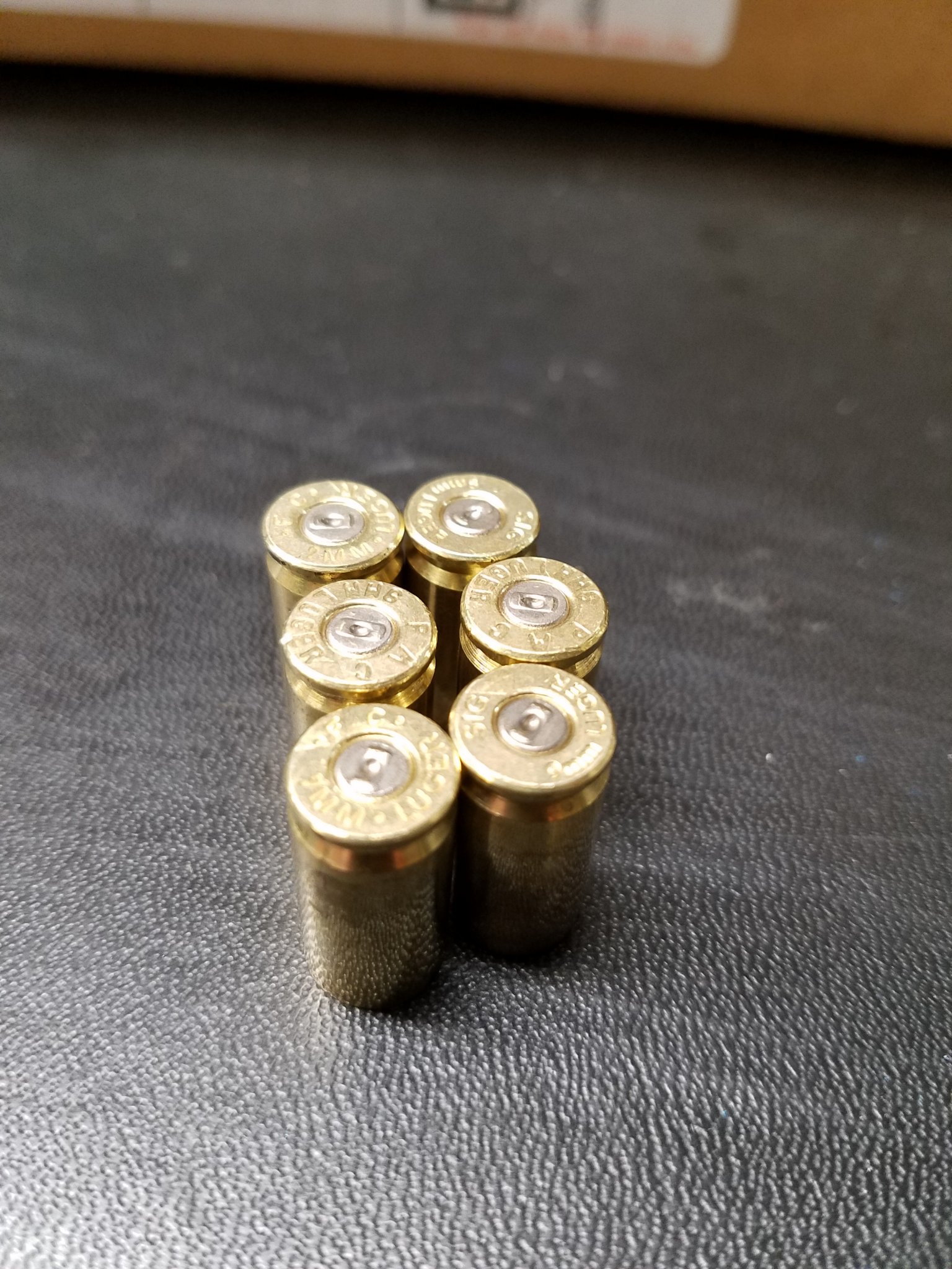

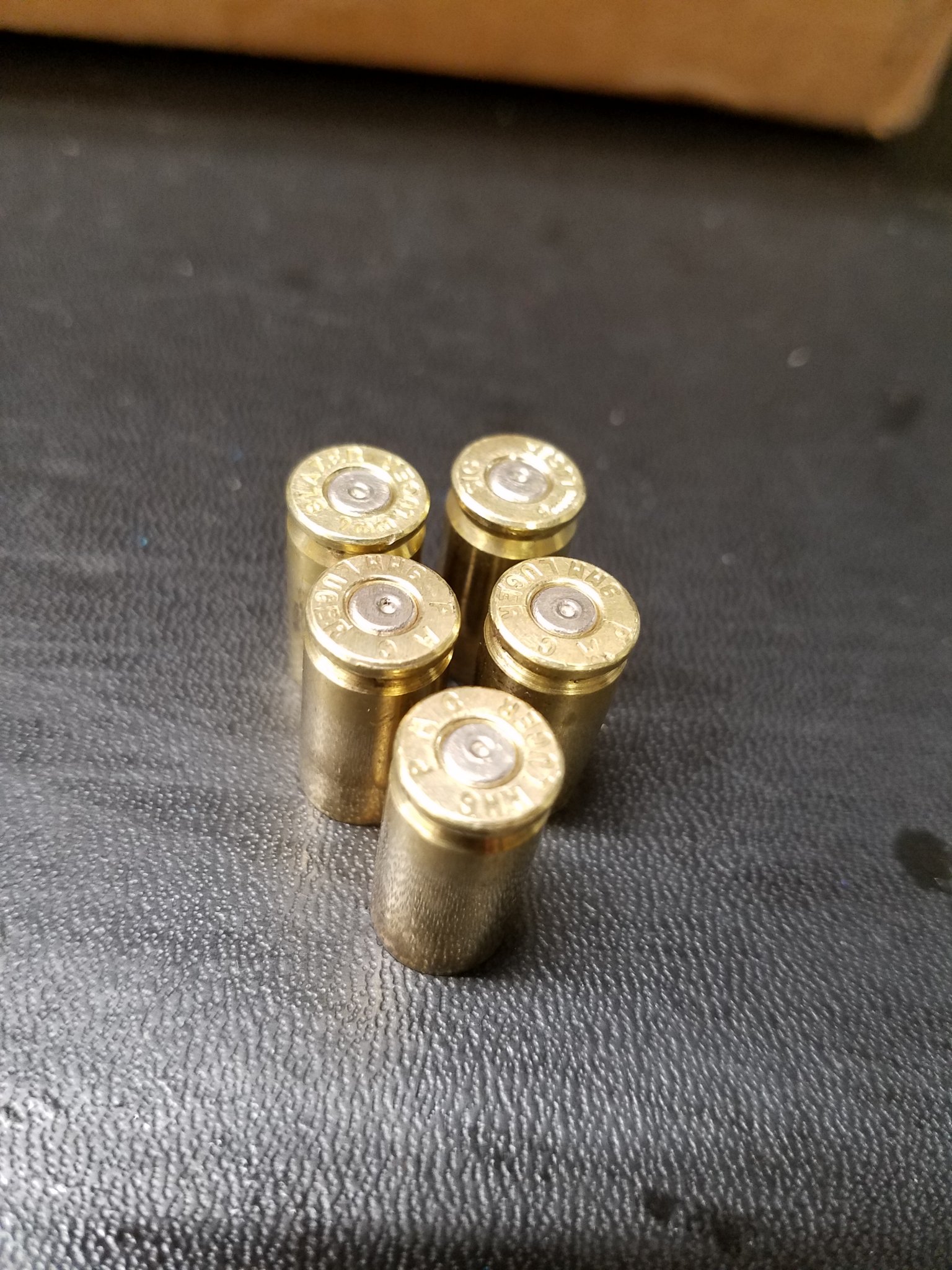

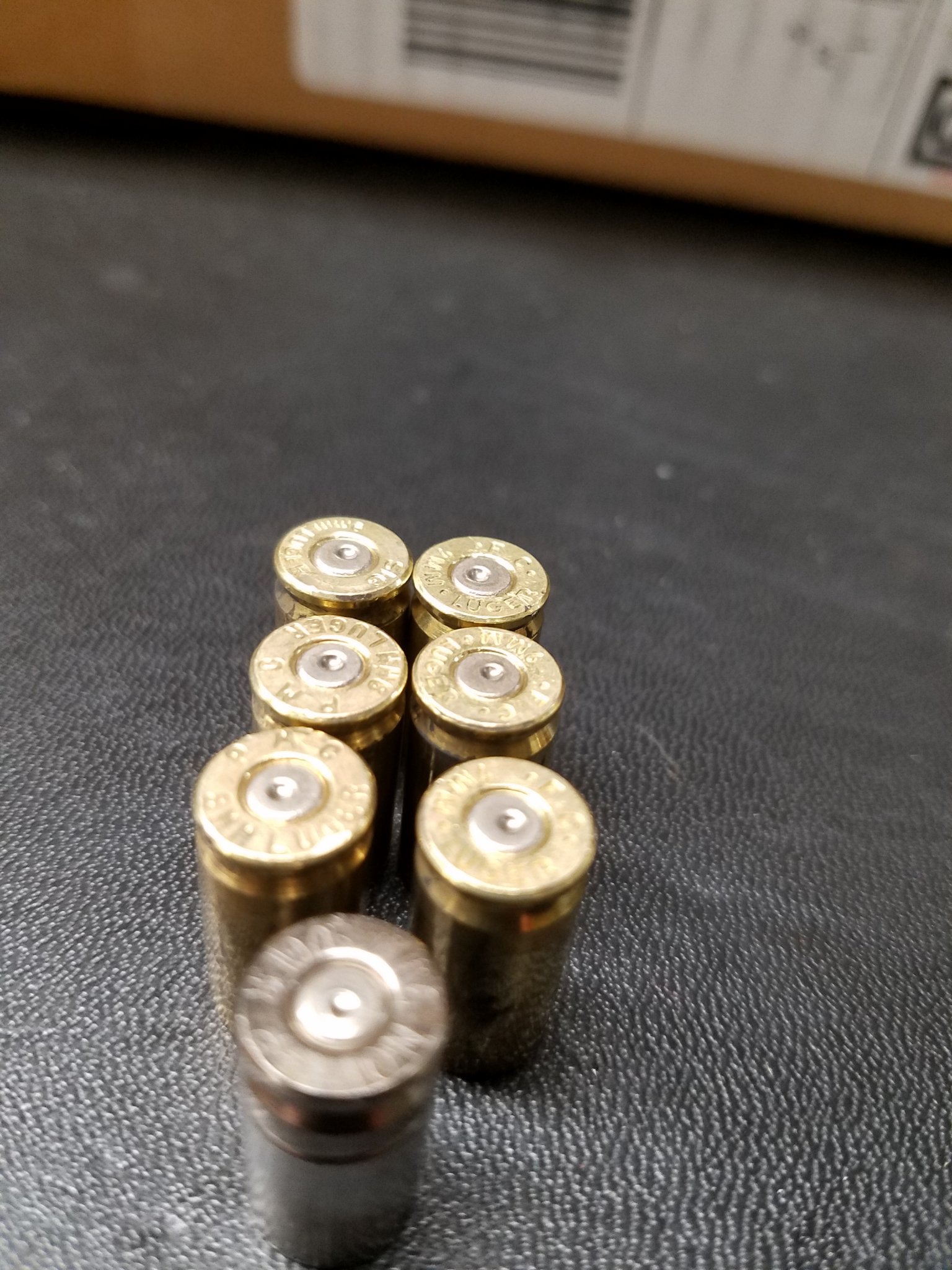

Ok I am having problems with my 9mm loads. First time loading for 9mm, been loaded other cals for several years now. Here is my load info.
4.8 gr. Titegroup
CCI magnum primers
65gr APX bullets
1.125 COL
.377 crimp.
I am getting flattened looking primers. I shot this same load out of 3 different guns. A Sig P320, Glock 17 and a Ruger Carbine. The primers looked the same with 5.1 gr od Titegroup. The rounds cycled fine in the Sig and Ruger. I had 2 not eject with the Glock. So I am wondering if it is low pressure causing it. I only chronograph them out of the Ruger. Right around 1800 FPS. I checked some factory loads with the same bullet and they were at 2000 FPS. Just wonder what you guys think the issue is. Here are some pics.
1st pics are from the Sig.
2nd the Glock
3rd the Ruger. The silver one in front is factory load.

It looks to me like the corners of the primers are very rounded still. I think they look fine.

Those primers look fine to me. You ought to see what some 9mm major power factor primers look like out of some USPSA open division guns!
