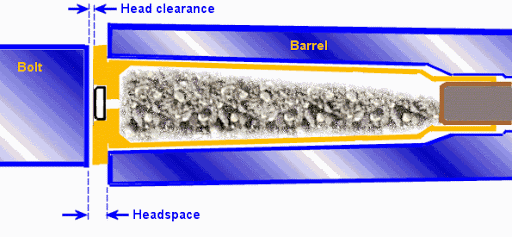

    With light starting loads, the last thing you see in the above pic does not happen, meaning the case stays forward in the chamber. The case does expand and seals the chamber, but it does not stretch back to the breech face. So the shoulder length does not change.
