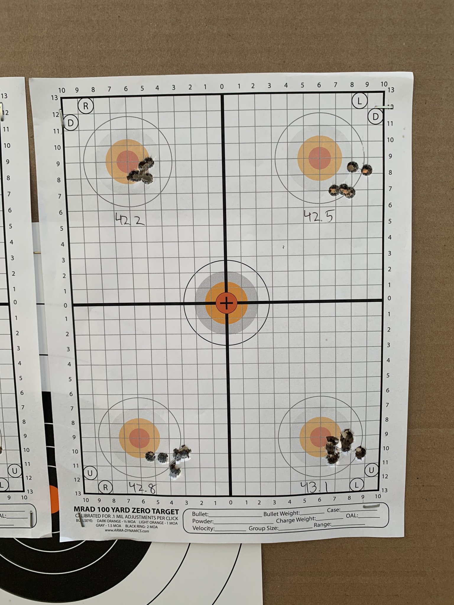

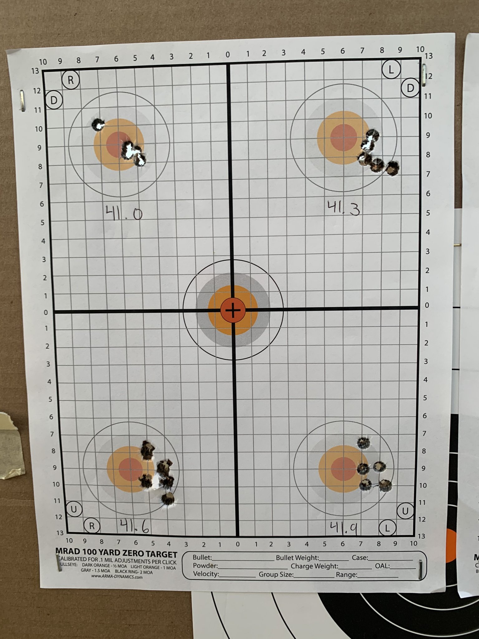

I bought 600rds of the 140gr Berger 6.5 Creedmoor ammo. So Far I've shot 200 of them, and am beginning reloading the once fired brass so that by the time I get through them, I'll have a load ready to go.
I loaded 5 shots each starting at 41.0gr to 43.1gr of powder in 0.3gr increments 42.8 and 43.1 had slightly compressed charges.

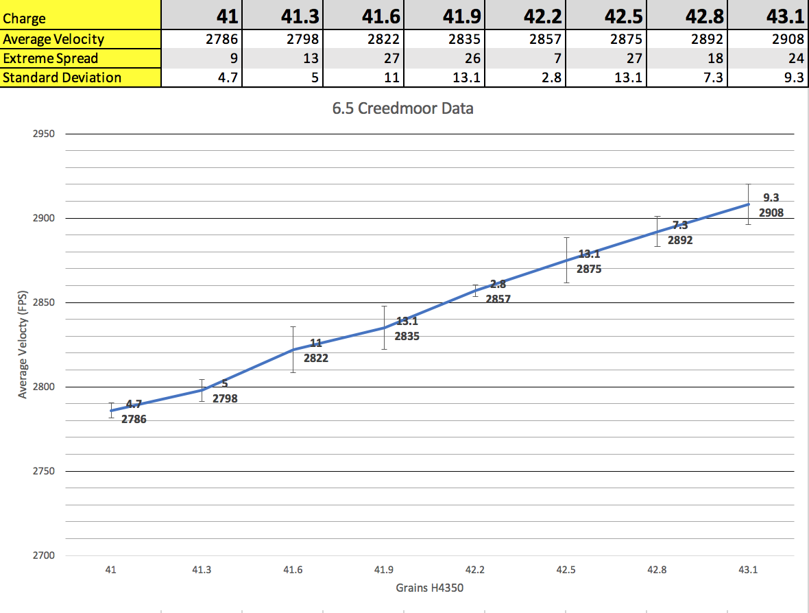

All groups shot had their velocities recorded on the chart below. Also, 41.0 I may have thrown that first shot.
Attached is a Chart of the load vs velocity. The Error bars shows the extreme spread of the velocity and the number in front of the velocity were the SD of the load. Note: 41.0gr and 41.9gr only had 3 of the 5 shots recorded (forgot to turn on the labradar)

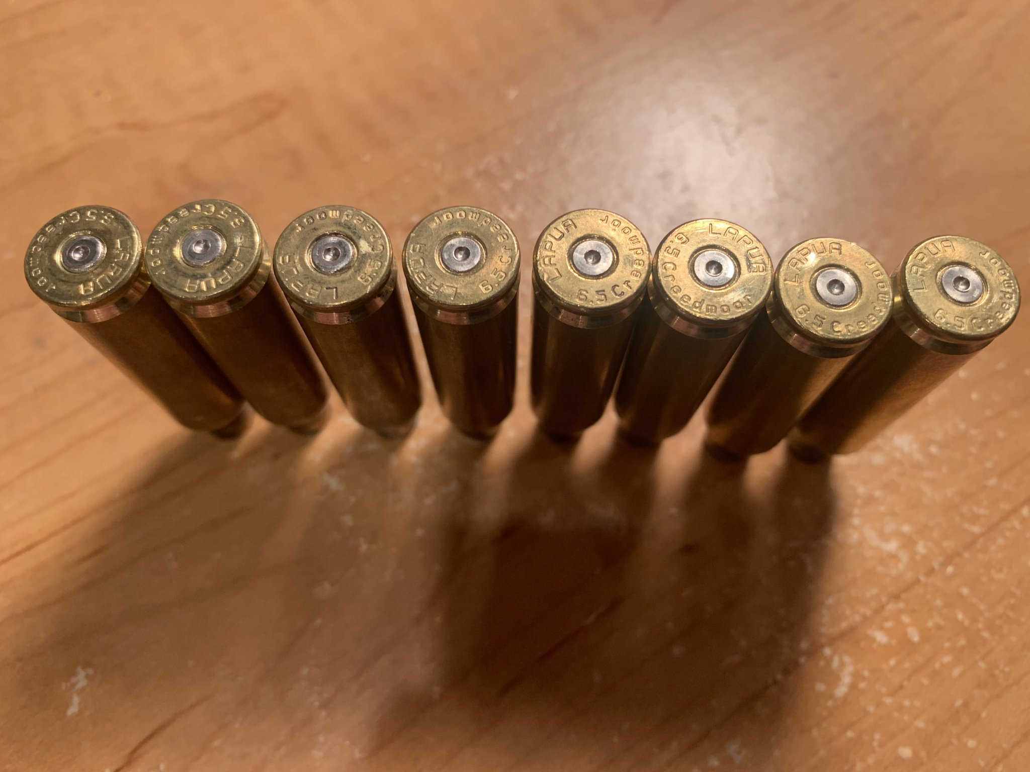

Here's what the fired brass looks like
L-R: 41.0, 41.3, 41.6, 41.9, 42.2, 42.5, 42.8, 43.1
Primer cratering:
There looks to be a ring around the firing pin strike on all the primers from all the charges. They are visible, as evidenced by the picture, but cannot be felt running a nail over it until 41.6gr. 41.6 to 43.1 you can feel it with your nail.
Primer flattening:
This one is a little hard for me to spot, so I could use some help with this one. I think there's some flattening at 43.1, and maybe earlier, but it's hard to tell. I feel like my eyes keep playing tricks on me.
Any advice on where to go from here? The primer cratering is concerning. I noticed when I got home that the bolt had some lube on it where there was none, so I'm wondering if the grease from the lugs ran a little and got in the chamber and am causing false pressure signs. But also, it seems like my velocities are kind of high from my research.

42.2 and try seating 20 out and 20 in...the primers look fine...some guns just crater
Reactions: dadamsjr
X3 on rolling up 42.2
move the seating depth .003 at a time .020-.025 deeper than where you are at now.
I mean, honestly, i didnt read your post as i just looked at your pics but whatever seating depth you had with the 42.2 seems like a good group for 6.5cm. Sure, you could probably tighten it up but you wont ever miss a target due to your grouping with what you found right there. Either way, if you wanted to possibly tighten it up, 42.2 is your charge weight i would go with.
Reactions: JeffLebowski
Look at 41 and 42.2. Load up +/-.1 in each to make sure you're in the middle of the node. Once you find that, play with seating depth if you want.
But, as said above, 42.2 is plenty good enough to just run as is.
FYI on primer flow: I have this constantly happen with all of my impacts, mostly when using SRP brass. I don't know what it happens (I run a lower node and FL size .001") but I have learned to not use it as an indicator of pressure. YMMV
Reactions: BLKWLFK9
My nucleus action will crater a load that is 3 grains below book max. doesn't matter what the pressure is so i dont even look at the primers. That is due to firing pin diameter and not pressure.

Classic case of looking at the best group and smallest numbers. The groups and numbers on either side of 42.2 are not that good. The minute something changes, there is no node to be inside of to account for the changes. Also, you can make any load shoot well @100 with seating depth.
41.0-41.3 has good consistent numbers. That’s a good powder node.

Erik Cortina looks for several charge weights that exhibit low es across them.
I’ve been to his class. He specifically cautions against looking at the smallest single ES. He also doesn’t shoot groups to find a powder charge.

For many 6.5 Creeds a 140gr quality bullet at ~2,800 fps is money. I agree to stick with 40.6-41.2 and abandon the higher charges.
Once you settle on charge, play with seating depth and your load development is done.
They say find a powder charge with small sd/es and tube the load after that. Erik Corinta seems to say the same. I was going off smaller es/sd

My goodness that is some textbook looking load development data. Definitely load up a group or two more at 42.2 as it looks like you may have something there. I might also load another string of 41.0 as there is a pretty tight nucleous there as well.

I'd load 40.6 to 41.2 in .2gr increments and reshoot. You're over max and the chronograph says your rifle doesn't like the load combinations.

I wouldn’t even bother with 42.2 just because the ES on either side jumped drastically.
41.0 and 41.3 were consistent. If you’re dropping your powder on a good scale and keeping your brass prep pretty consistent, I’d just run 41.1 in summer and 41.2 in winter and do seating depth test and be done. (Provided they both work with a water test for pressure)
If you’re not confident in your charge and brass prep, run the whole thing again and see if your numbers are consistent.
41 to 42.2 is about exactly 3% which is where your nodes should be... 3% in between nodes. 3% of 41g is 1.23 so 42.23...
So you are in accuracy nodes there for sure.
BUT as dthomas says, your 41g load to your 41.3 your ES/SD is not as jumpy as your loads surrounding your 42.2g load, I would probably play with that 41g load. Load 5 round loads in .1g increments +-.5g... so 40.5, 40.6, etc... to 41.5 to really zero in on it. Shoot em over the chrono and you will see your answer in the numbers. This will give you a very stable load that if your thrower throws .1 high or low, the temp changes, etc... you will still be ok.

Primer is noticably flatter at 41.9
42.5 has an obvious ejector imprint.
I would treat 42.2 as a max charge.
Thank you! Appreciate the feed back. I noticed the primers seemed a little flatter but couldn’t quite nail down where they started to get flatter

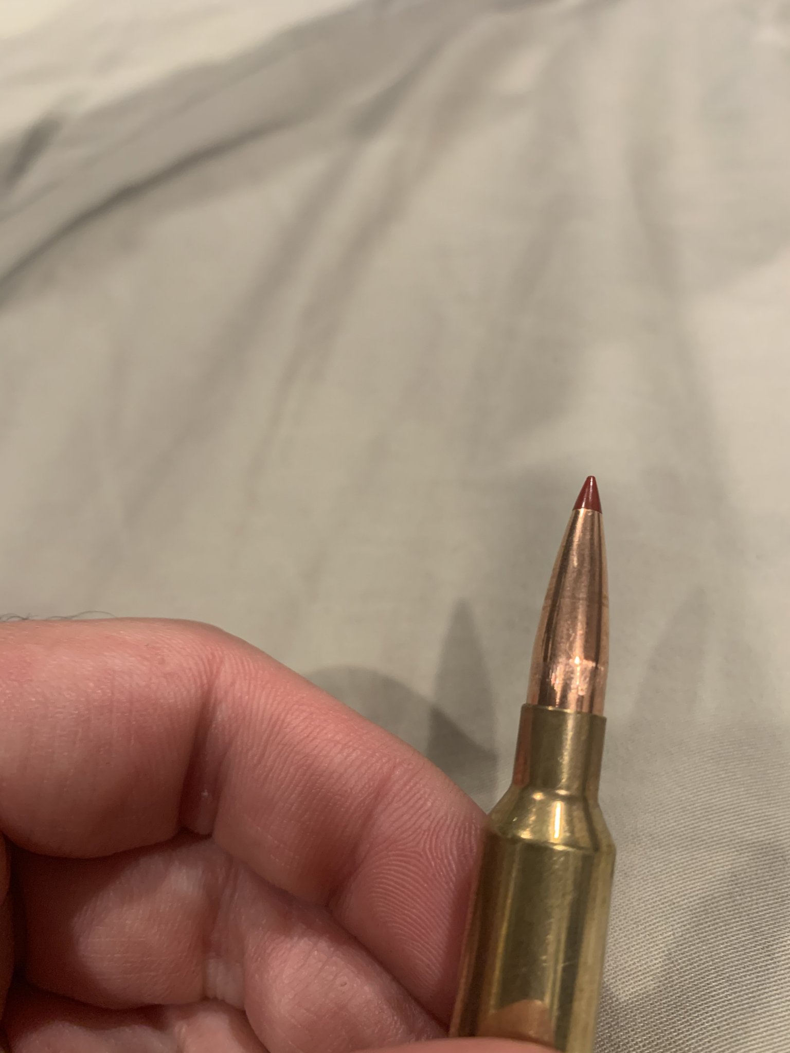

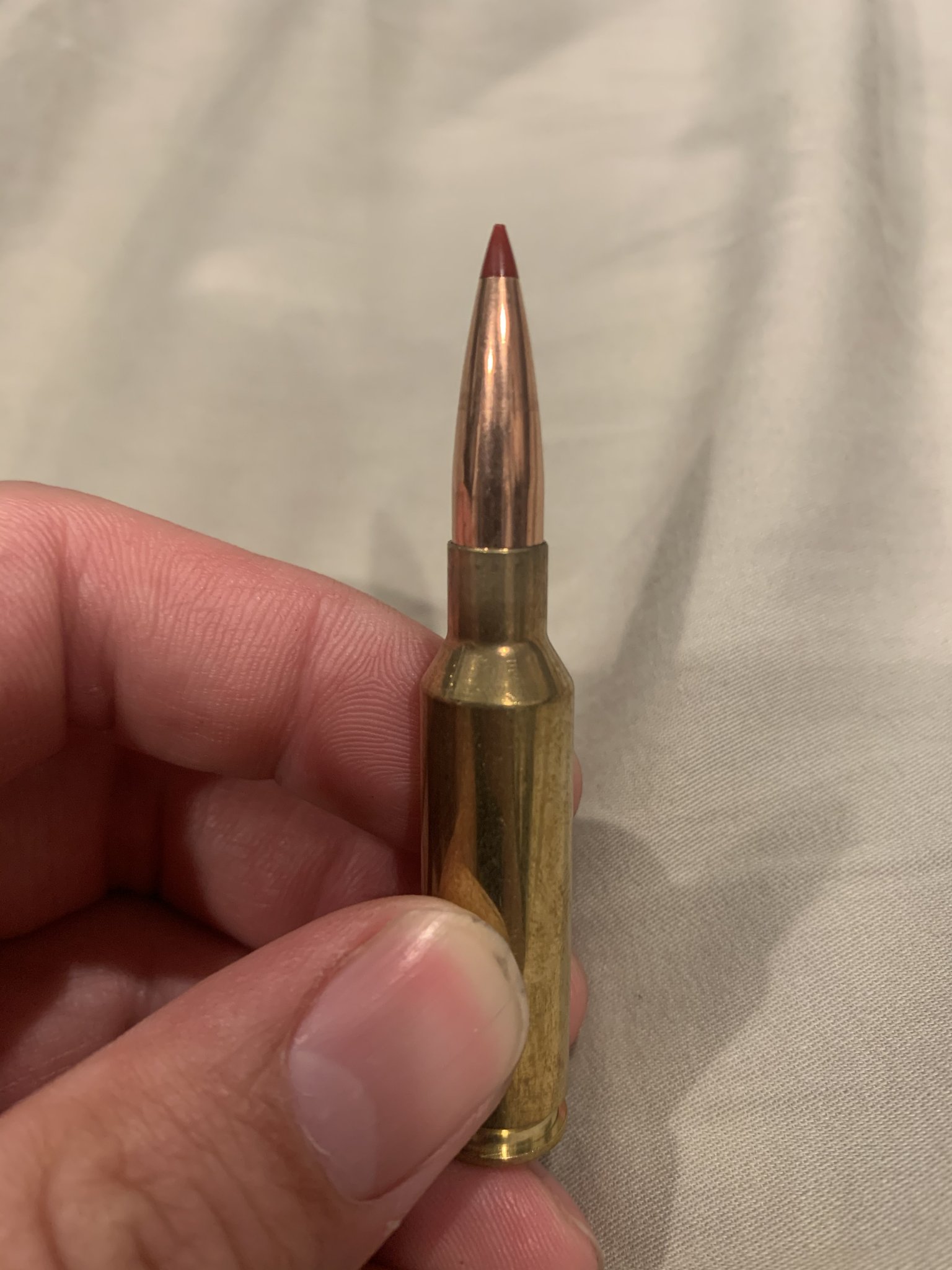

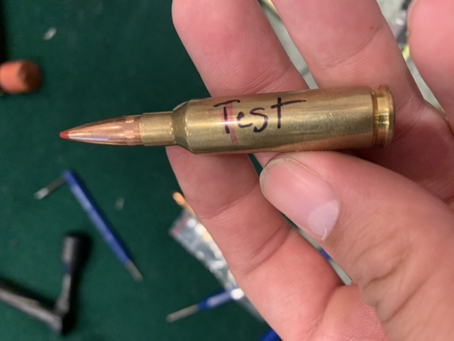

The first picture is a round before I chambered it.

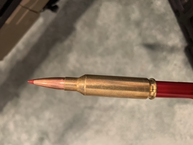

The second picture is after chambering it. Notice the marks? These marks go almost all the way around. Chambering it, there was some resistance when closing it and turning my bolt handle down. I’m assuming it’s into the rifling and turning my bolt handle down is scraping it against the rifling.
I’m scratching my head because I’m using the same die setting as I did last time when I was jumping 0.020”. My last reloads I wasn’t experiencing this at all and the die was at the same setting.
Any idea what’s going on? My reloading gear is all put away, but this weekend I’m going to get my bullet comparator out and try and see if it’s measuring any different than my first reloads. Last time I Ioaded, I didn’t measure with the Bullet comparator because it was the same die setting as the time before

To my eyes, the chambered round is visibly shorter.
Don't know what is going on, but something has changed. In fact, it looks different enough, that I would suspect a full rotation error on your seating die micrometer. I've done it before myself. Have you touched the die at all?
I think we have a winner! On my first test, around 42.8 and 43.1, I had to increase the pressure by 0.005” to get the same seating depth due to a compressed charge. I may have turned the die the wrong way and went outwards instead of in to set it back.
That would make sense since one full turn is 0.025”, and I was 0.020” off the lands. That means that I was jamming in 0.005”

So I went to go measure the rounds today. The chambered and unchambered rounds all measured 2.133” distance to I give using a 5-26 comparator.
The die was at the correct setting, although seating 0.005” farther than before. This is a little off because I thought setting my die to 75 would give me 2.128”. But I guess I’m seating them 0.005” off, which gives me a jump of 0.015” instead of the 0.020”. The last time I measured the lands it was 2.148” to the lands using the same bullet. So I’m kinda scratching my head why I’m having a hard close and scraping if I’m supposed to be 0.015” from the lands still.

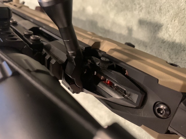

Clean throat so that’s not an issue.
Take the firing pin and ejector out of the bolt.
Insert piece of brass (fired and sized ideally) and make sure the bolt falls free with gravity or has very very little cam over resistance
Seat a bullet and make sure the bolt falls free with gravity or has the same very small cam over resistance as the brass.
If the bolt is tight on the brass, you have a sizing issue. If it doesn’t and is tight with bullet in, your bullet is into the rifling.

Do the above test and you’ll know immediately if it’s your brass or the bullet making things tight.

So I chambered a brass, and it fell without resistance.
Tried chambering with a seated bullet, and it encountered some slight resistance right about here:
When I put the slightest bit of pressure on the bolt, it falls leaving these marks
Measuring with a Hornady OAL Gauge, I got a length of 2.055” length to Ogive with a 5-26 comparator when it touches the lands. The bullet when seating to the lands seems really short.
I was seating to 2.128” before and didn’t have a problem. That means I was 0.073” into the lands? That doesn’t seem right to me. I feel like I should have encountered resistance at the 2.128” setting. I didn’t notice a problem until my bullets were seated 2.133”. Any thoughts on this?
I agree with others that you don’t want to look for the smallest groups. But your 42.2 has .3 above and below it. I’d be loading 42-42.4 in .1 increments @.10 off the lands and see how they group. That range is where most people’s load lands and if they all have the same vertical print you should be fine to pick 42.2. My question would be at what point does the vertical change you see at 42.5 on the test target happen. If it’s at 42.5 you’ll be fine. If it’s at 42.3 that will narrow your node significantly. You can tweak seating depth if the groups aren’t quite what you want but are consistent.
Much appreciate the help. I might give that a shot once I get this seating depth puzzle figured out.
I’m not sure why it appears I’m touching the lands with a such a short cartridge length to ogive.
Pushing it forward with the Hornady gauge as I measure it, I’m sure it’s hitting the lands. It even sometimes gets stuck and I have to knock it out
That’s odd for sure. Have you measured the factory Bergers that you were shooting? I would guess their BTO would be longer than that but I don’t shoot factory ammo so maybe I’m wrong.

Berger lists 140 Hybrid Target Load at 2.810 COAL for reference. What bullet are you loading and what bullet was in the factory ammo?
You may have an issue with your comparator? I know that a 156 EOL will bottom out in a Hornaday comparator.
