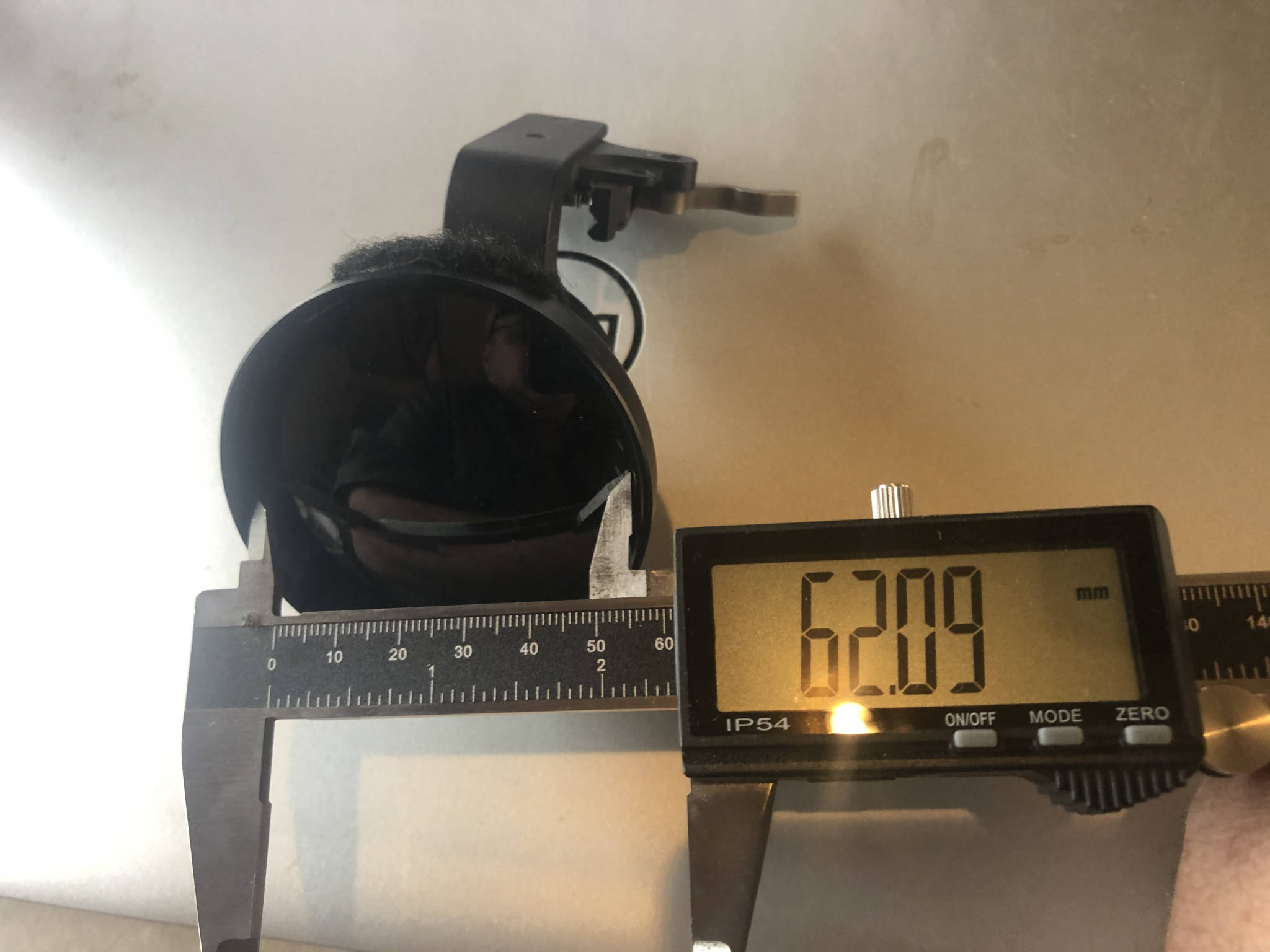

I think you will also find the magnifier is not actually 62mm. I was just having a discussion with someone about this magnifier this week and trying to understand why the 60mm patrol was 4.5x but the patrol with this magnifier attached was only 3x magnification. The answer was that the magnifier is giving the objective diameter for it's mm vs the lens size or focal length.

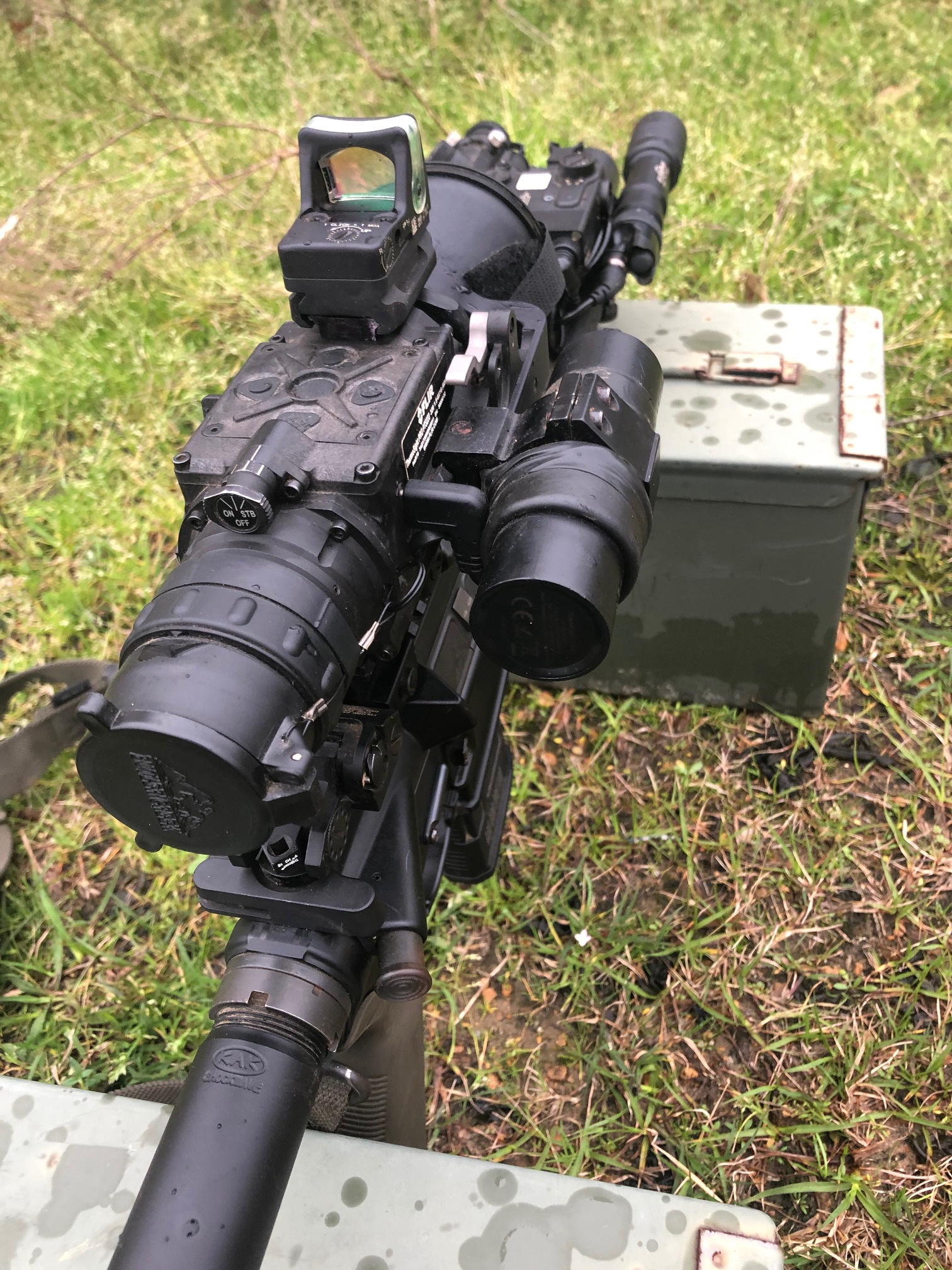

Here's my ideal full helmet setup (I run minimalist setups with less) for general walkin and stalkin ...
From top to bottom:
Skeet
14
COTI
And here's my current long distance thermal spotter/thermal range finder ...
With the Raytheon 3xG magnifier on there, it works fine up to 12x net magnification able to see cattle out to 5,300yds at night and able to range 3,300 yds at night.
It can be worn on the helmet, though it is a bit heavy. Add more counter-weight !!
You are completely wrong about the TPL 3x Magnifier not being actually 62 mm of Germanium. See Pic below and actual measurement I just took. The Patrol 60mm has an F1.1 is why it gets to 4.5 Native Magification.
Now that is interesting on the size of the unit. Interesting on the F# being the difference... I'll shave to do some more research on the difference between the 60mm patrol vs the standard patrol to try and understand why one comes out to 3x vs the 4.5x... I didn't expect different numbers between the two patrol units
I found references for F/1.2 on all 19mm units but the 60mm @ 1.25

Another option that worked well for me for many years, but I hunt primarily open terrain in West Texas. If wooded/thick cover then thermal on the weapon is the way to go.
PVS 14 for navigation which you already have.
Get a pulsar handheld thermal for detection. Mine is 5 years old and still works great. Scanning with a thermal on the weapon is terrible.
Another PVS14 with 3x magnifier behind an EoTech on your weapon. This typically provides great PID on the target as you learn thermal signatures of different animals.
Wouldn't work on your 6.5CM, but would be fine for 5.56/300BO. Have made plenty of shots out to 300 with that setup, but most were under 50. Nice, precise shot on the first pig, then turn on laser (doesn't have to be fancy/expensive) for running shots.
If buy used you'd be well under budget. As you get out there and get more experience, you can start saving for what might work even better for your particular style of hunting.

I believe the Reap & Patrol are really on the heavy side to be helmet mounted. Yes you can do it but they pretty heavy systems. I would prefer the lighter Breach. Much more helmet friendly in a lot of ways. Plus the Reap Version 1 with the "inline battery housing" is a known design defect that results frequently in a busted battery housing from recoil. A recent poster reported that Trijicon wanted $5,000 to repair his unit.
I have looked somewhat at the Hogster Clip on and it seems to have a great image. However, I don't know much about all their features, housing construction and overall durability. So until I see something come out that will fill my needs all the way round that is durable, I am going to stick with the Flir Thermosights. They have just proven themselves to me such that I trust these units more than most others.
