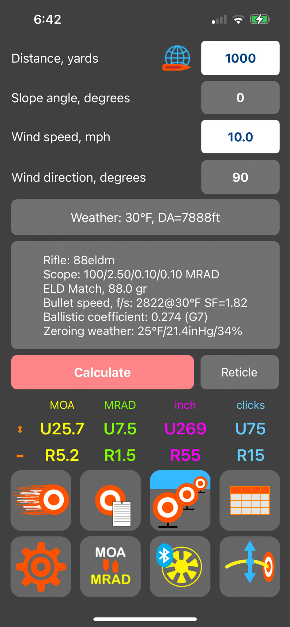

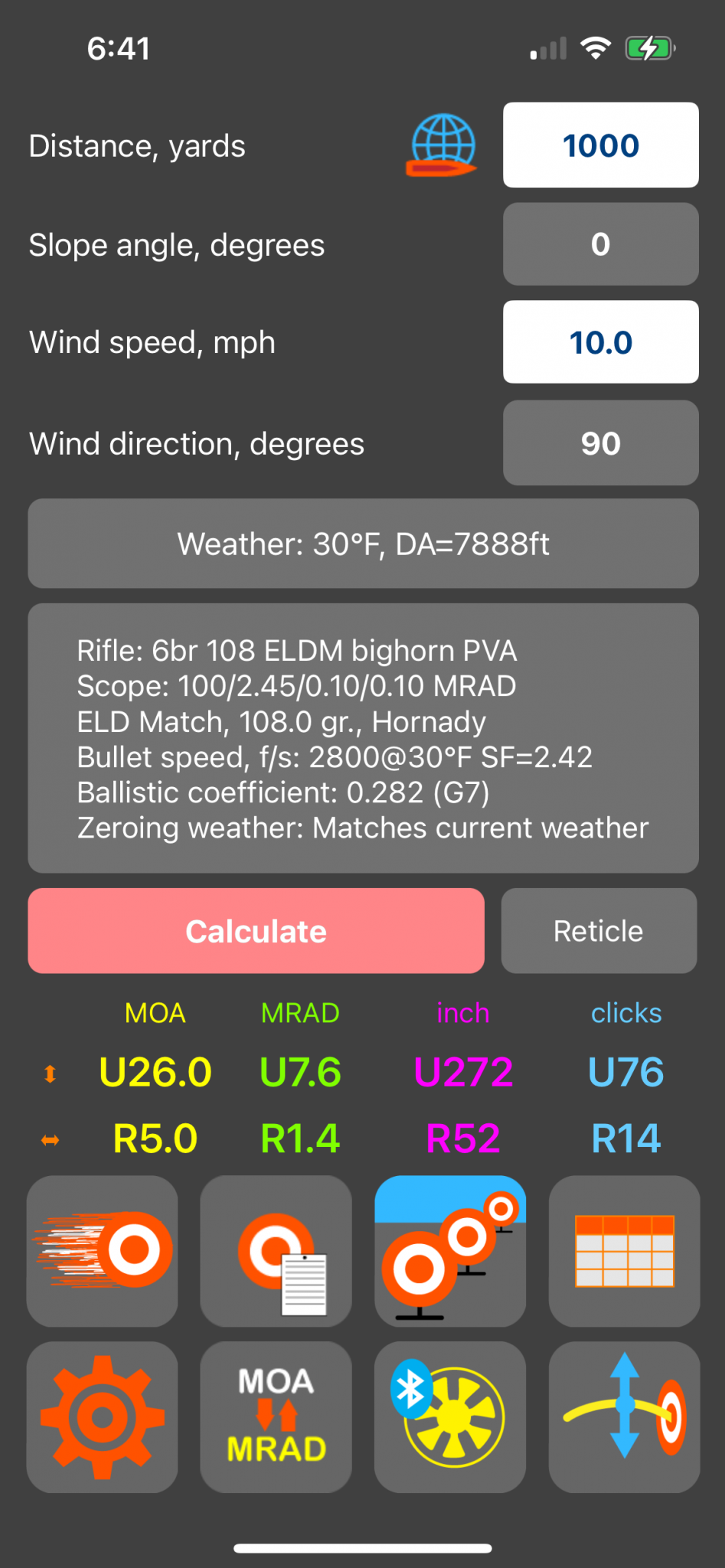

I kinda like this direction. I recently had fun tinging steel out to 725 with my 223. Beyond that I couldn’t move the steel or hear the impact. With so little recoil I was able to spot all my own impacts. If you’re in obscene winds maybe not so fun. But in decent conditions out to 700 or so all day fun for peanuts in ammo cost.
I agree on impact energy out further is much harder to see. For me it’s around the 800 yard mark that it starts to get hard. Most of the matches I shoot have hit indicators starting around this distance so it works. Below is my old 6br match load with 108 eldms and my current 223 match load with 88 eldms. Admittedly both are on the warm side and brass doesn’t last long which on the 223 it’s not a big deal since brass is so cheap. The info is 1000 yards with a 10mph 90* wind. The 223 has slightly less drop at 1k and the 6br has slightly less wind. We are taking a couple inches. For all purposes they are equal.
For the 223 to be a real option you need a long throat barrel with fast twist and you have to hand load. Factory rounds are neutered to allow them to fit in ARs.

According to my solver my 223 has 542# energy at 1k and my 6br has 672#. Decent difference but the reality for me is most targets/points at the matches I shoot are probably under 600-700 yards and the 223 gives a noticeably benefit closer up.
