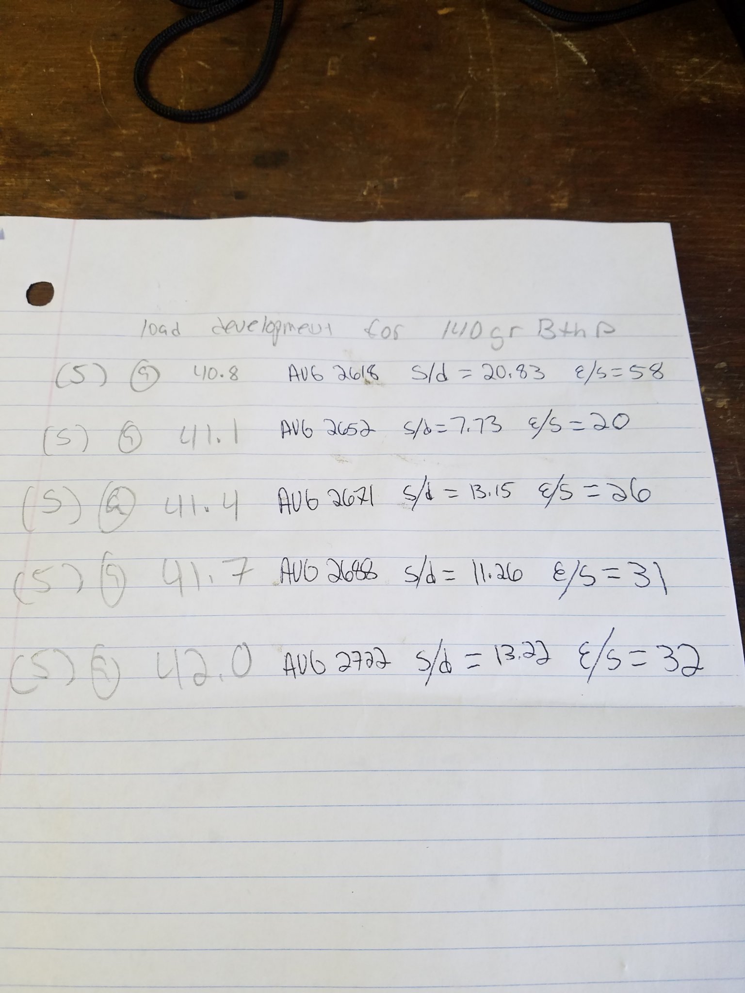

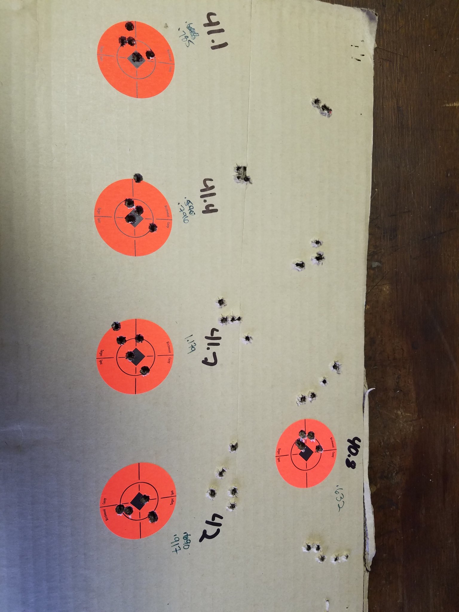

Hey guys, new reloader here and trying to find some guidance on finding an accuracy node on my rifle.
Here is my setup
Ruger precision rifle 6.5 cm
Hornady brass
Cci br2 primers
Hornady 140gr bthp match bullet

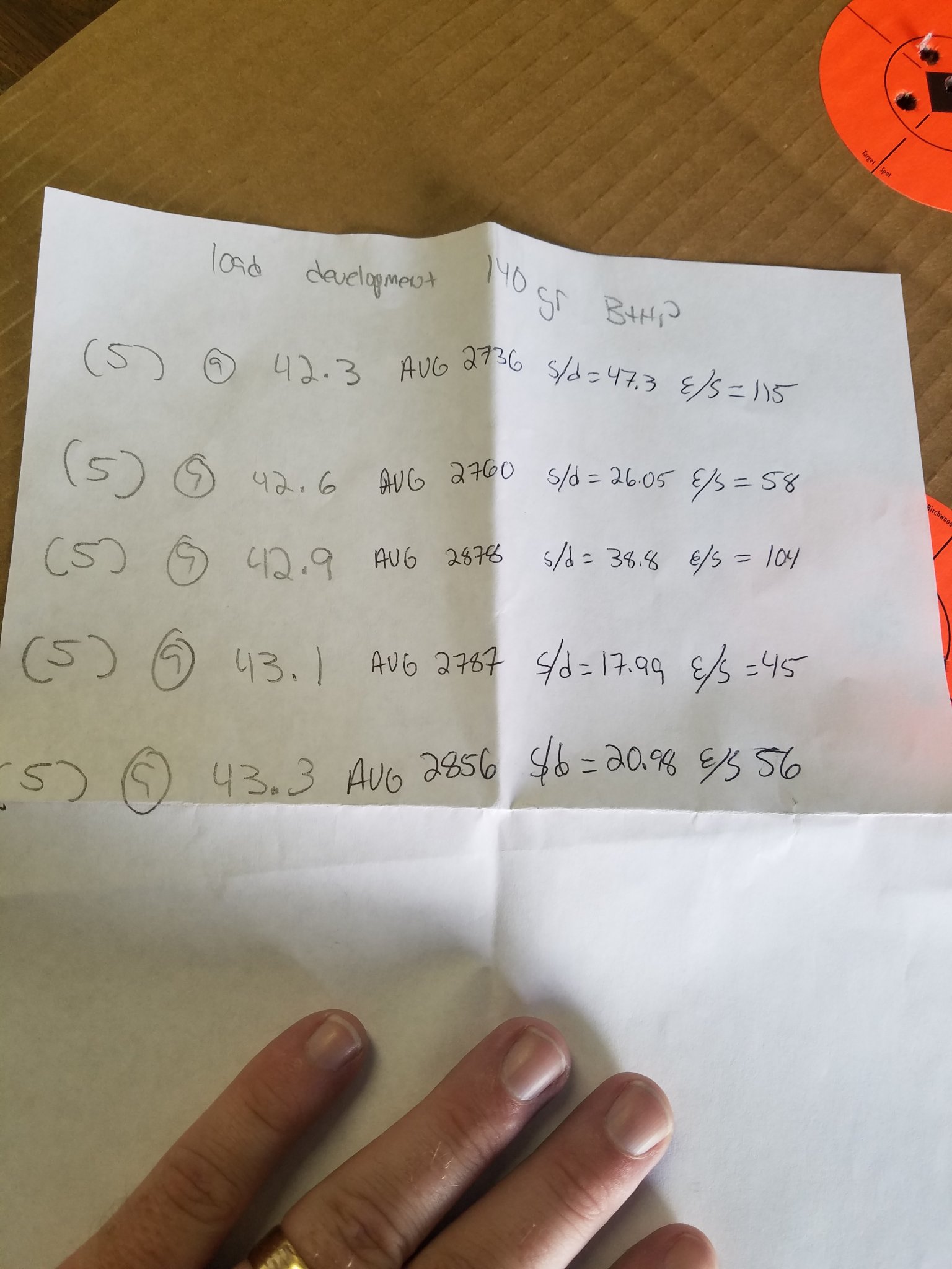

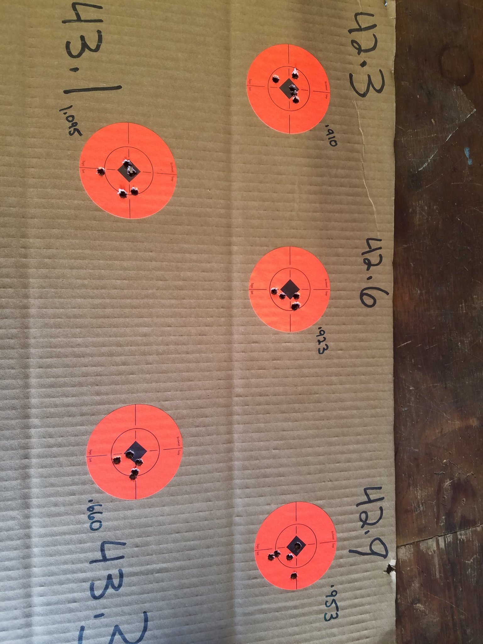

I loaded up 5 different weights and shot for groups and I'm trying to see which load I should further pursue. The lower charge 40.8 grouped decent but it was slow fps I thought a good node for this rifle was around 2700fps?
Any help / tips appreciated I'll post pics of the data
Also I should add barrell wasn't freshly clean it probably had 30 rounds thru it since last cleaning before I did this ocw test. Barrell has about 700 rounds down it total. I had no pressure signs at all during test
Were you getting loose primer pockets, sticky bolt lift, etc? If not, maybe try loading up to like 43.8 maybe even 44 but in very small and safe increments. Unless you're fine with the speeds you got. If that's the case, I'd tinker some more with seating depth and maybe going up or down in charge with smaller increments on your 41.1 load!
I like your step sizes of 0.3 gr. It looks like you have a node with 40.8. I would try 2 or 3 more steps above the 42 gr load to see if another node develops.

I will keep going up in weight and see if I find another node. I am wanting to have a good round that I can shoot at 1k + yards.

I suspect if you load 3 rounds at 41.1, 41.2 and 41.3 and shoot them all at the same target...see how all three charges group. They look like they all will have same POI . If that's the case you have a great node and then you can tool around with seating depth and refund your brass prep for accuracy. My RPR loves RL 16

personally...i would re-shoot that entire test after i found out where i was in relation to the lands and run those bullets about .010 off the lands if you can...the only thing i see worth chasing is the 40.8 load but for me that is to slow id want at least 2750 or so and 41.1 opened up.
that said i bought 1000 of the hornady BTHP several years ago and shot 800 of them through 3-4 different barrels with different powders and primers and never got them to shoot well enough to continue using them...they may shoot in your rifle but again if it was me id run another test at .010 off the lands(if you can)and if they did not group better than the first test id change bullets...id also only load 3 of each charge weight and see if there is anything worth chasing...if 3 dont shoot a decent group why shoot 2 more.
also since your new to reloading you might want to try this instead of the OCW...ive shot most of the different load developments...ladders...OCW...the 10 shot posted above,ECT...and a few bastardized ones as well....this is the fastest,easiest load development ive found/used...in the last 10 barrels ive found loads within 30 or less rounds.
i know he is shooting a 6CM but just adjust the loads to your rifle and like i said id only load and shoot 3 rounds of each charge and see if you have anything worth chasing.

Just got back from the range after continuing my load development. Looks like I'm coming into another node around 2800fps ish.
I had no pressure signs with this setup should I keep loading heavier and see if I can get it to tighten up more?
