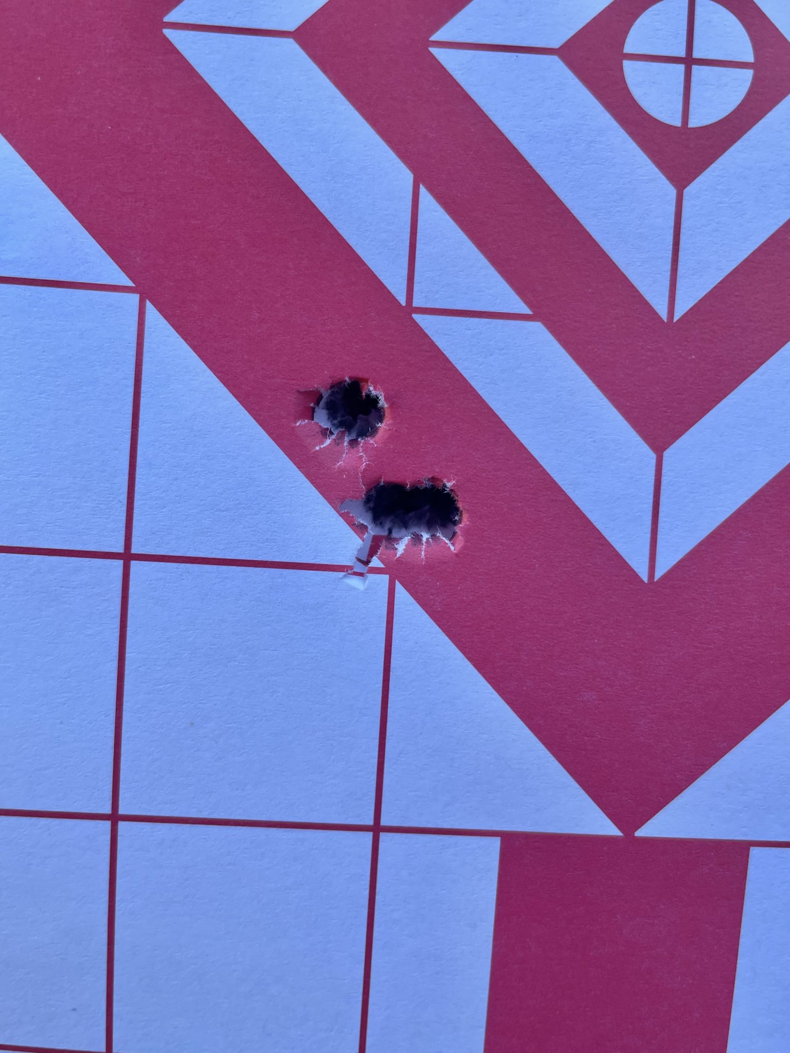

My seating depth test today. I already had a box of this loaded with my original charge so just brought in the seating depth to see what it did. Center group is my original COAL max

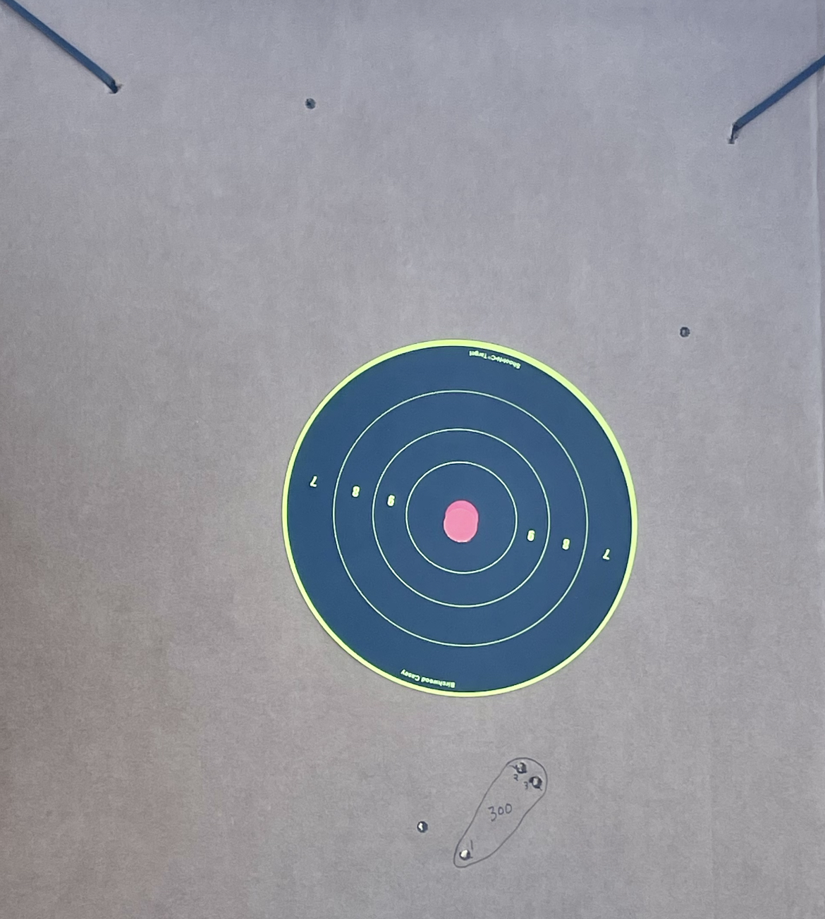

It’s been a 7 months process for me so far. It will have the occasional awesome/ acceptable group then it would throw a round way off. I hope that’s what it was and I’ll start my load OCW and seating depth over. I did shoot this at 100 yards the other day with just my offset RMR sighting it in😆
