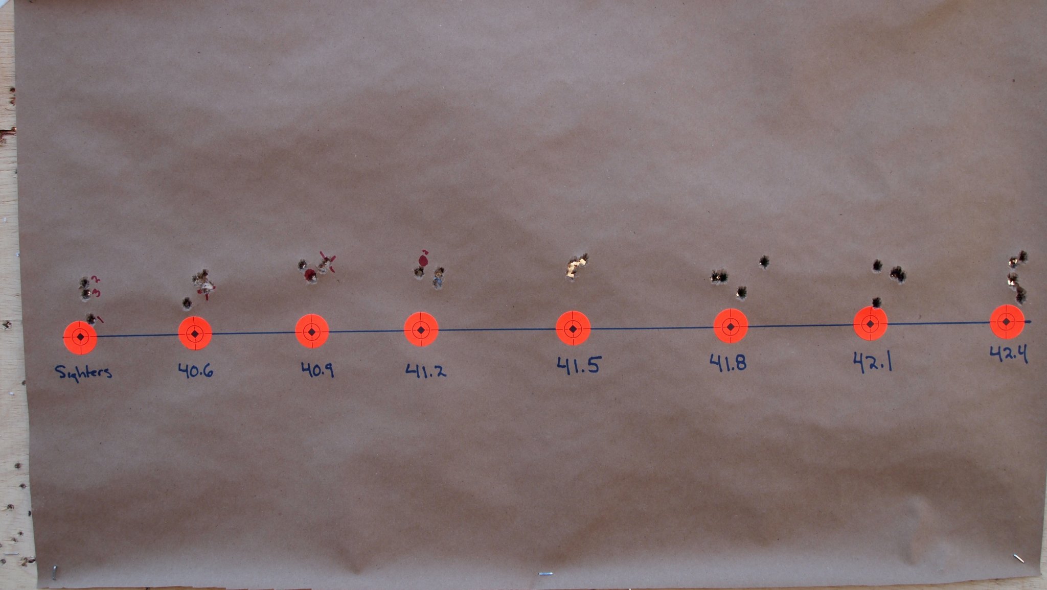

    100 yards, 25 inch Schneider, 175 SMK, CCI 200, I4064, FGMM 1X brass
    Rifle
    Target
    Numbers
    41.5 is a great group. 41.2 will win number wise. Really 40.6 to 41.5 all are pretty good.

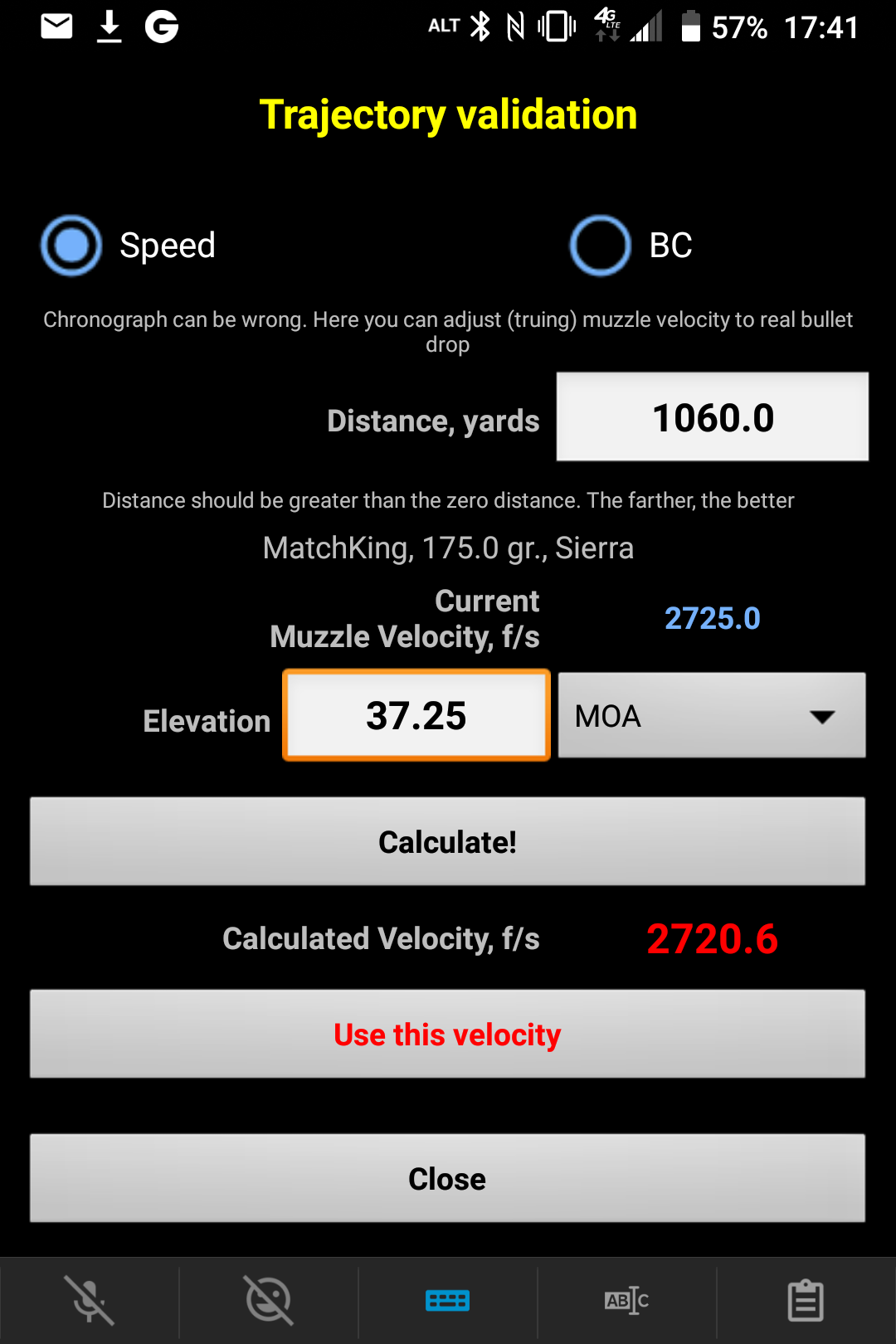

    I was doing either 40.5 or 40.7 of IMR4064 with Lapua Brass when I was doing the 175 SMK at 2.85" OAL
    ~2725 FPS and 1/2 MOA out of my 1:10 26" Savage 10 all day long.

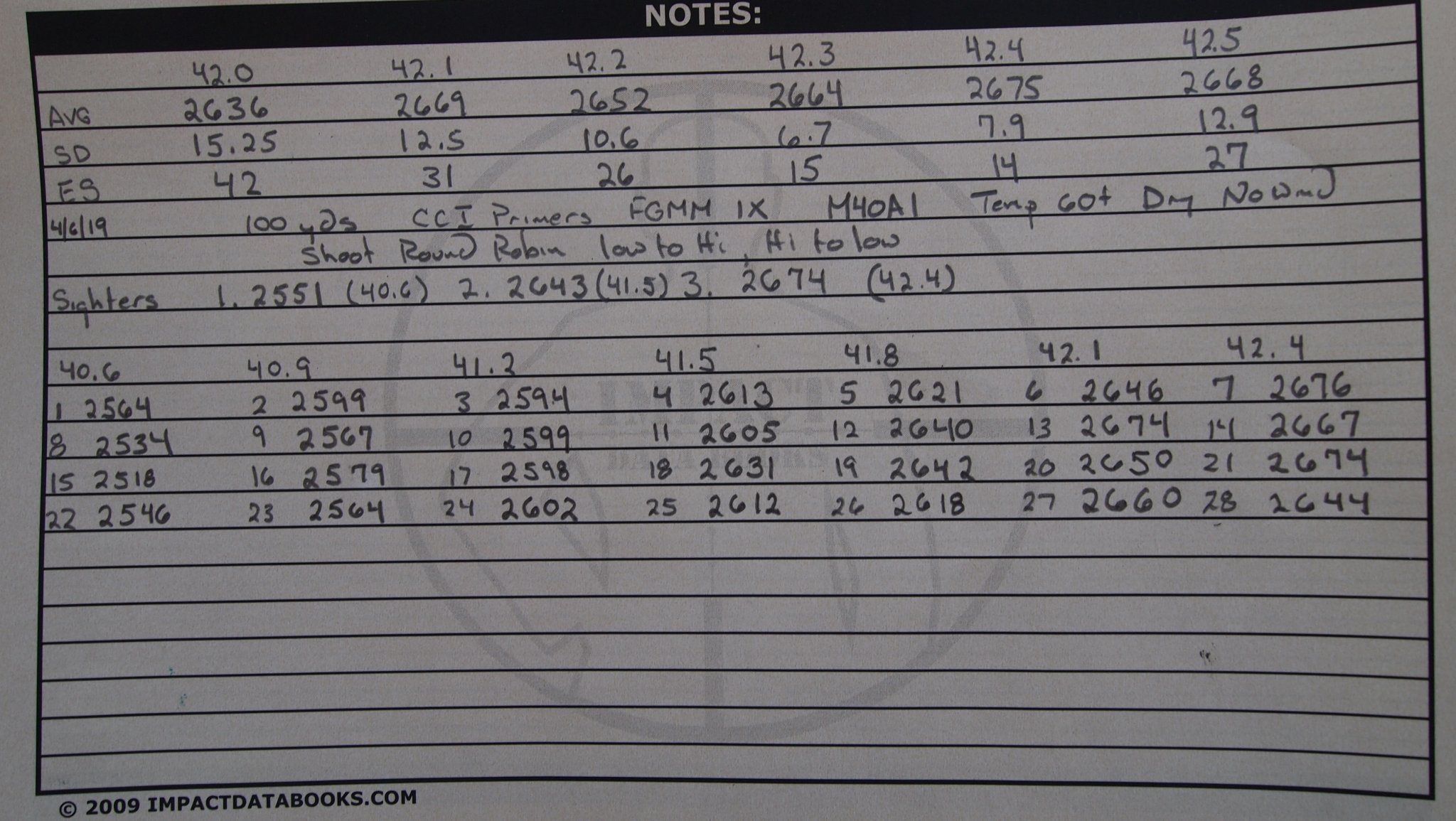

    I think 42.3 still looks good. It has the numbers for one thing. It appears exactly where it would be expected to, so it passes the sniff test there.
    If you look at your group centers and map them, you see the orderly rise and fall of the sine wave pattern with the wave bottoming out with your 41.8, 42.1 and 42.4 loads.
    I would choose a charge between 42.1 and 42.3 because 42.4 is probably on the leading edge of the next change coming up. When the weather gets hot it could throw you right up into the next big movement in the pattern.
    Let me see a charge between 42.1 and 42.3 Ill need to use my fingers for counting instead of typing.....
    42.3 was my choice with the WLRPs.
    Im willing to reinvestigate that area.
    Ill try....
    4 at 41
    4 at 41.2
    4 at 41.4
    4 at 42.1
    4 at 42.2
    4 at 42.3
    Ill keep current length to Ogive the same. These are short at about 2.8 COAL +/-.
    Was intending to run 2.81, 2.82, 2.83 when I choose my powder charge.
    24 rounds and 1 piece of butchers paper, no big loss there.
    If you have time start at about post 55 here....
    42.3/42.4 was going to be my chosen load prior to switching from WLRPs
    Appreciate any input you all can provide looking at my series of targets from post 55 on.

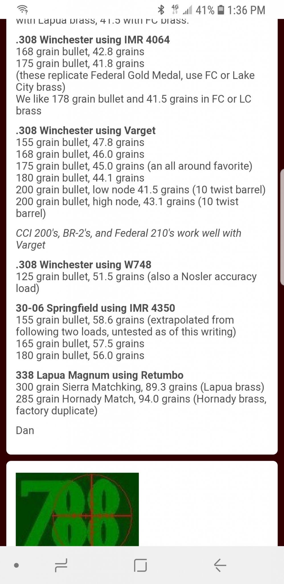

    I thought it was determined several years ago by Dan Newberry that it was 4064? Here is a screenshot from that thread.
    That particular load you screen shot is for M118 LR, not FGMM.
    I don't doubt you though, I too thought that at one time FGMM was loaded with 4064.

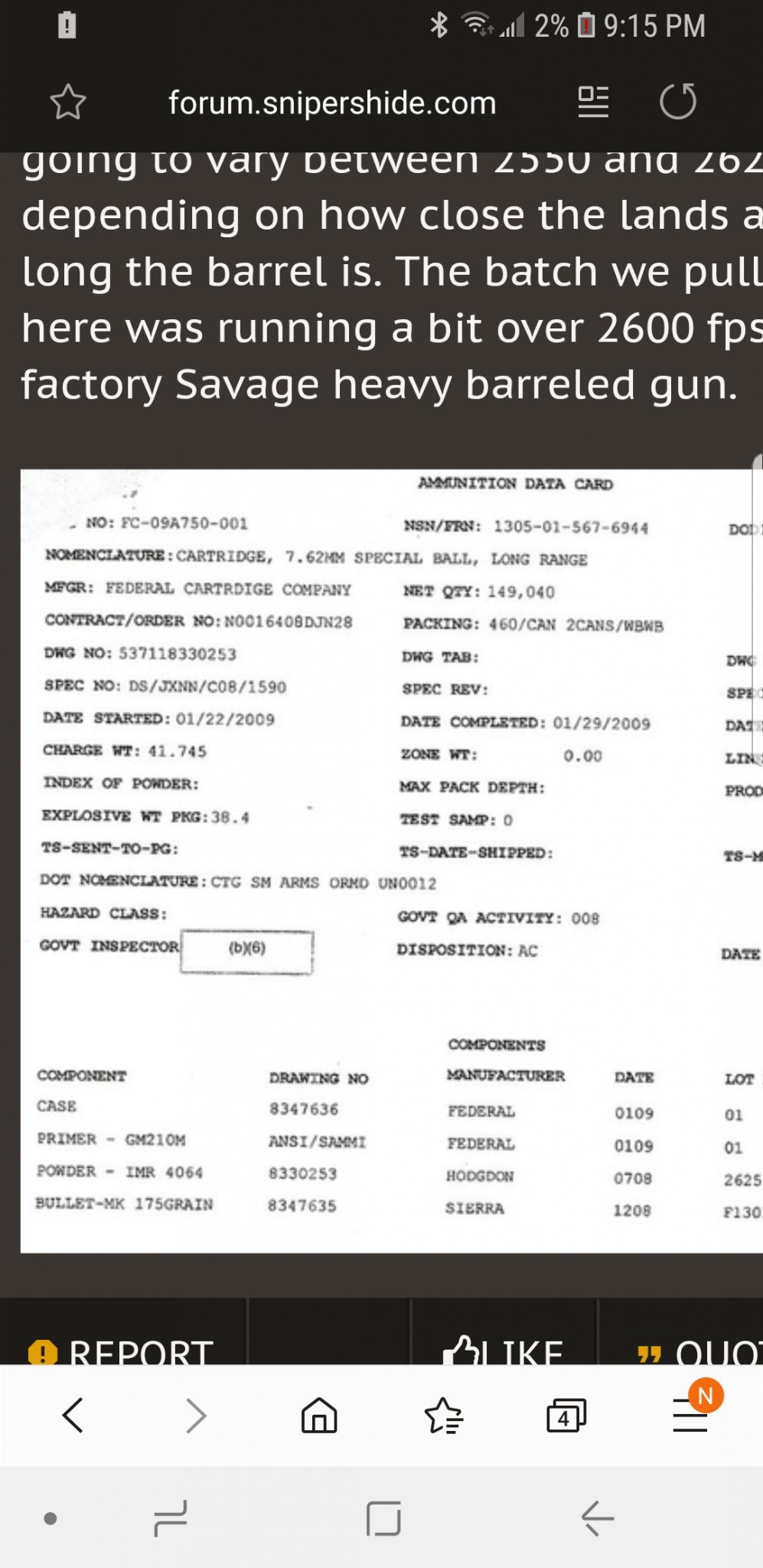

    The 168 was, not the 175. The GM762M2 might be but that’s not what what the FGMM gold standard load is.

    M118LR was/is loaded with Reloder 15. DODIC AA11.
    MK316 was/is loaded with 4064. DODIC AB39. This is also what the Gold Medal Match 7.62 load is, and is significantly faster than the standard 308 FGMM.
    308 GMM is ~2.8”, and MK316 along with 7.62 GMM is loaded to ~2.815”, so 918V has a point. I will also echo and say that my clone load of the MK316 does not like 2.8”...it tightens up the longer it comes out...
    M118 LR has been loaded with several different powders. German Salazar wrote a well documented article about that very subject on his blog "Rifleman's Journal".
