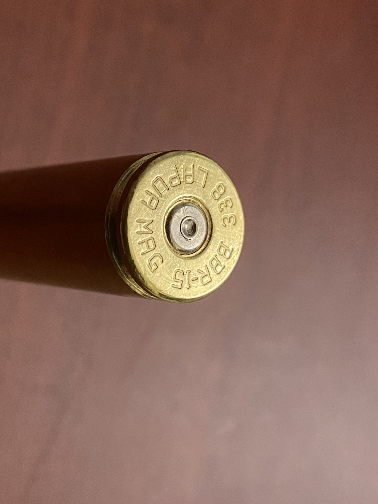

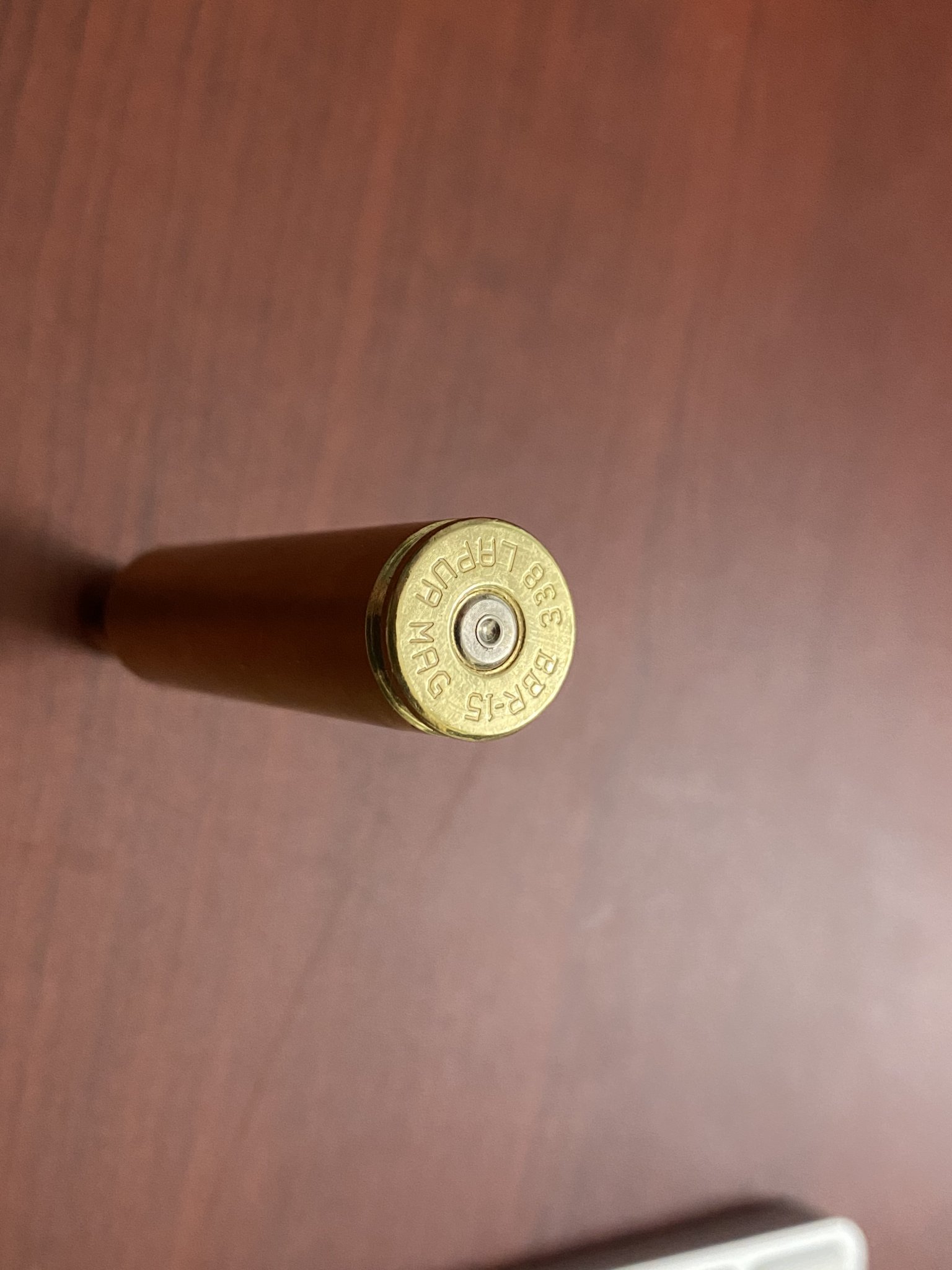

Hi all - seekjing help from experienced shooters in help me reading the pressure signs on the primer. Attached pic are for 338 lapua manum - H1000 91.5 grain - 300 grain berger elite hunter bullet - shot from 26 inch barrell in an AI AXMC.
Bolt opens flaslessly, however I do see some cratering on the primer. Can some experienced folks tell me, if the amount of catering and primer condition, looks too dangerous and should I back down? thanks for your attention and time.

Which primer's are you using?
Don't see any ejector swipe and you say bolt lift is ok, so it could be an issue other than pressure. . . ???
Reactions: harry_x1
Kind of .. thing is I want to shoot one mile targets and some articles on inrernet say, that for one mile you need to be minimum 2800 fps... hence trying hot loads, and seeking advice from more experienced loaders
