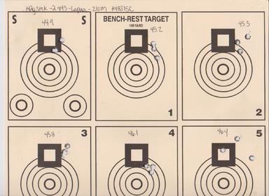

Been having trouble finding a good load for my Savage 12lrp .260 remington, but think i may have found some nodes.
All are three shots The top left and bottom left have 2 shots in the bottom hole, top left top shot may have been a flyer.
Which loads do you all think i should set up next.

#3 & #4 would be my choices to continue testing. Do you have a chronograph? If you are doing your part the vertical stringing are velocity spikes and I tend to stick to loads that have minimal SD.
I do have a chrono and the next phase i will be using it, i was thinking of trying 4 loads to narrow it down.
44.9 just too see if flyer was a flyer, or if the is a good note there.
45.2 seam like it might be un the middle of #1 and #3 so will try that.
45.8 want to see if this is a node
46.1 want so see if this is a node
5 shots each of these.
Where is Dan Newberry when ya need him :)
46.4 seems to be a scatter node, i remeber reading somewhere that a certin % below a scatter node can be a optimal node but cant seem to find that info.
I have a tikka t3 scout .308 that has a good node about every .5 grains (its a awosme gun) so even if the poi are differant there still may be one there, worth a try i think.
It seems like the node might be between 45.2 and 45.5, maybe 45.3 or 45.4.

I looks like 45.5 may be a scatter node if i add 1.5% to that i get 46.1 which was a nice tight group at 46.1.
But that puts it close to 46.4 which looks like a big scatter node. If i add 1.5% to that put me about 47.0 to 47.1 as another node.
So far this savage is being really picky for me, wondering if the nodes are just small.
I believe its 1.5% on either side of a scatter node, so it would around 45.7 or next node around 47.0 -47.2grs. I have found with little testing with 140gr a good node with H4831SC around 47.0grs with speed of 2800 with 24" barrel.
Ya im guessing this rifle may have really small nodes.
kinda wierd though if a scatter node is 45.5, and the +/- rule hold that puts the nodes at 44.8-44.9 for minus node or 46.1 for plus node. both of which have good groups if i had a flyer on 44.9
or If 46.4 is the scatter node then minus 1.5% would be 45.7-45.8 which has a good group, or 47-47.1 which i havent tested yet.
My tikka rifle can have a +/- .2-3 grain change and still group under .75 inch.
this savage rifle may only have a +/- .1 grain tolerance
Well here are new result. I think it just confuses me more.
45.7 had very good es/sd i forgot to do fouler and cold bore shot so first shot
was way right, next 3 shots grouped great, then last shot i could have pull but not sure.
47.0 is wired and 47.1 look like a scatter mode.

I wonder if your really running into compression issues, bullet pushing out. Not enough neck tension, had to say. Looks like 45.7-45.8 seems to shoot well. Maybe adjust col and tighten it up,,and recheck ocw with a 1% (.4grs) in both directions of 45.7grs. One loaded 45.3, 45.7, and 46.1. They should group under MOA.
