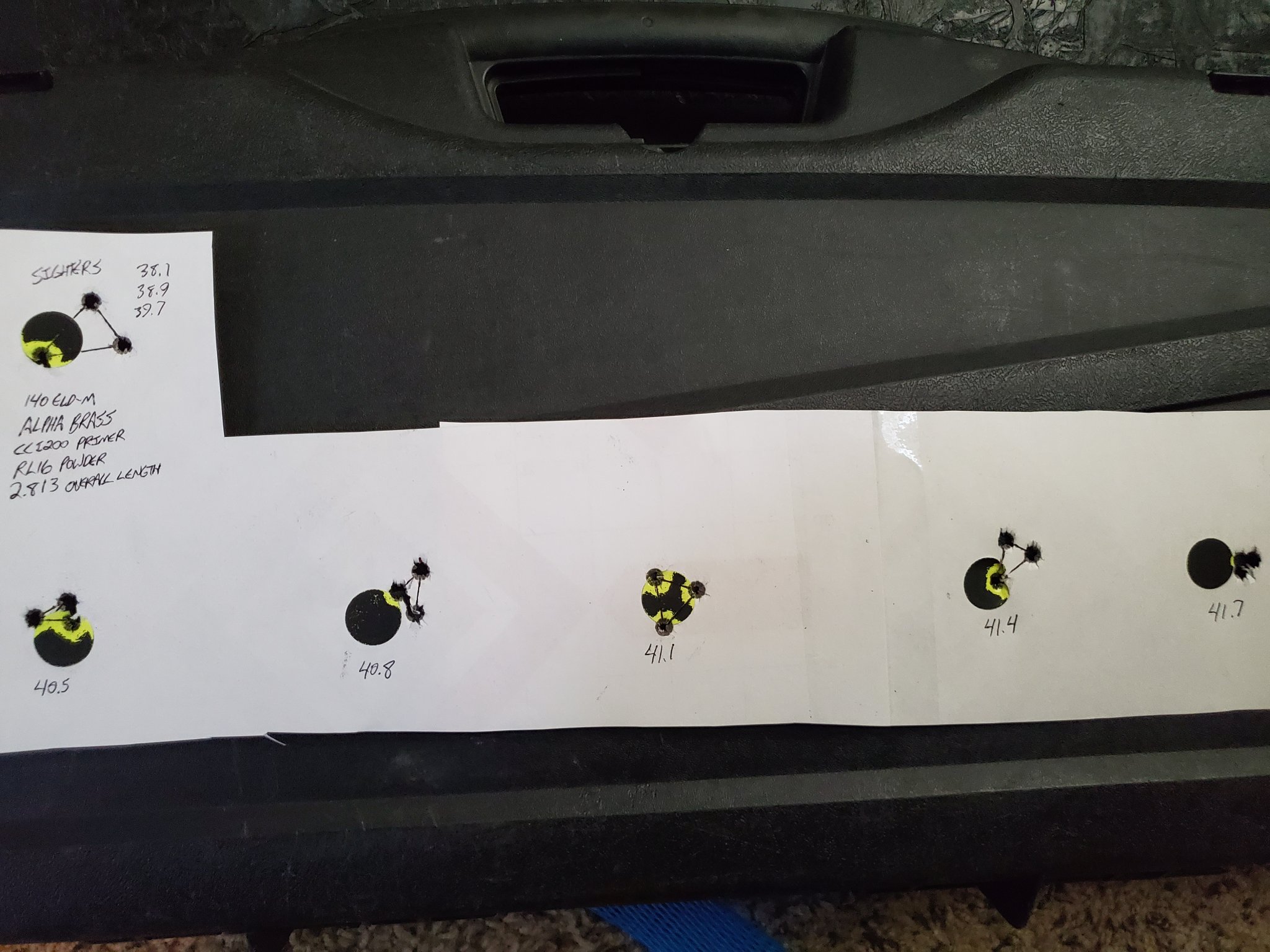

    I shot this OCW this morning. The barrel had 50 rounds through it (new barrel) before proceeding with this test. It's a 6.5 Creedmoor Criterion chromoly Remington prefit 24" 1-8" twist varmint profile.
    I'm not sure that barrel specs matter but they might be helpful.
    Results I see would indicate that 41.1 would be my OCW.
    41.7 looks awesome but I was seeing very slight pressure signs, and temperatures today were in the 50's with a cold wind.
    I don't have any velocity numbers, but my old barrel (23" Criterion SS) was 2752fps avg. with 41gr of RL16.
    So what do you all think?
    I only look at vertical dispersion, so 40.5 if you don't want to deal with a hot load. If you can repeat that with a 5-shot group with that charge, I'd call it good and move on. Why did you settle on 41.1?

    40.6 is what I run. I too hit pressure above 41.6. Im also 20” off the lands.
    Dan Newberry said to not dwell on group size, but where POI stays the same between 3 groups.
    So, 40.8 and 41.4 both trend to the right of the aiming point, and 41.1 is between them so that's where I got my conclusion. I could be way off too. I don't see a clear result so that's why I'm asking. Maybe I'm missing something.
    Speed isn't everything, but I would like to hopefully stay at above 2700 with 140's. I am contemplating a switch to 130's after I run out of 140's.
    Reactions: kampr
    Looks like you have two nodes 40.5 and 41.7. I would recommed 40.5 and work with seaking depth to try and tighten it up. I would actually call 41.1 a scatter node.
    I would only move my seating depths a couple of thousandths in either direction.
    I'll work on the 40.5 and see how it goes. Hopefully velocity is adequate. I may do the whole process again if 40.5 doesn't work out.
