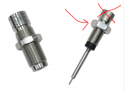

Well that seems low, so to double check the bushing, I tried taking the die apart. It's STUCK so bad it's damn near breaking my bench vise and the wrenches are tearing the shit out of the die. Nothing budges even a little bit! I've tried holding and turning it every which way to no avail.
What am I doing wrong?
I guess I could leave it as is, but I'll never be able to change bushings or clean it out. Help?!
