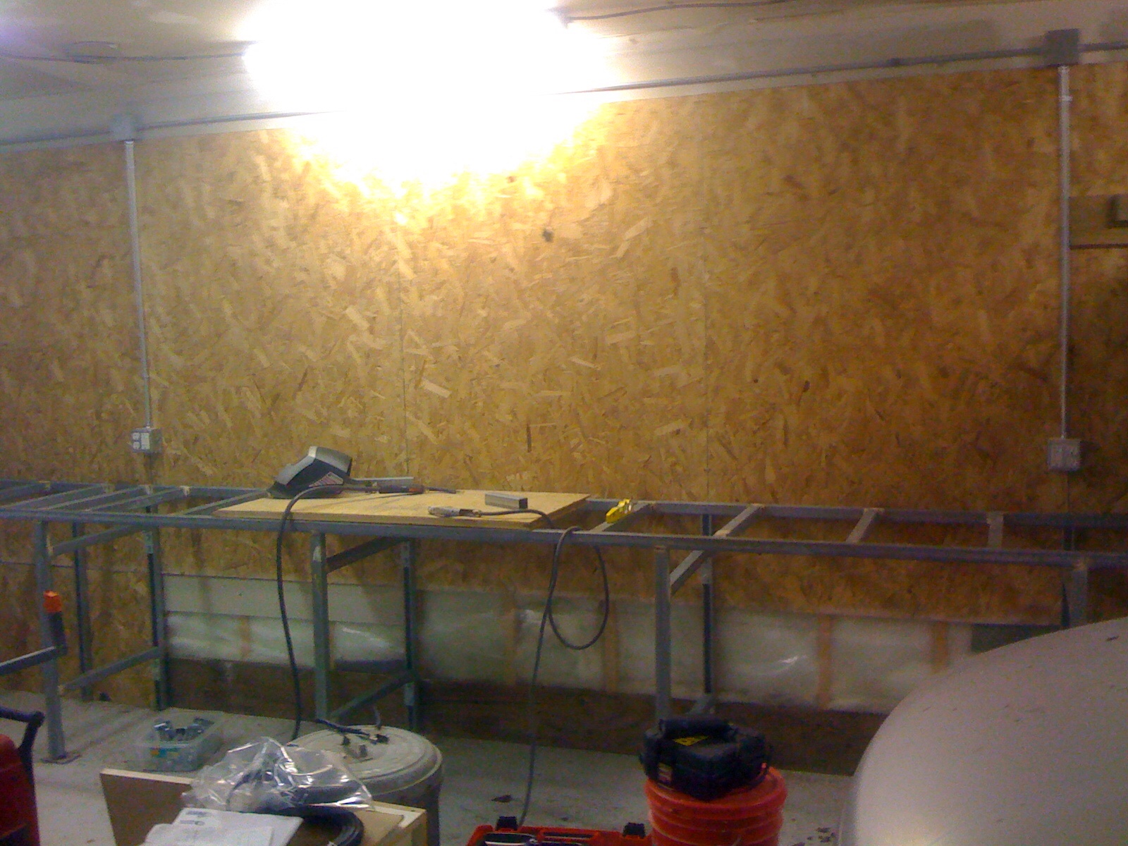

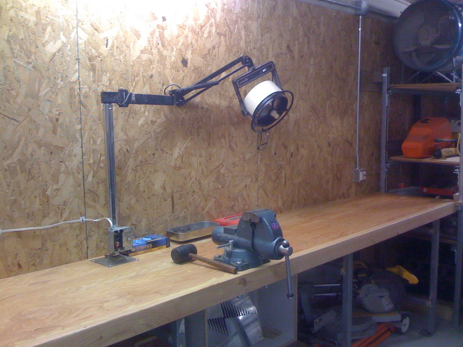

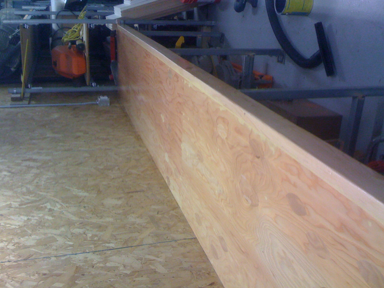

I used Unistrut in construction of my bench since I have lots of it laying around. Welded it all together and it's one solid frame. You could use tube steel also. Used a laser level and it's within a 1/16" one end to the other. Should be ok for your scale. I used 1-1/8" tongue and groove ply with 1/2" sanded plywood on top to give it a nicer finish. It's very strong top. I left open bays under the top so I can put roller cabinets under it for storage. Here are a few pics.
