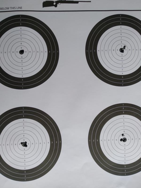

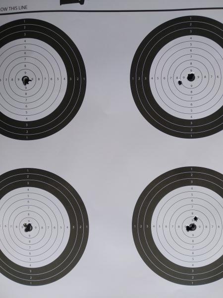

Do you have a 1761 MSR? I'm curious what kind of groups you're shooting.
I have the MPR which is basically the same rifle, just a different stock. Mine shoots pretty well. If you want to see groups, here are some 50m prone competition cards which are fairly representative and typical of how I shoot. 10 ring is 10.4mm, SK Rifle Match ammo, bipod & rear bag. (Bare in mind the nut behind the bolt is likely the cause of the poor shots!)
I compared some Center-X and R50 at 100m, 20 shot groups, 10 ring is ~33mm.
