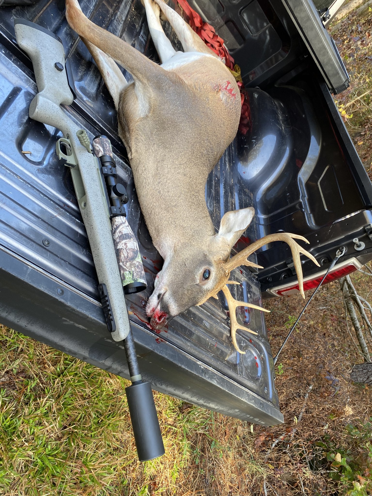

Just took my western hunting rifle deer slayin. It may have been overkill, but it was surely effective!
Seekins Element in 6.5 PRC
