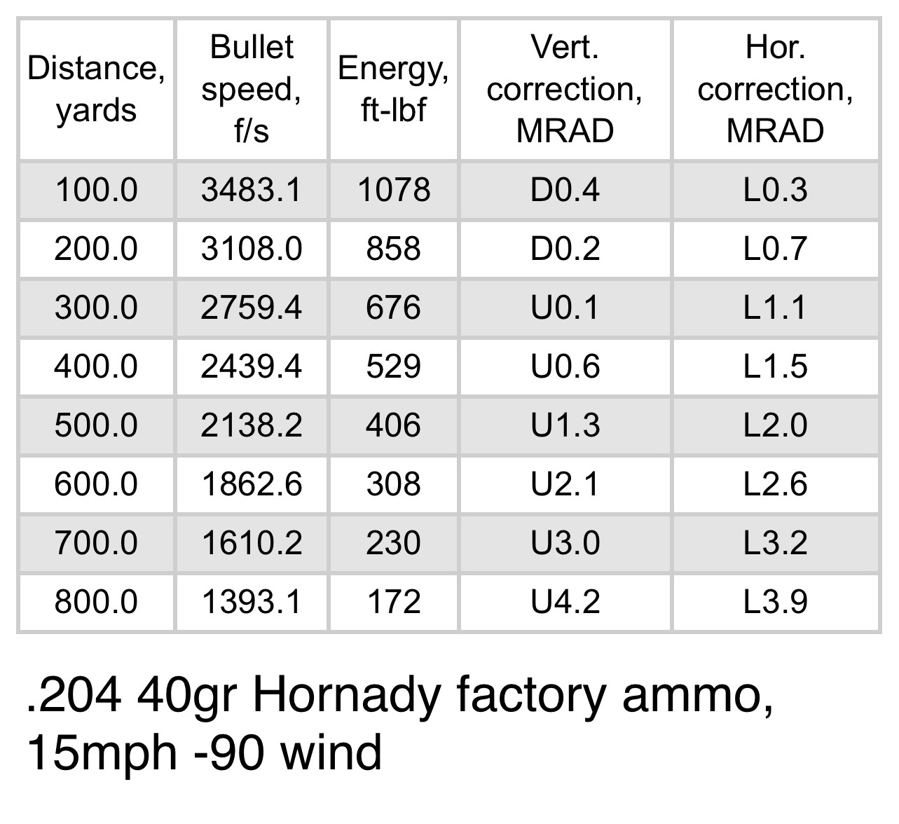

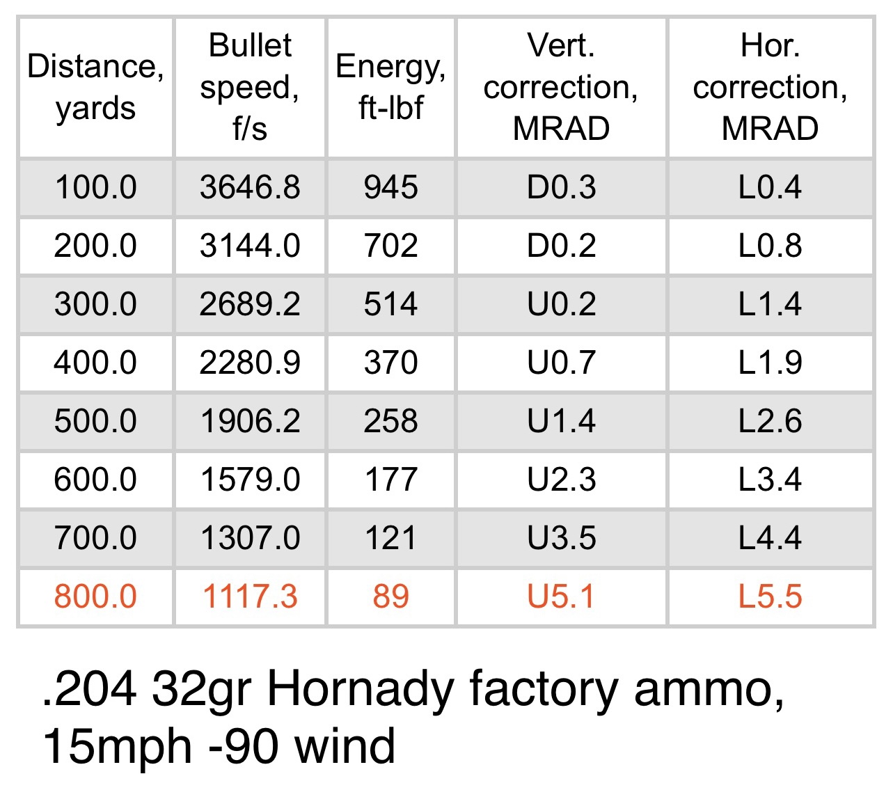

I guess I haven’t shot them side by side in the same conditions. Just running them through Strelok gives me this for factory 32gr and 40gr Hornady ammo, 15mph full value wind from left. 300yd zero (gasp!). Edit: I have spin drift enabled, which affects little bullets more than big ones, I guess. That’s why the 300yd vertical correction isn’t zero.
For wind, at 300 the two rounds are separated by 0.3mil (jumping from 0.1mil diff).
Intrigued, I re-ran the numbers and reduced the step distance from 100yds to 25yds. They were separated by 0.1mil until between 225-275yds where it jumped to 0.2mil. I’d post that as well but I’ve already derailed this discussion enough! I can PM whomever is interested.
