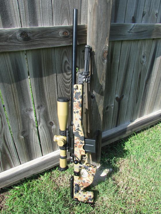

Pic of said rifle:
The MARS has a 30MOA cant to it, so I'm just looking for a 0MOA/0MIL Spuhr mount.

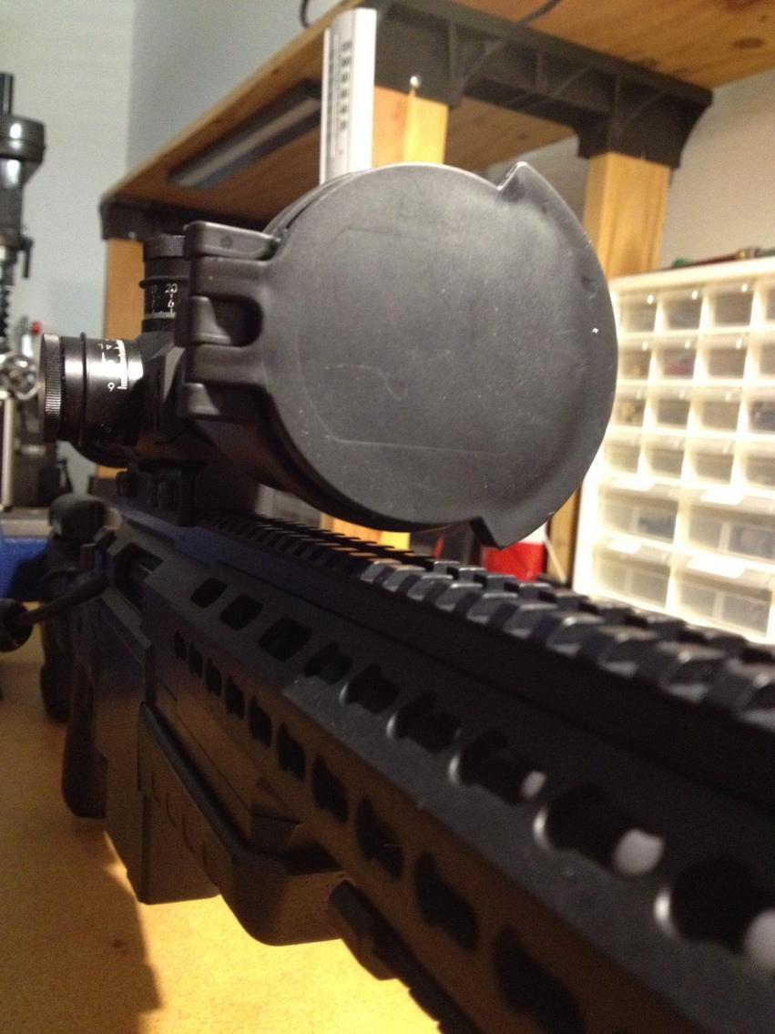

I ordered mine from midway about a year ago: Spuhr ISMS 1-Piece Scope Mount Picatinny-Style Matte
I ordered part number 574986 (height high, ring diameter 34mm, zero base elevation) which measured .495 from the top of the base to the bottom of the ring. When I tried to mount the S&B, the tube did not quite set in the front ring because the scope cap rested on the rail. I sent it back and ordered part number 685585 (extra-high) which measured .765 from top of base to bottom of ring. My scope is a 50 mm obj and with the higher mount I still need to turn the lens cap to have it fit. Kind of depends what caps you are going to use and still get the closest fit. As I don’t have a 56mm obj, I can only assume that the one I have now will fit but you might have an issue with caps. I could have kept the first one but then I would not have the ability to use caps.
Here is a pic of mine as it sits today: Update: I took a grinder to the cap tonight and took it down a mark so it will sit straight instead of off to the side as in the pic..
