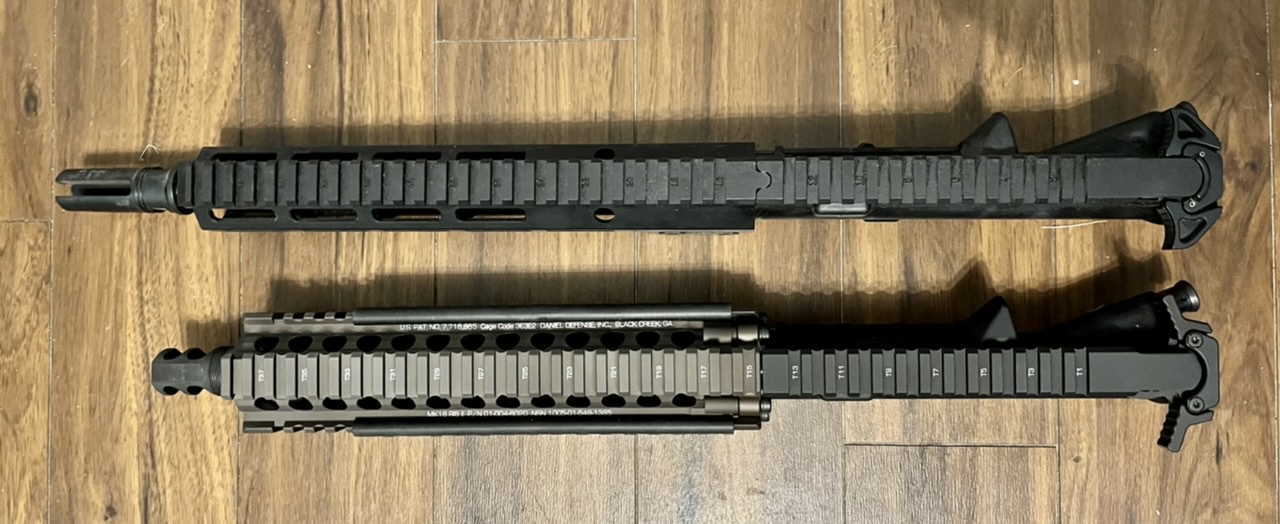

    I'm in a conundrum - through a series of fortunate events, I've been able to get ahold of two really nice short barrel uppers - a Daniel Defense Mk18 upper with 10.3 barrel and FDE (well DD's version of it) RIS II quad picatinny handguard as well as a Geissele Super Duty 11.5" all black with MLOK handguard.
    Some things to be aware of, will mostly be shot suppressed and will be outfitted with NV gear - Steiner OTAL-C and Luna ELIR-3.
    I am leaning toward the DD Mk18 but I am not a huge fan of quad rail handguards though it does make it convenient for mounting accessories.
    For those with experience give me your pros and cons between the two. I don't think I can go wrong with either but thoughts would be appreciated as I may not be thinking of something fairly obvious to others....

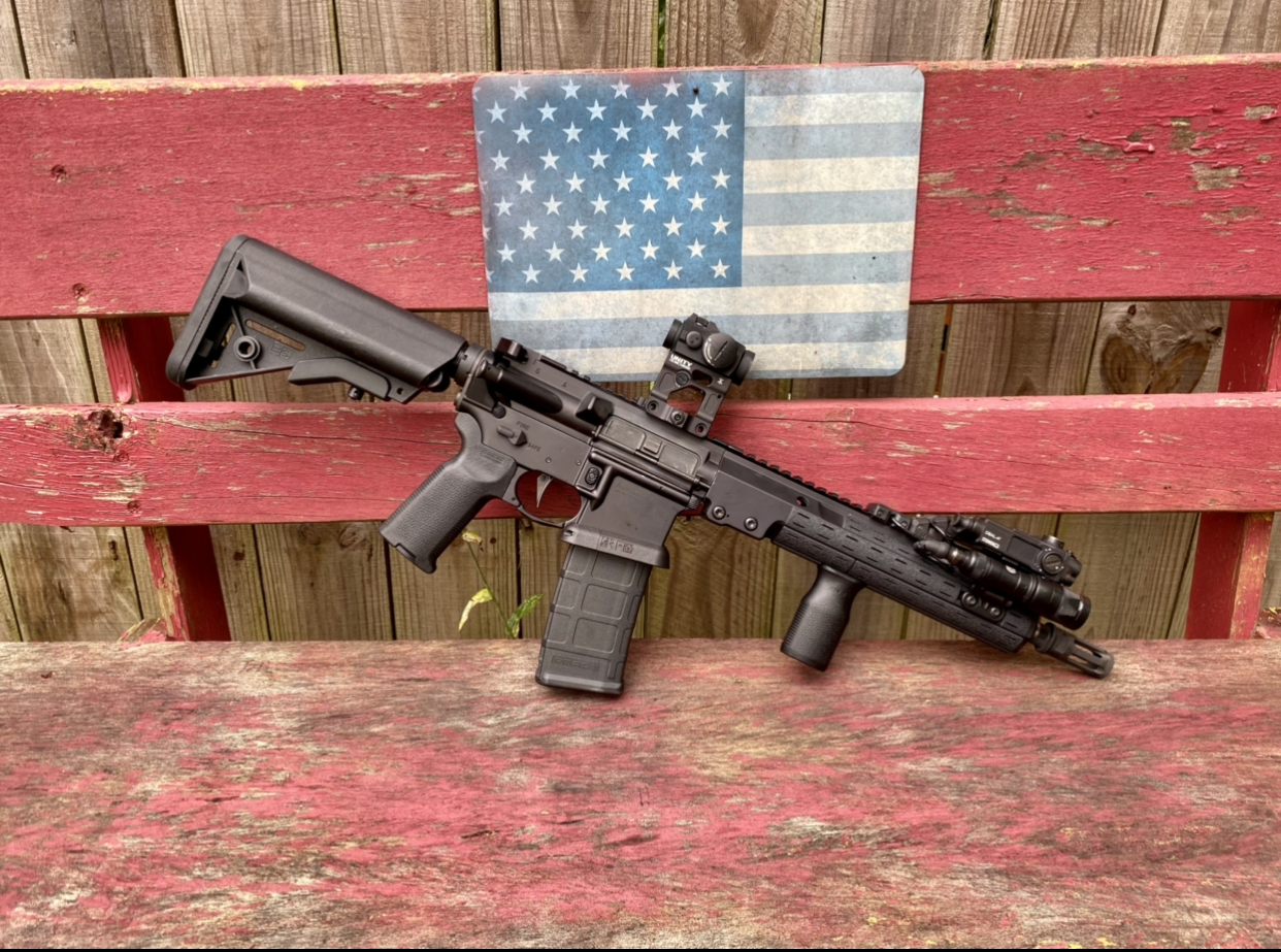

    Personally, I have shot my 10.5 MRP suppressed for years and its been great, but it has sort of been replaced by my 12/12.5 setups as i sort of feel they just offer better velocity, better flash reduction, milder recoil impulse, and when paired with a law folder, are a super compact package.
    Just as I think its really hard to beat a good 12.5 set up in 556 for shootability, I think its really hard to beat a good 300BLK when going short, or doing stuff at night.
    Here is one of my 12 inch set ups that replaced my 10.5

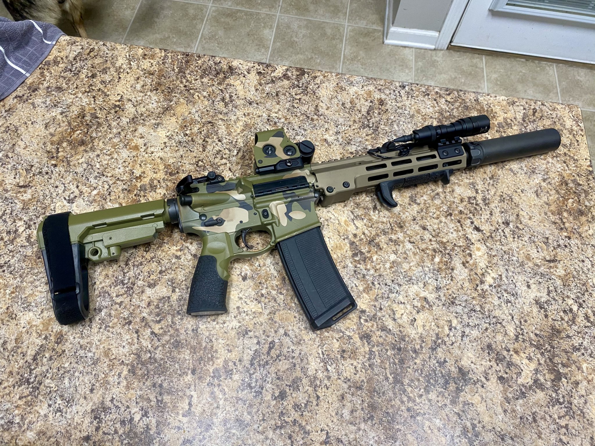

    I do already own both of these, the picture from the original post is one I took of that two I have in hand.
