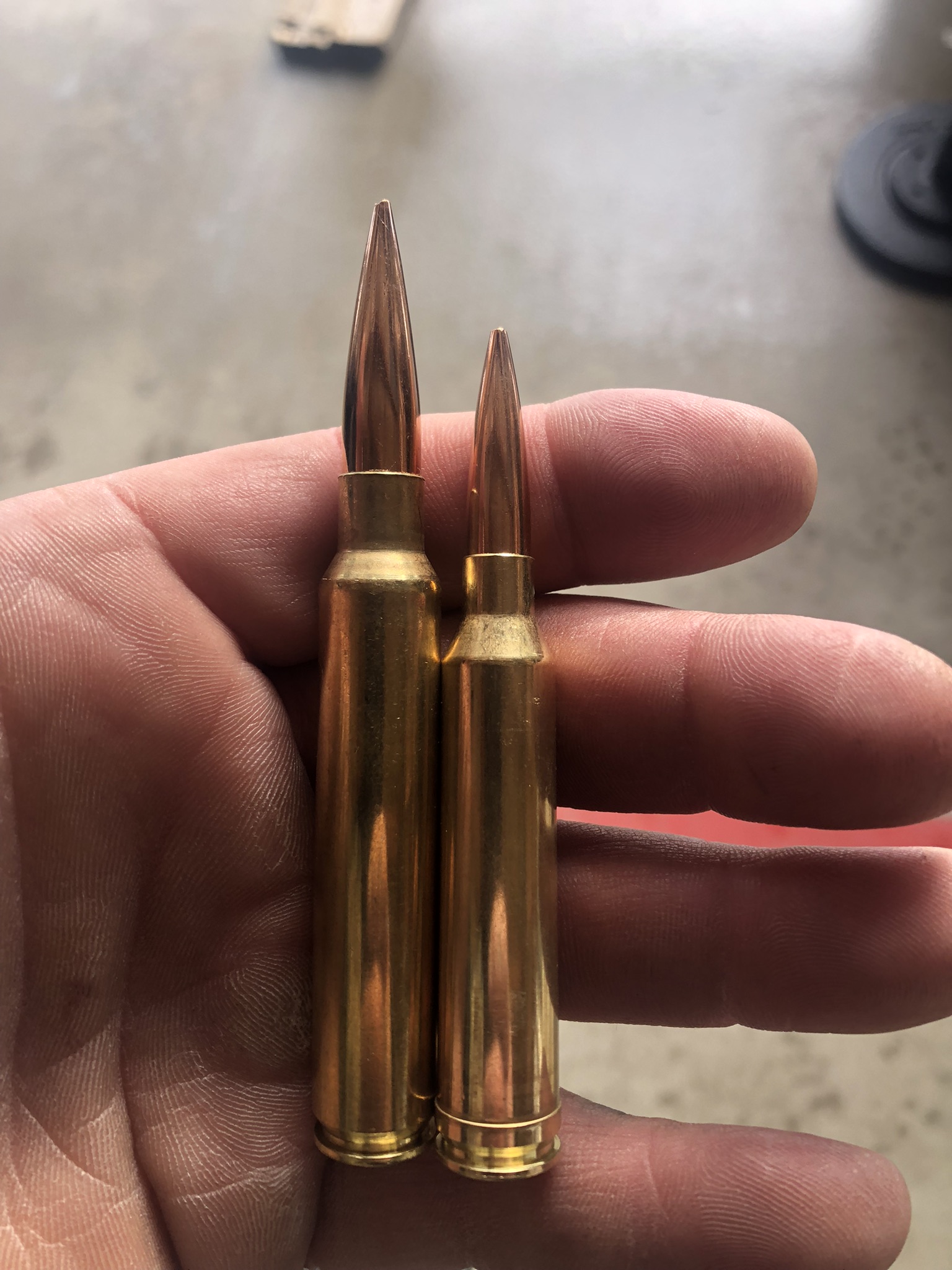

You could check out a Shaun Carlocks 338 Edge. 300 Ultra Mag necked up to 338. 28-30” barrel ( some guys run a 32”) running H1K and 300gn Bergers ballistically online with a 338 Lapua but built on a Standard Remington Long Action Magnum bolt face. 2000yard gun all day. If you have Defensive Edge build it he can put his +P chamber on it too and get you another 100-150 fps out of it. He did that to my 7RM.
Gonna save you money on powder, brass, action etc. head stamped brass, dies are available and have the ability to neck up 300 Ultra Mag Brass if need be. Plenty of that running around too.
If you’re stuck on that Lapua BF, look at his Terminator line of cartridges.
Being on a LA gives you a lot of options. Can run on R700 LA or whatever action you prefer.
Personally I’d rather build a full custom on an Impact / Lone Peak / Defiance etc. whatever Chasis / Stock fits the bill, premium barrel / trigger / brake and a ZCO 8-40. Think you’d be more than happy with that setup.
Can do Prefits as well so pretty quick to swap barrels with an actions wrench / vise.
Check out Defensive Edge. Thatll Be my next build.
Below pic is a 3338 Edge with 300 gn Berger next to my 7RM with 180 gn Berger
Reactions: BigBC
