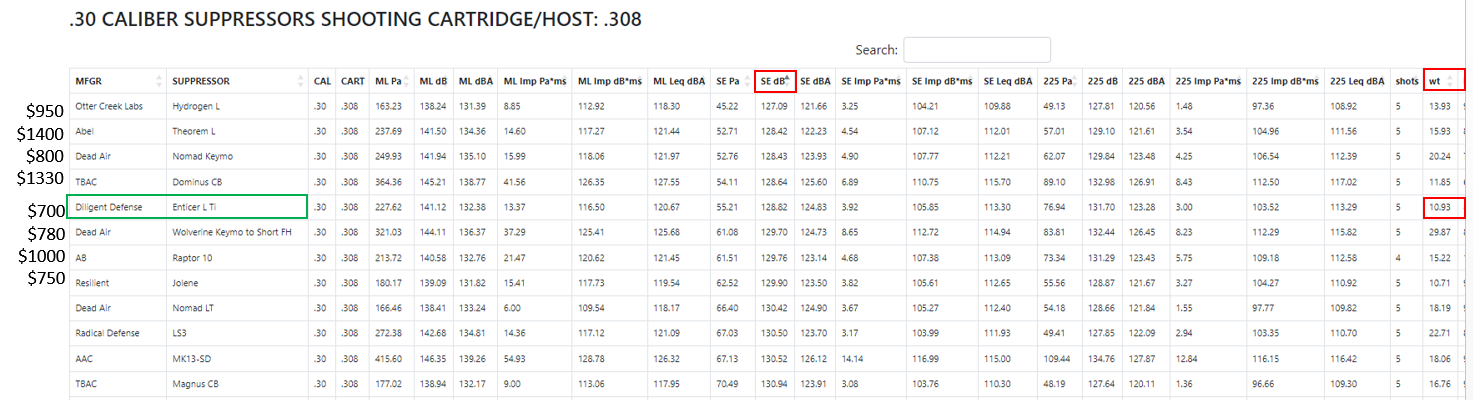

I bought my 5th suppressor in December. Cost was #1 factor closely followed by weight and suppression level. I wanted up to .30 cal, direct thread and removable end caps. Length and diameter was NOT critical to me.
I used TB's Summit test and sorted .30 cal cans shooting .308 from quietest to loudest sorted by SE DB which is Shooter's Ear db ratings. It lead me to Diligent Defense's Enticer LTi. https://thunderbeastarms.com/sound/summit2023/
