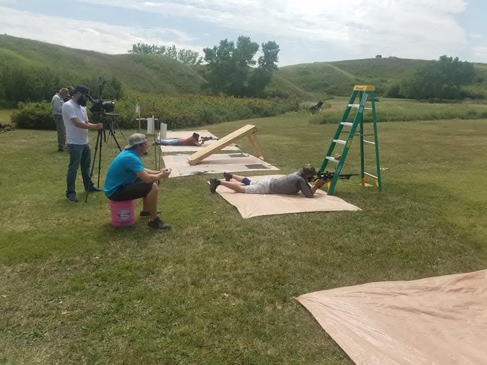

Imagine the Friday of most two day matches…all the props are there, there are targets to shoot at from all of them…it’s a range….so basic range rules apply as if each of the props was a bench on the firing line.

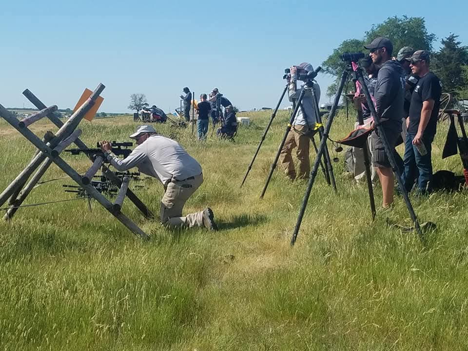

I would also suggest being careful about picking props that will be less prone to causing safety problems. Tank traps, for example, lend themselves to problems for new shooters. A new shooter is less likely to let their gun slide off a barricade then they are likely to let it drop off the tip of a tank trap.

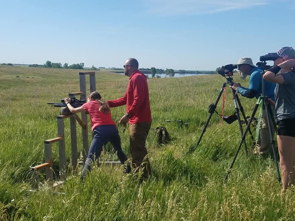

I would absolutely try to get a volunteer who has some match experience at each prop. The best train up days I have seen have people cycling through props as if it was a match but with a volunteer “instructor” at each prop giving tips and feedback. If that’s not feasible, try to group anyone who has no match experience together and have a volunteer work with them for both safety and so they developed good habits.
