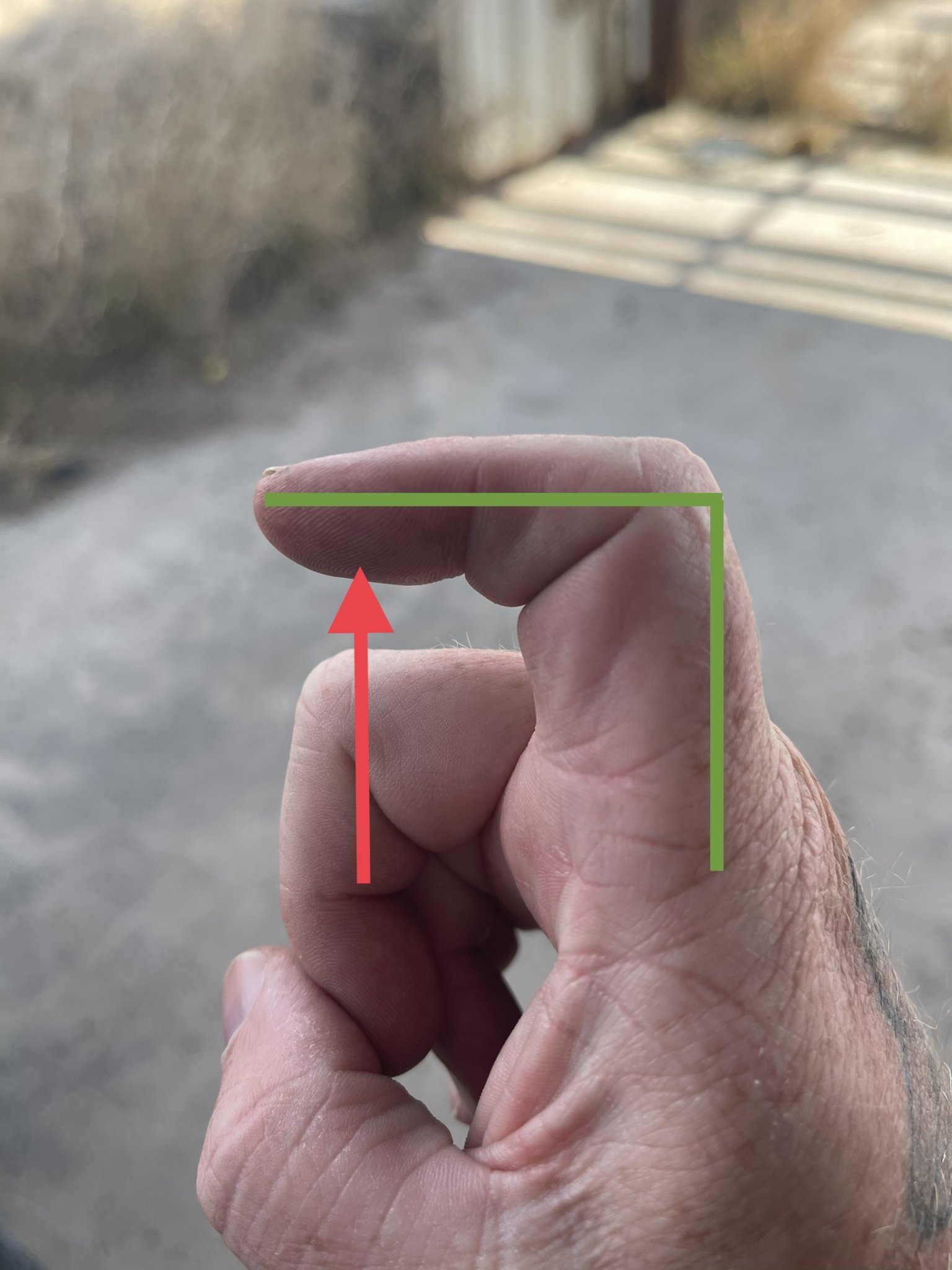

    This is why a 90deg trigger finger is much more efficient than a jointed pull. It’s almost impossible not to press straight back when you make a 90deg.
    Yeah, and I really, really try to do this. Now, just to confirm...we are talking about bending at the second joint of the trigger finger and making movement from that joint.....right? This what I attempt to do on a consistent basis but I do fall short.
    But even so, with my smallish hands/fingers, I have found that I still need to be careful of where on the finger pad I place the on the trigger shoe. I find if not in pretty much the middle of my last finger pad, then I do push/pull the gun just a tiny bit and I'm really working on eliminating that altogether.

    Red arrow is part of pad that goes on trigger.
    With practice you can do it on any stock regardless of how close the grip is. Even if you have to get up on your fingertips. The trigger press is much more important than the “grip.”

    Thank you...and yes, this is exactly what I'm attempting to do, both how to bend my finger and where to place on the finger pad.
    And indeed I do need to use a bit of finger tips of the trigger hand on the grip....less with the chassis gun than the HS stocked gun...to be able to get that 90 degree and middle of the finger pad. If I slip back a bit on the grip and don't notice, then I'm not completely at 90 degrees and I slip toward the tip of my finger and pull the shot just a bit. Not a lot. Got rid of that, but still there is room for improvement (yes, I'm an OCD perfectionist LOL)
