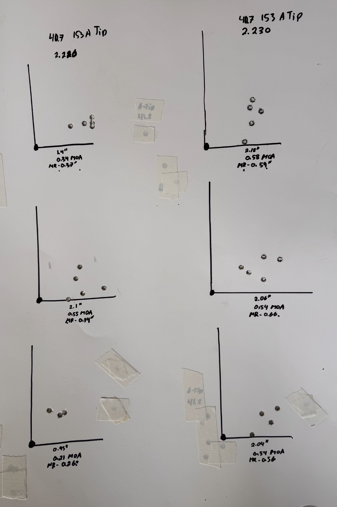

Okay so I am stumped. I have 6.5 Creed with Hornady A-Tips (153) and was shooting amazing.. 0.4-0.6 MOA consistent. Virgin Brass which i FL Resized and loaded with 40.7 H4350 @ 2680 FPS
Now working up load on Fire formed, I ran a few groups and they shot well and decided at 40.3 H4350 to match velocity. Now I did a batch of resizing and I over bumped. Was aiming for 0.002 but ended up form 0.002 to 0.005... I realized it was a lube issue..
So here is the problem.. I decided to bump the 0.002 group to 0.004 so I would have 0.004-0.005 (Still longer then Virgin at 0.006)
I retracted the decaping pin in the FL Hornady Die just above the primers and re-bumped and all went smooth with proper amount of lube, etc.. Cleaned Die, all good...
**** I m thinking above is the issue***** Maybe touched primers, maybe resizing twice is bad...
Go to the range and I am spraying 2-3 MOA everywhere.. Up down, left right.. WTF but Velocity is ES-17 and SD of 6 (15 shots) So stable velocity and a few FPS less ES and SD then Virgin Brass.
Shoot some rounds my friend gave me to try just to see if it's the rifle / scope or something and they shoot 0.45 MOA 5 shot group @ 330 Yards. Same velocity @ 2670
So what did I do wrong. I am stumped and depressed.. LOL
I am doing a match tommorow but have enough Virgin brass already loaded. So not an issue there..
So I am thinking once I fire that I resize that and compare with some of my other stuff that wan't resized twice.
Also resize the brass that just shot like crap properly and try that with above as this will be now twice fired.
Really stumped..
