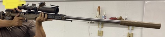

I've always ran a Dominus or Ultra 7 on my 7 rem mag. After developing/shooting the Magnus I doubt I'll every put anything but that on my 7 mag. Sound suppression is one thing, the recoil mitigation of the Magnus is phenominal on my 7 mag.
It's so long tho. Do you back country hunt with it?
Yes, I run shorter barrels on my hunting rifles. My 7 mag is 22". Everyone, including myselft at times counts ounces way to much. The Magnus CB weighs 14.8oz, the Dominus CB weighs 9.6oz. IMHO those 5 oz are worth it just because of the reduced recoil. Being able to spot impact on the animal is definitely worth it. As far as length, I really don't notice a difference but I'm also not busting thick timber. I have way better luck running ridges high and finding something below.

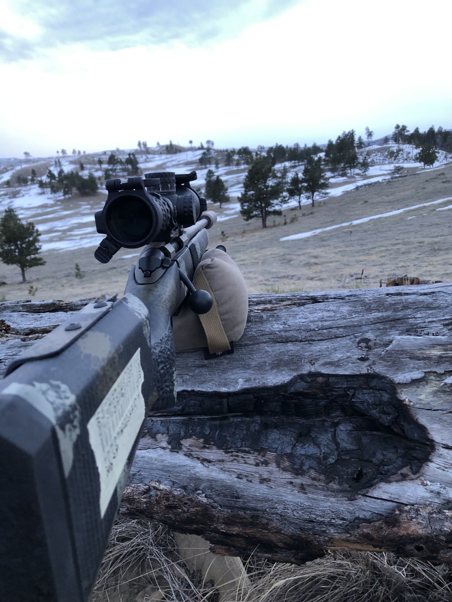

I ended up going with the ultra 7. I don't think you can go wrong with either. I did just get it out of jail and I'm happy with it. It's not movie quiet on my 7 saum but it has a better tone than my sico Omega 300 and is way lighter. I think the 7 saum is quieter iirc in their YouTube tests but you're ears won't notice that.
What kind of attachment methods did you go with considering weight and length? Was the weight differences the reason why you went with the 7 instead of the dominus?
Weight pretty much. I just thread on. Didn't want to have to buy a ton of their muzzle devices. I have a can like the dominus already same length and dimension but heavy so I wanted someone a little different that is light.
